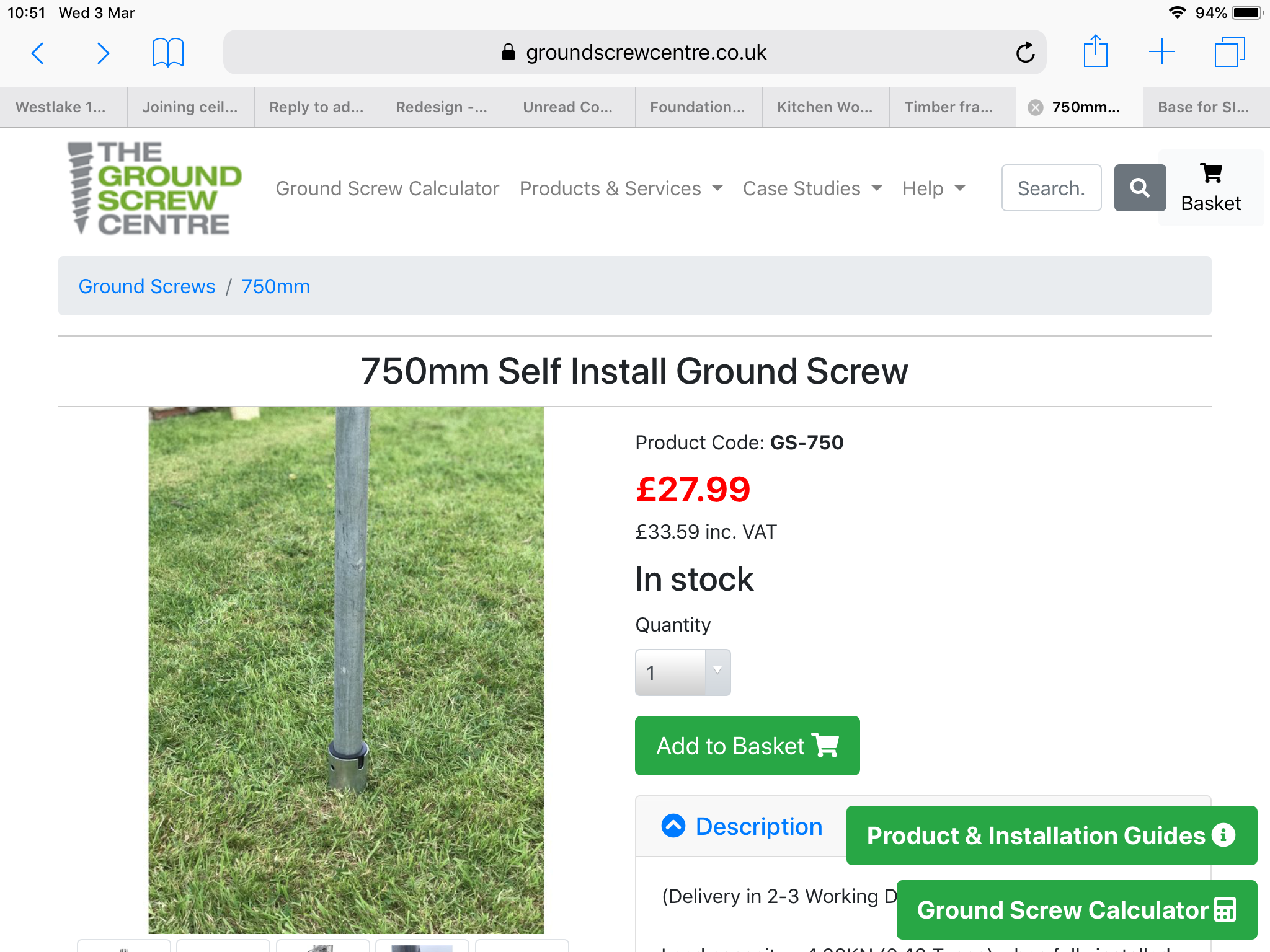

I would use ground screws as it involves vo digging and no concrete, just find them cheaper.
Just done a quick google
your ground screws will cost you £350.
If you put them at 1200 centres.
Edited by Russell griffiths
Got a link?
