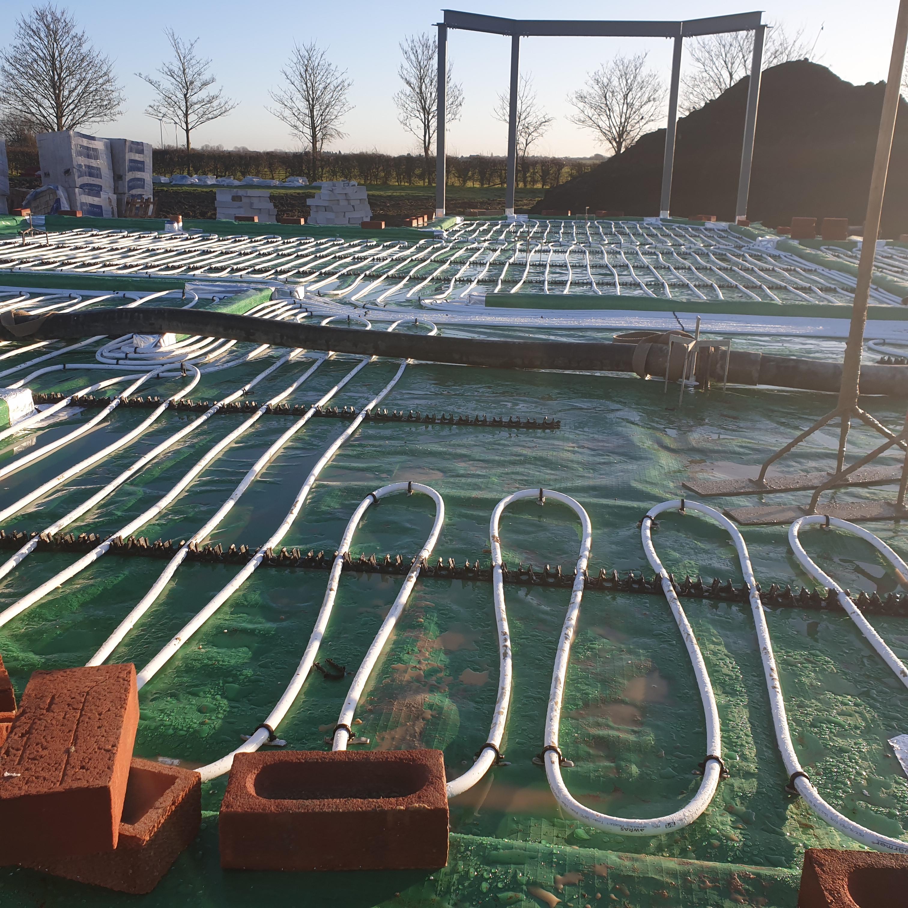

Rearranging the loops to avoid the 250 mm gap will be fine - it won't result in a cold spot as the concrete slab will conduct the heat across it.  Kingspan Optim R is the best floor insulation with the least thickness but I am not sure you can get it in really small widths (and you can't cut it as it is vacuum sealed).
Thanks @Faz . So coincidentally, the two heating zones for that floor almost fall exactly either side of the beam that is too high up. So maybe we just give up on having heating on that strip. I still think there will be some cold patches there though.
Edited by Adsibob
This is the ufh loop going into my house late last year - like I say - 250mm isn't worth worrying about mate.
