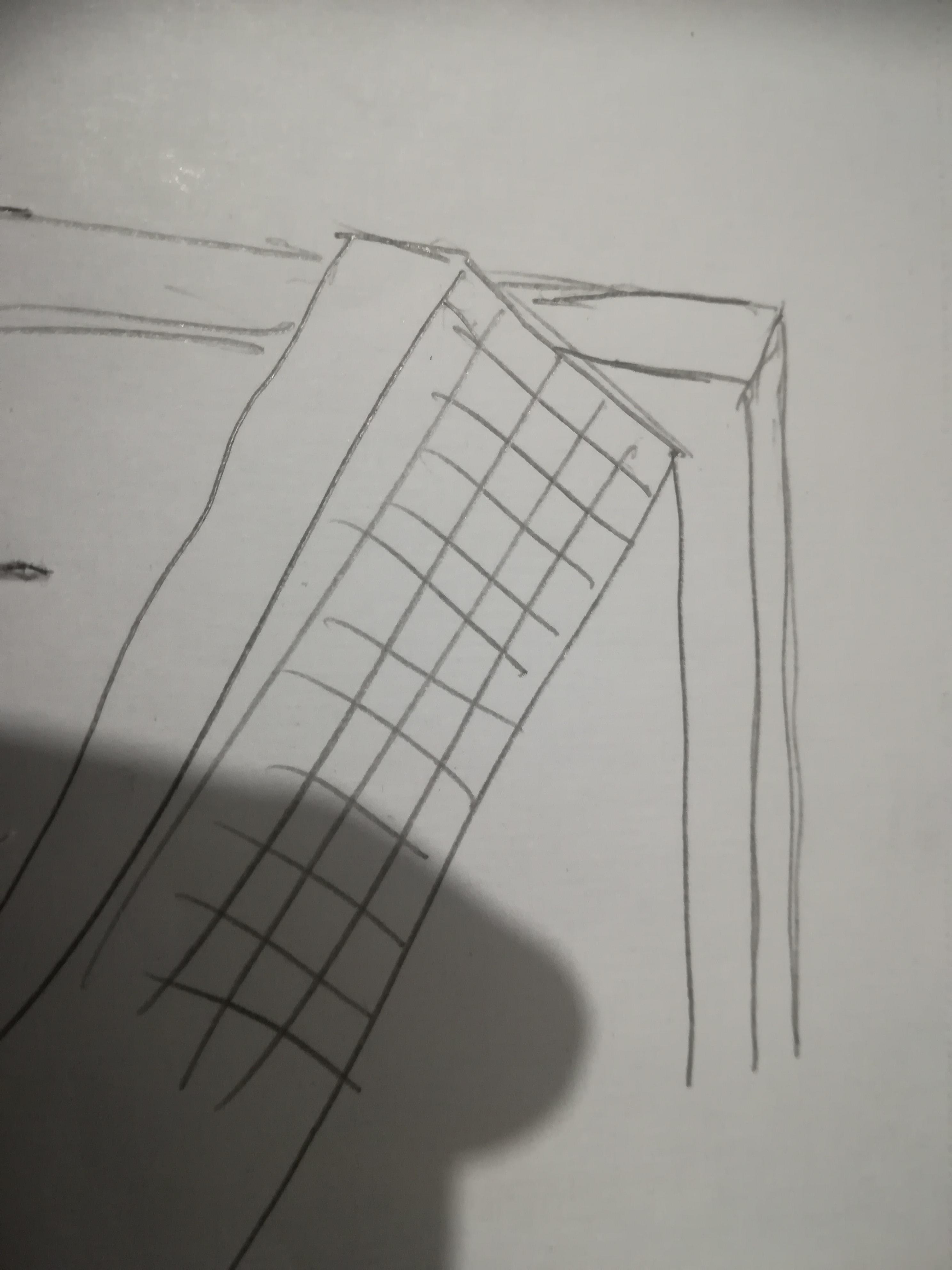

Big Jimbo Posted February 25, 2021 Share Posted February 25, 2021 You could do as my drawing. Parapet wall either side. Nice hight flat roof, and drop to required height for eaves. You will have to twist my image, cause I am crap on phones and computers Link to comment Share on other sites More sharing options...
