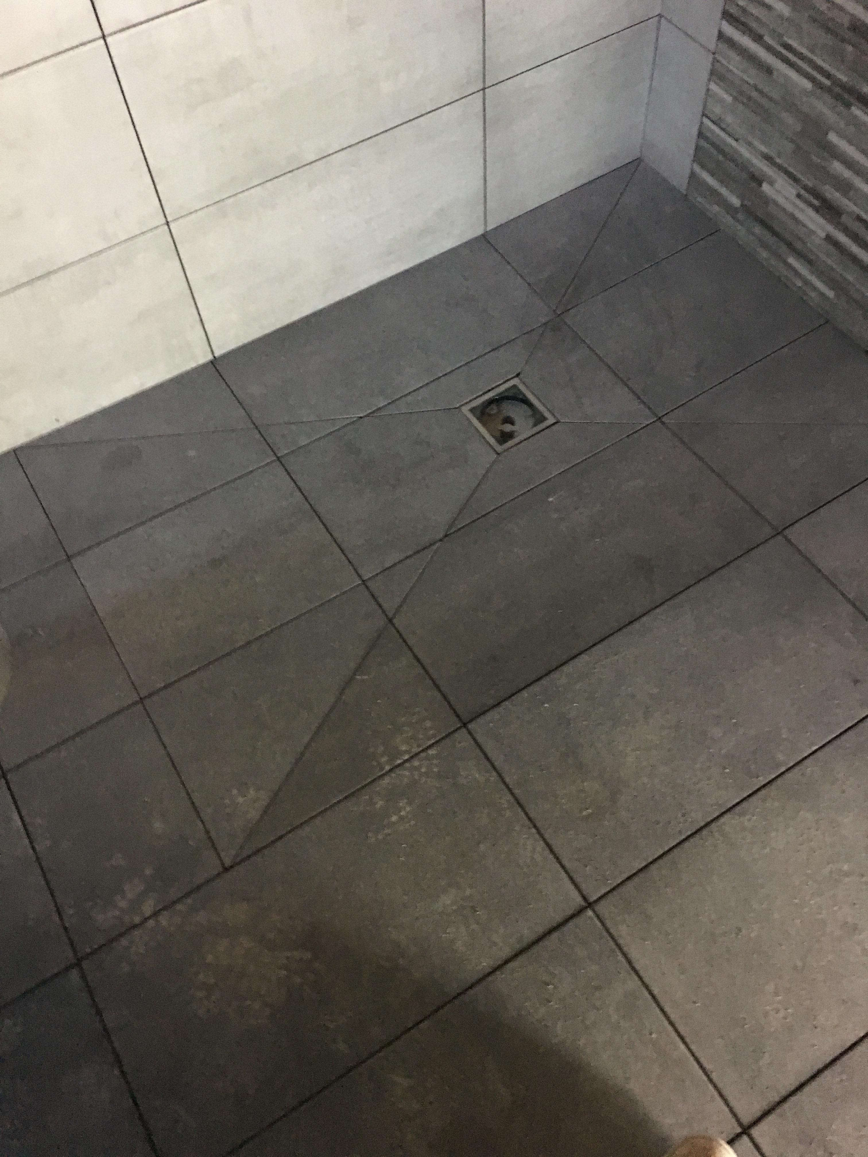

Onoff Posted February 22, 2021 Posted February 22, 2021 My Geberit wall drain said 1 - 2%. With my wet room corner that equated to I think 14 - 28mm. I ended up at about 20mm so circa 1.5% and it drains a treat. I was worried that you would feel the slope when you walked across it. You don't. With hindsight I'd have gone 2%. 1
