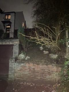

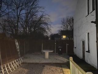

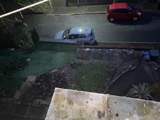

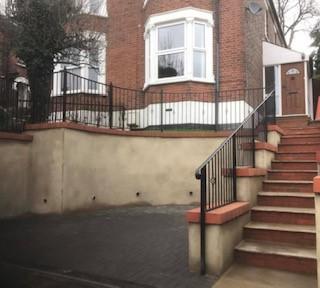

I've attached a couple of pictures to help anyone who wants to understand the problem. I have listed some more information that may be helpful below. Photo 1 is taken from the road outside the house. Photo 2 is taken from the window above the front door to give another angle. Photo 3 is taken from the garden which shows the space to the side of the house. Photo 4 is a potential solution:

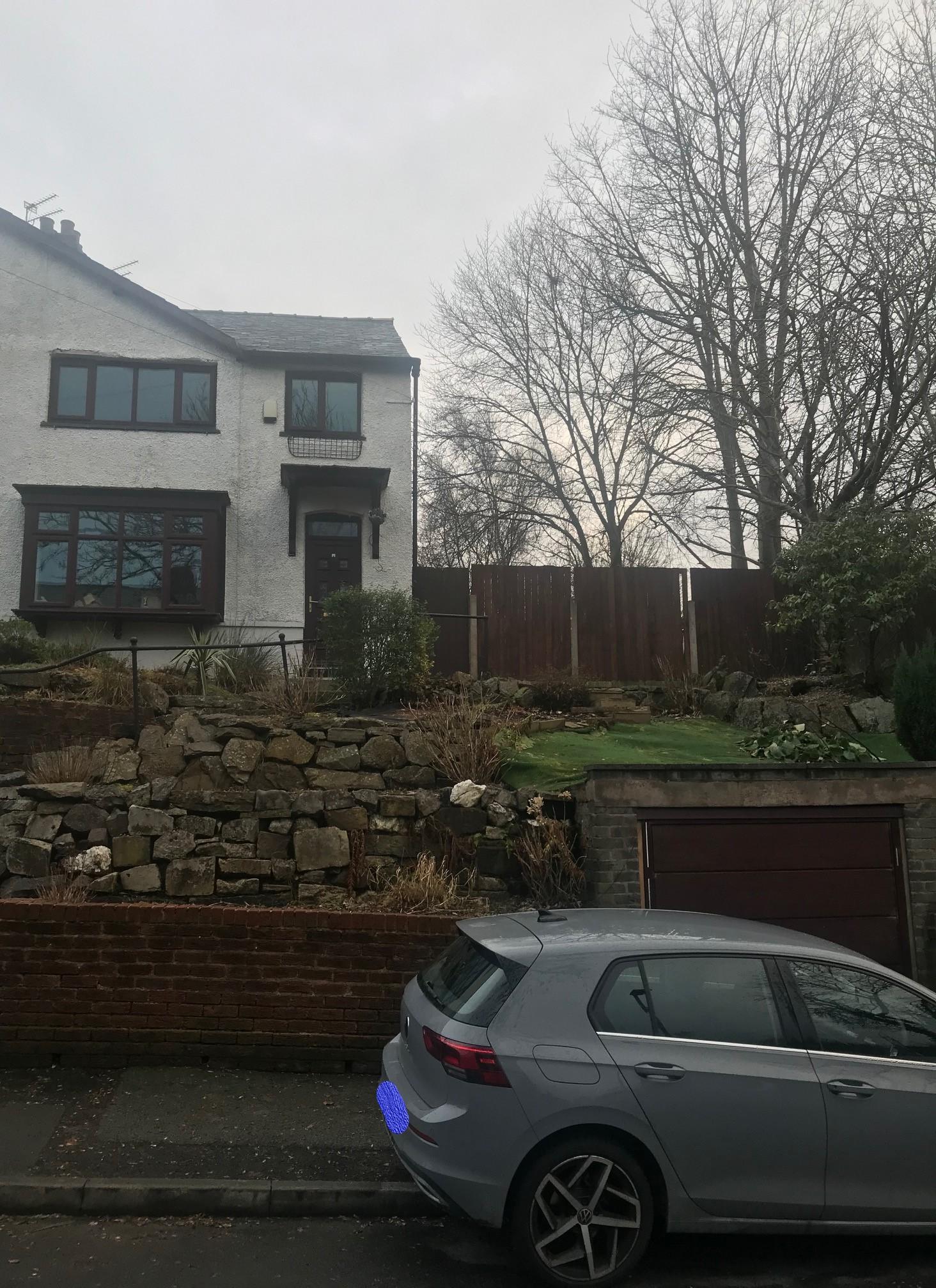

- The picture probably doesn't quite show how high the house is. Its roughly 8.4m from the fence on the right hand side of the house to the back of the pavement. Its roughly 3.4m down from the front door to the bottom of the steps in height.
- In case it is unclear, there is a garage behind the parked car - we own this garage. It is falling down and not structurally sound. We were planning on knocking this down.
-We own all the land to the right of the house, up until the treeline you can see. On the other side of the tree's are railway lines which according to the research we have done and our architect are far enough away to not be an issue. The railway line is to the right of the fence on Photo 3.

- Our initial plans were to have a driveway running from where the garage is now (there's a dipped curb in-front of it) along the side of the house that runs far enough for the drive to be at a steepness that is practical. We've been told this wouldn't be a good idea as the driveway may end up running quite close to the foundations of the house.
- If the above is indeed impossible then we would consider something similar to the third picture attached. Although I understand we are a lot higher!

You need professional input to avoid you doing anything that resultsin the house sliding down into a big hole.
Can you not repair the garage and use that, it will be by far your simplest form of off road parking.  If it has been built properly it will have been built into the hillside with retaining walls.
What is to the right of your garage?  is it right on the boundary or is there scope to widen it by rebuilding the retaining wall further to the right?

@ProDave please find the answer to your question re right hand side of garage attached.
Not a single person we know has suggested widening the garage. I'd written the garage off due to it being too small and not structurally sound. We should probably re-consider who we associate with! Thank you @ProDave - I'm already glad I posted. Our preference is still to have a driveway but you and @TonyT make good points re the risks of the house sliding... not a pretty thought! If we had a wider garage it could solve the problem. Along this line of thinking - would it be possible to widen both ways and put in new retaining walls? I'm not sure at all what was meant by the garage not being structurally sound when we were told and whether there are retaining walls that are fit for purpose around it. It's something I now know to look in to.
