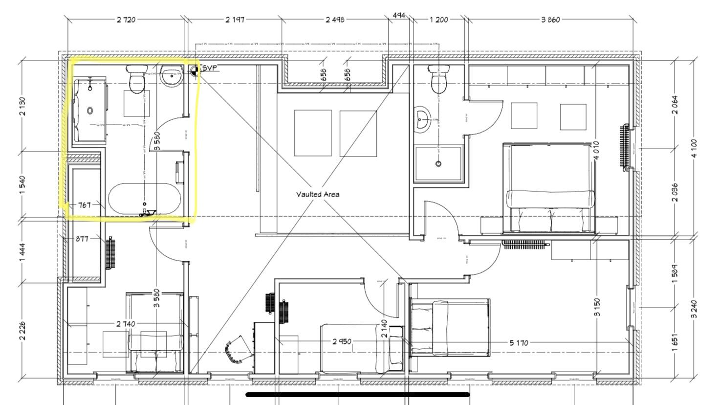

Laurence737 Posted January 29, 2021 Share Posted January 29, 2021 Hi Everyone, Having a bit of a head scratch moment and wondered if anyone could shed any light as to wether my plans to move our bathroom upstairs would comply with regs, particularly part B. The room is directly above the existing bathroom that has a door leading out to the main gallery landing to the staircase which leads to the open plan kitchen/dining/living space and has a small skylight fitted at 1.7m sill height. would this room comply with regs? Thanks Link to comment Share on other sites More sharing options...
DevilDamo Posted January 29, 2021 Share Posted January 29, 2021 In what way are you concerned in not being able to comply with ADB? Link to comment Share on other sites More sharing options...
Laurence737 Posted January 29, 2021 Author Share Posted January 29, 2021 3 minutes ago, DevilDamo said: In what way are you concerned in not being able to comply with ADB? It was this part Escape from upper storeys a maximum of 4.5m above ground level 2.2 See Diagram 2.1b. Where served by only one stair, all habitable rooms (excluding kitchens) should have either of the following. a. An emergency escape window or external door, as described in paragraph 2.10. b. Direct access to a protected stairway, as described in paragraph 2.5a. 2.3 Two rooms may be served by a single window. A door between the rooms should provide access to the window without passing through the stair enclosure. Both rooms should have their own access to the internal stair. As I’m not sure the room will comply with that statement? Link to comment Share on other sites More sharing options...
PeterW Posted January 29, 2021 Share Posted January 29, 2021 18 minutes ago, Laurence737 said: 2.2 See Diagram 2.1b. Where served by only one stair, all habitable rooms (excluding kitchens) should have either of the following. Bathrooms are not included in this as they are not habitable rooms Check the definitions Habitable room A room used, or intended to be used, for people to live in (including, for the purposes of Approved Document B Volumes 1 and 2, a kitchen, but not a bathroom). 1 Link to comment Share on other sites More sharing options...
Laurence737 Posted January 29, 2021 Author Share Posted January 29, 2021 (edited) 5 minutes ago, PeterW said: Bathrooms are not included in this as they are not habitable rooms Check the definitions Habitable room A room used, or intended to be used, for people to live in (including, for the purposes of Approved Document B Volumes 1 and 2, a kitchen, but not a bathroom). Thats what I thought, I just got my head in a mix with the way it’s phrased and had a small panic ? Edited January 29, 2021 by Laurence737 Rewording Link to comment Share on other sites More sharing options...
