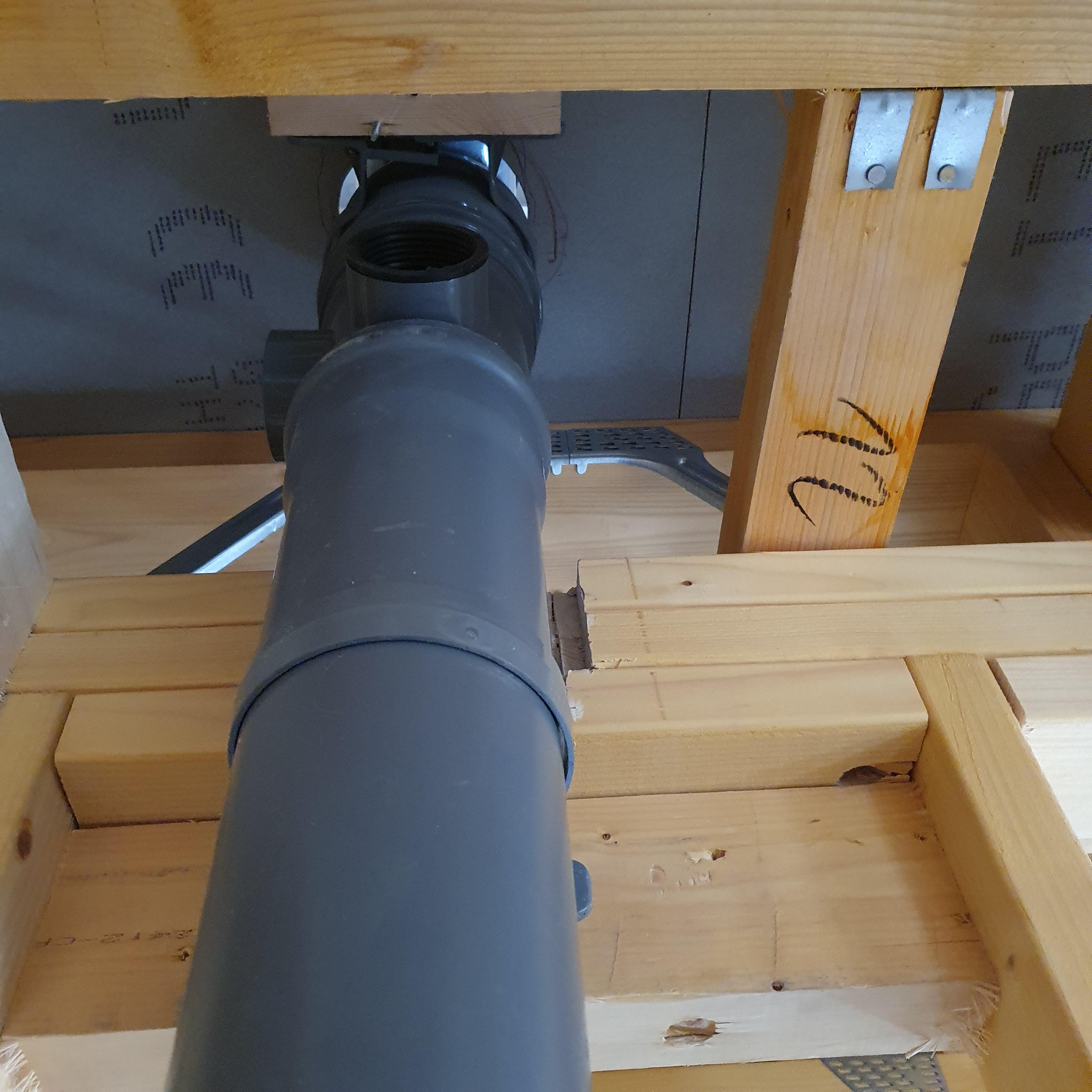

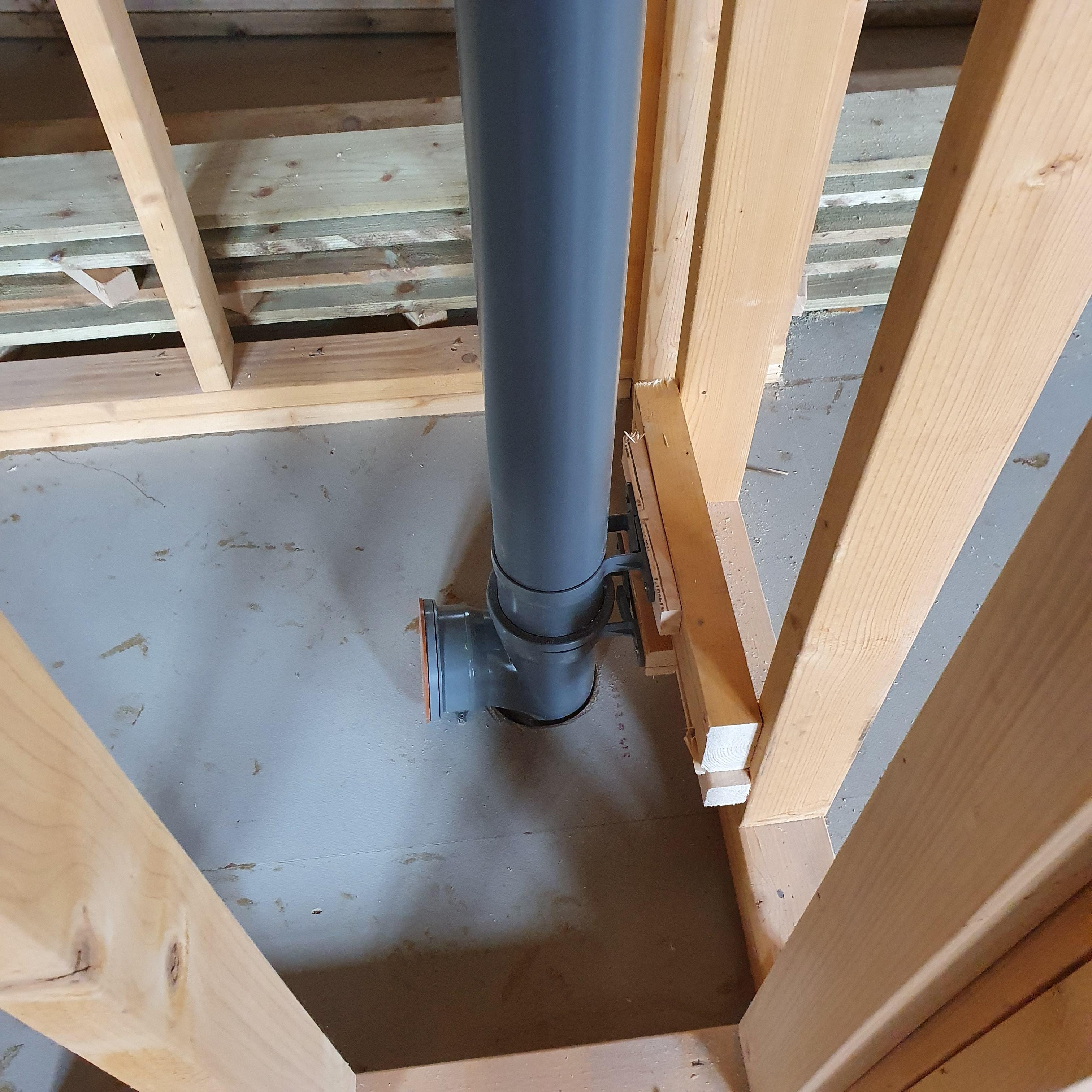

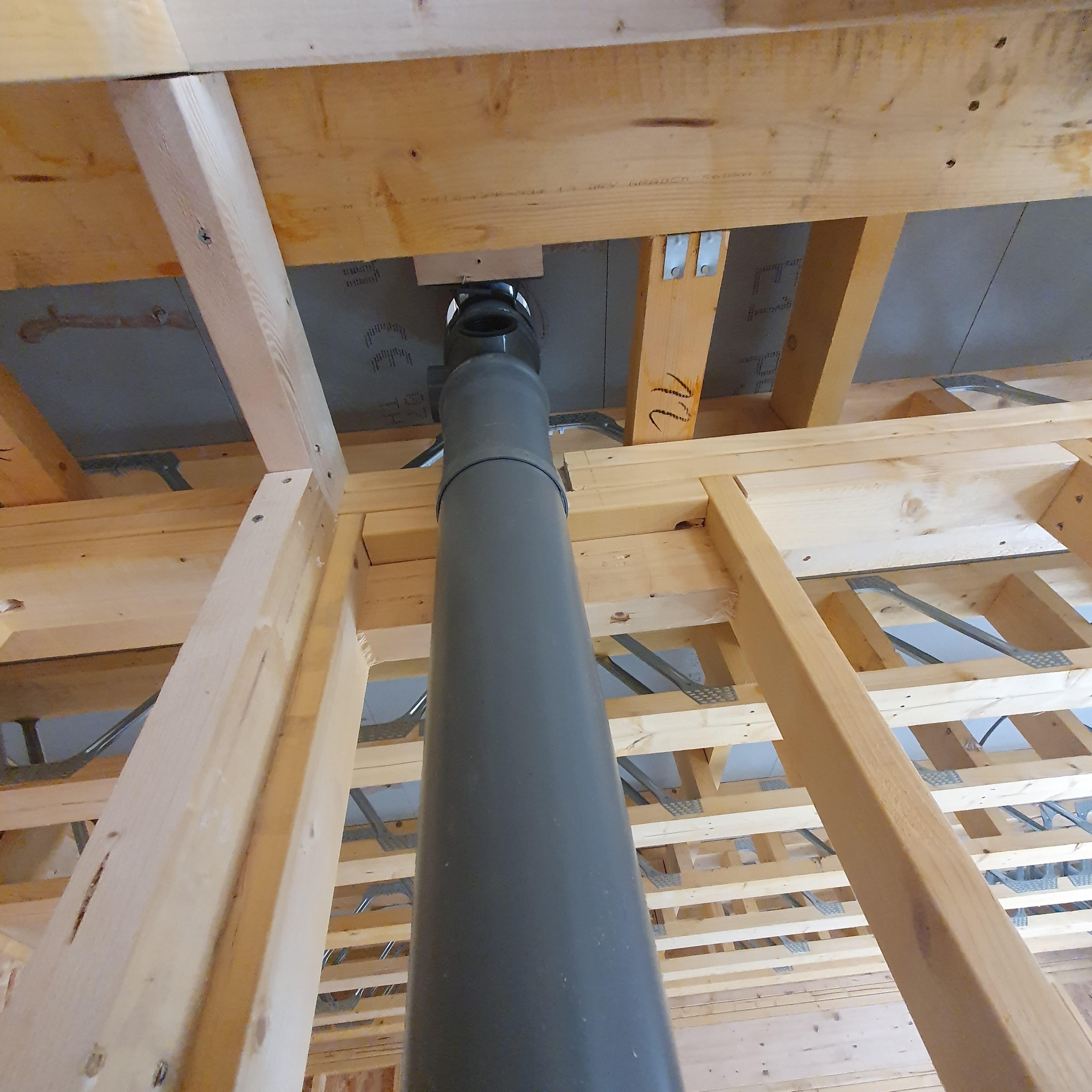

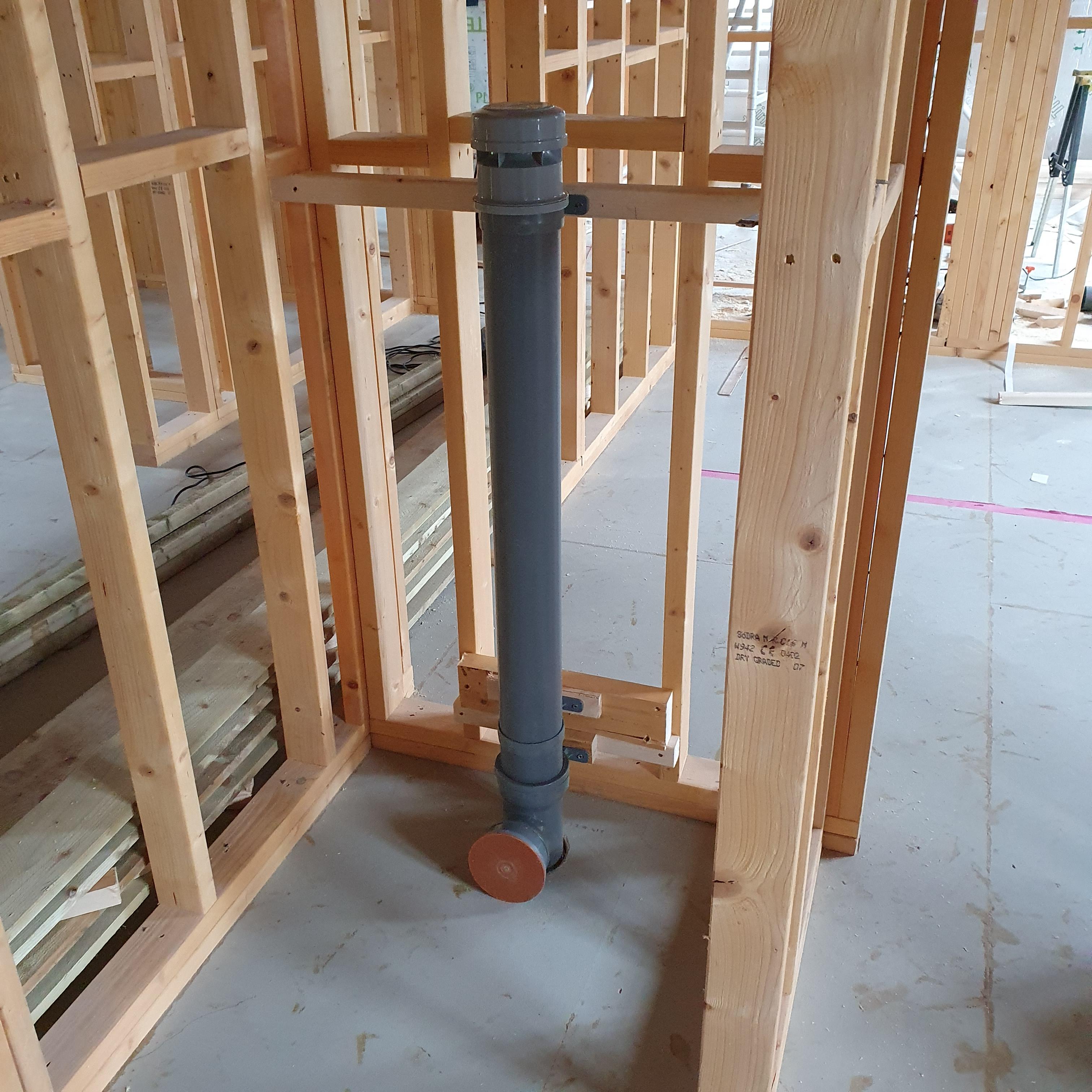

LA3222 Posted January 26, 2021 Share Posted January 26, 2021 Started to run out the internal soil stacks to where they need to be. First one, has an inlet for sink/shower waste in the ceiling void. Above that I have a 90 degree coming out which the geberit should drop down into - with the use of a 90 degree connection of some description. Both branches coming into the stack are one above other, but there is more than the required 200mm separation in line with Part H? I've capped it off with an AAV, will leave it there and see if BC says owt about accessibility, if he does ill just extend it into the loft above! Just have a 50mm pipe to run into the black grommet on the soil stack and thats the first one done. I'd appreciate it if folks could take a look and if there is something I've done wrong, let me know before I crack on with t'others! Link to comment Share on other sites More sharing options...
Temp Posted January 26, 2021 Share Posted January 26, 2021 Looks ok to me. If you are using the Geberit frames they come with a 90 degree pipe that can be rotated down or sideways. You will need a 90 degree bend to go into what you have. Link to comment Share on other sites More sharing options...
Mr Punter Posted January 26, 2021 Share Posted January 26, 2021 You will need an access panel to the AAV. It is worth getting a Geberit frame on site so you know how it will all connect. We had some Grohe ones and the connections to the soil were not standard 110mm. Link to comment Share on other sites More sharing options...
