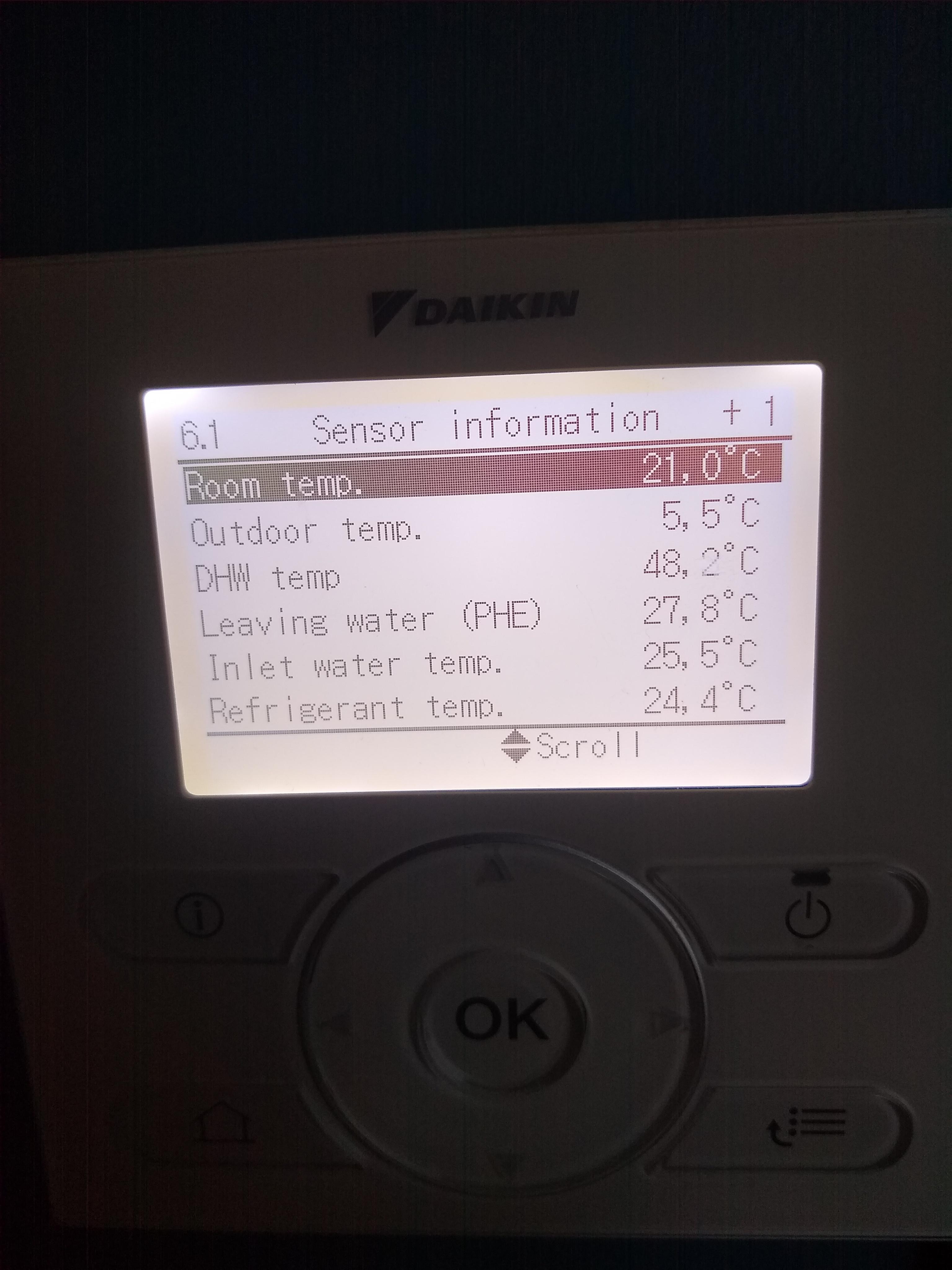

At this time of year my monobloc struggles to heat my house. The temperatures here in Orkney are actually mild compared with the rest of the UK so ambient temperature should not be the issue.

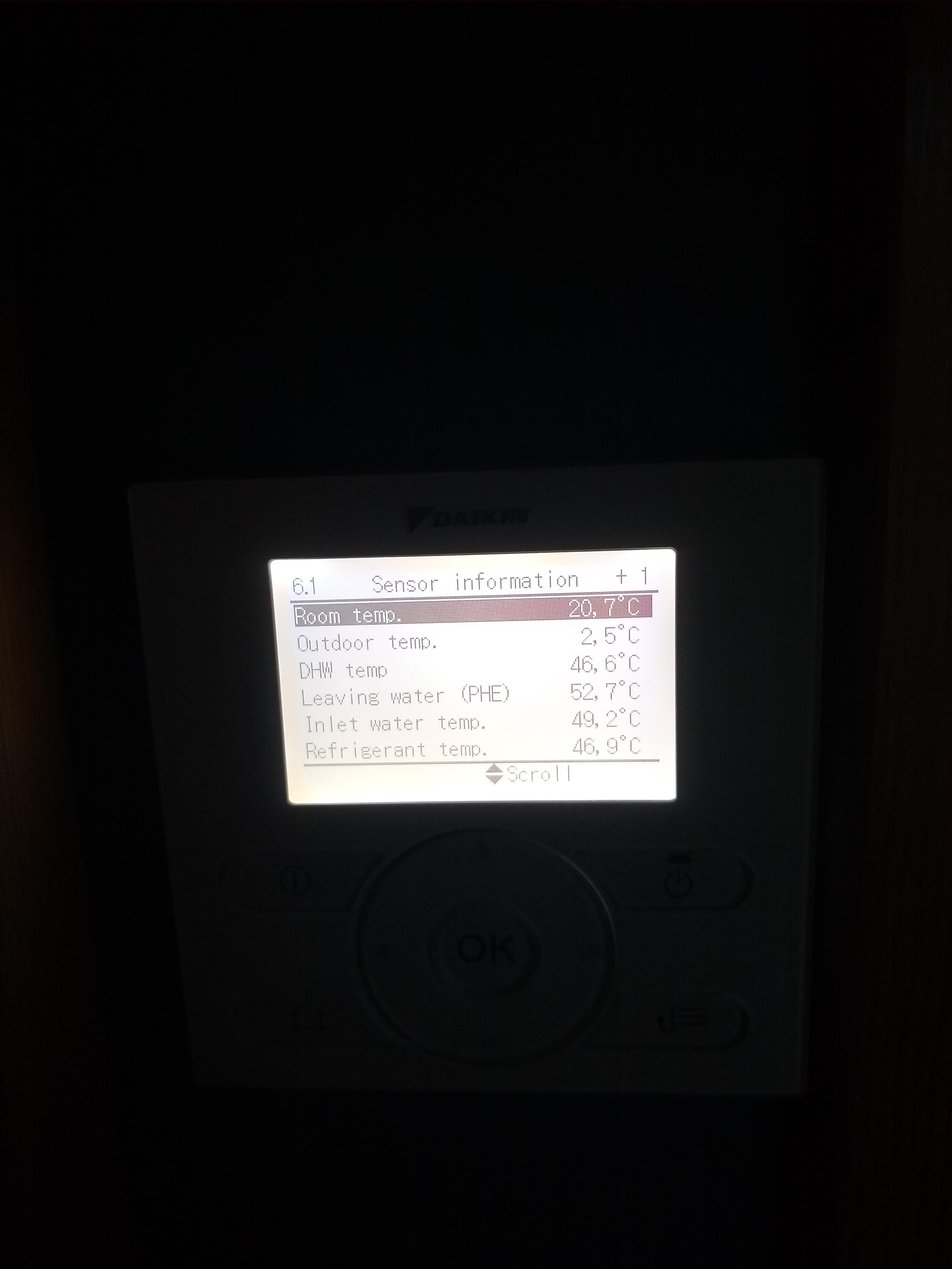

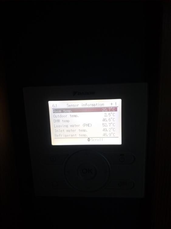

The first screenshot shows the sensor readings when the system is producing hot water to 48 degrees. As you can see the PHE temp is good.
Now the second screenshot shows the temperature sensors when the system is producing heating, as you can see the PHE temperature is really low and the pipework is cool to the touch. Due to these low temperatures circulating around the pipework I think this is why my rooms are not heating up. In the summer it is better. Does anyone know why the PHE temperature is so low when heating is requested?

There are usually separate settings to set the water temperature for DHW and heating mode separately.
Running the heating temperature at the lowest temperature it will work at will give the greatest efficiency for a number of reasons.  If it is heating the house okay at this temperature then leave it alone, but if it struggles then find the setting and increase it a bit.
Most units also have an option of weather compensation so will automatically increase the heating temperature as the outside air gets colder.
Do you have the manual and do you understand how to change system parameters?

Been doing what you suggested, it appears that if I only try and heat 4 rooms my system can maintain about 35 degree LWT, this drops to mid 20's if any more zone valves open, flow rate is about 23l/min. Is this normal? Would have thought that the system would have the capacity to supply the higher heat to all rooms.
That does indeed seem to suggest in this cold spell you ASHP can't keep up with demand.  Not a lot you can do, at least not a lot that is cheap.
