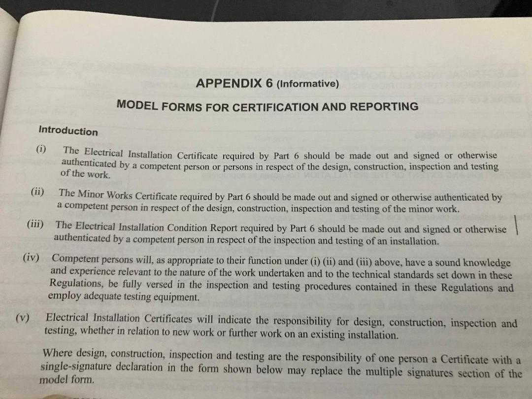

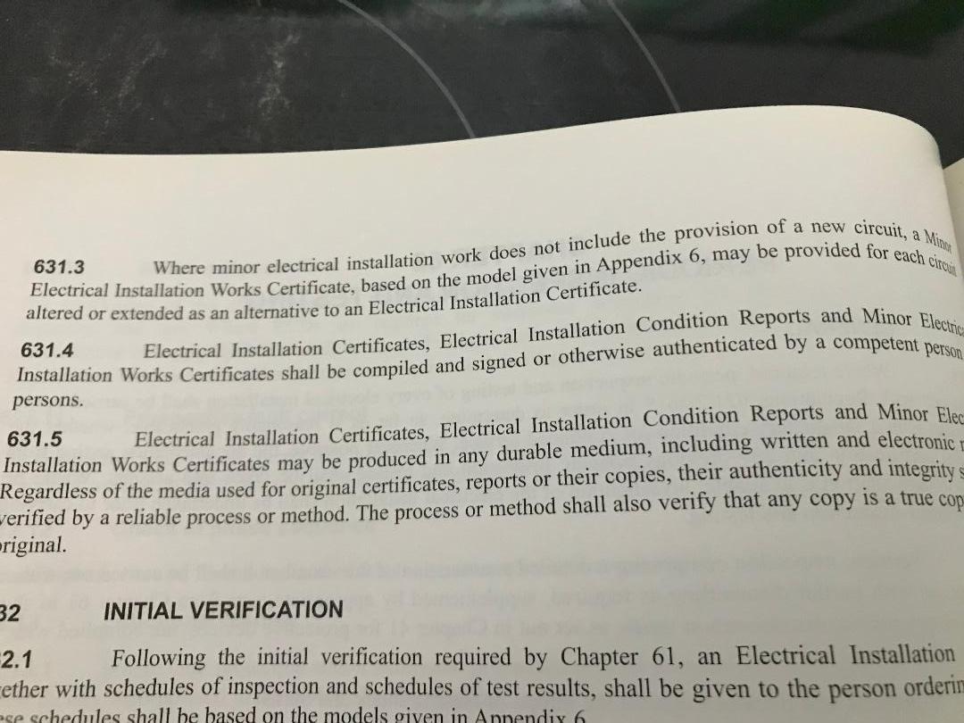

bradders3109 Posted March 4, 2021 Share Posted March 4, 2021 On 08/01/2021 at 09:59, Brix said: Cheers. Can you tell me where that requirement is set out? I'd like to point m to it! sorry I'm a new member to this forum and only just seen this. I qualified under BS 7671 17th edition and the reg then was 631.3 and App 6 as in the graphic. I believe under the 18th it's 644.4.201. 1 Link to comment Share on other sites More sharing options...
