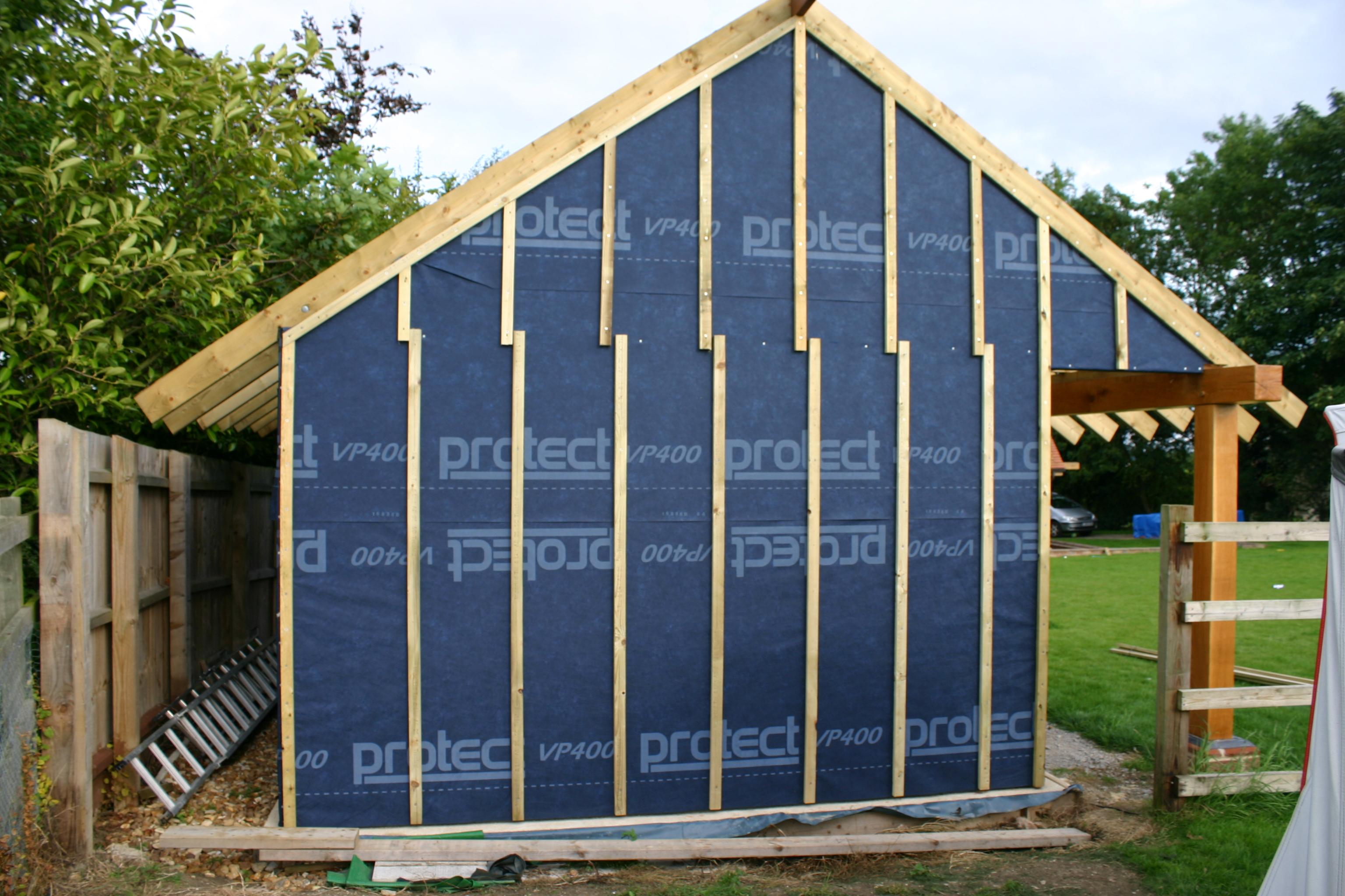

My research here leads me to going for Protect VP400 membrane. It's like to be exposed for 4-6 weeks whilst I await delivery of my unicorn poo Redland tiles. Fully expecting that delay to increase with the 3rd lockdown this week!
I used Protect VP400 (Dark blue color) on an out building about 8 years ago. Think I got it from Screwfix. Seemed strong and survived exposed for many months. Used it both under tiles and behind timber cladding.
Edited by Temp
