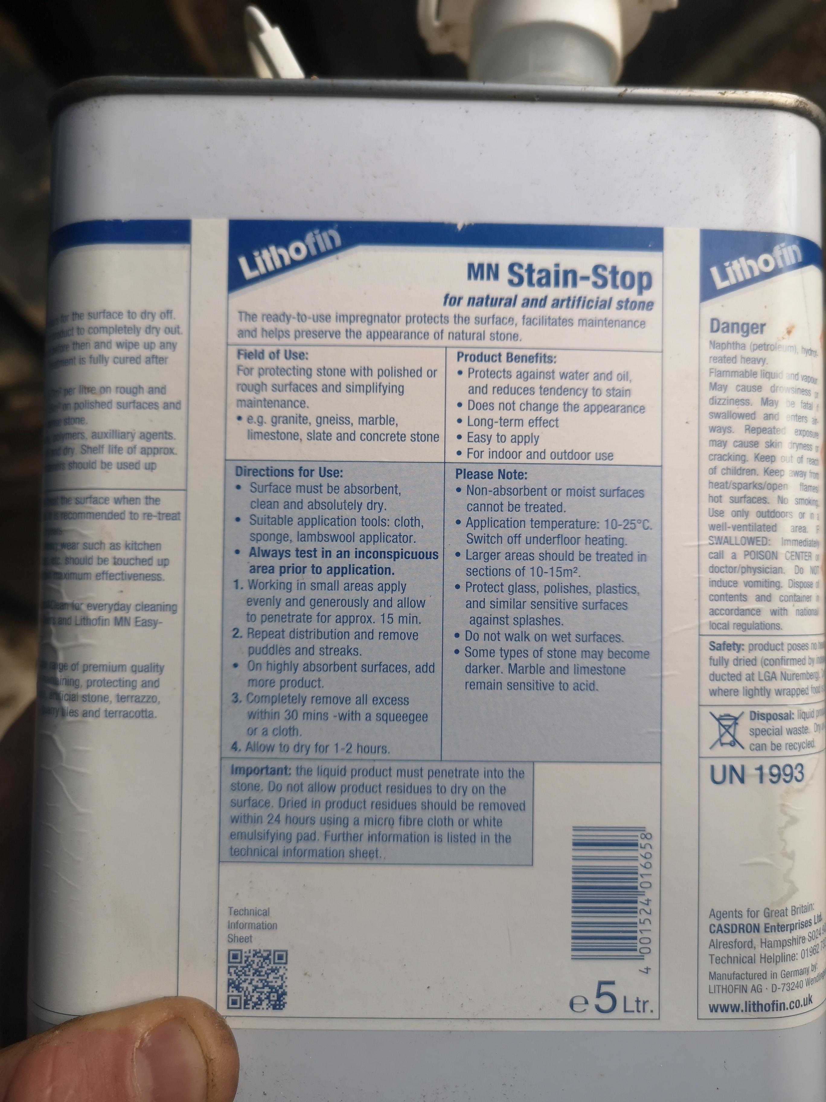

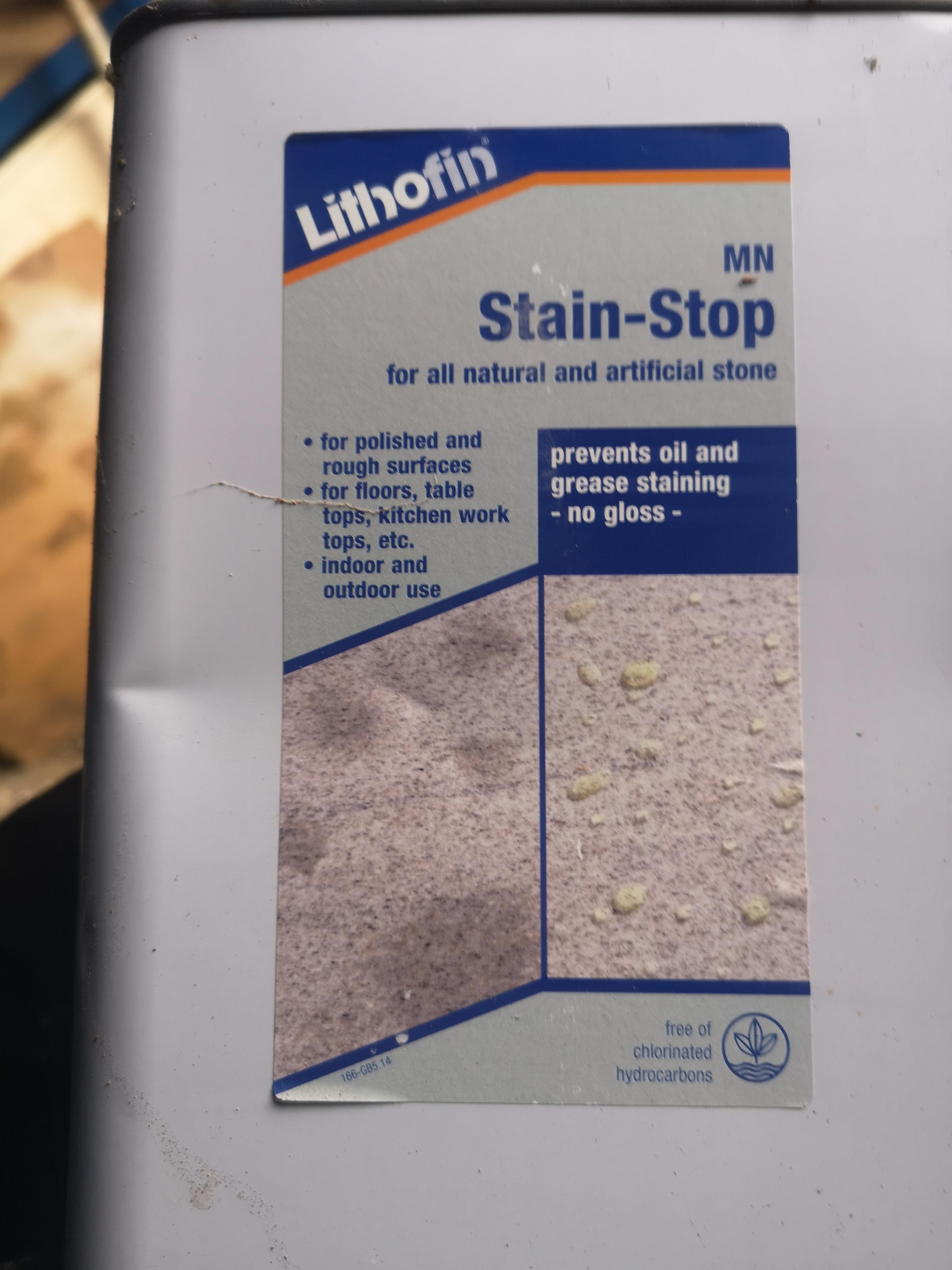

Construction Channel Posted December 30, 2020 Share Posted December 30, 2020 The only person that sleeps better than kenny is me. 8 hours minimum for that boy, last night he had a cool 14 without a peep. But as for the sealants, i have not used that one, consideri g the brand i would assume id does as described, I have used this stuff reccomended by my tiler on my concrete worktop, travertine floor tiles and patio . Came up almost invisible/matt. 1 Link to comment Share on other sites More sharing options...
