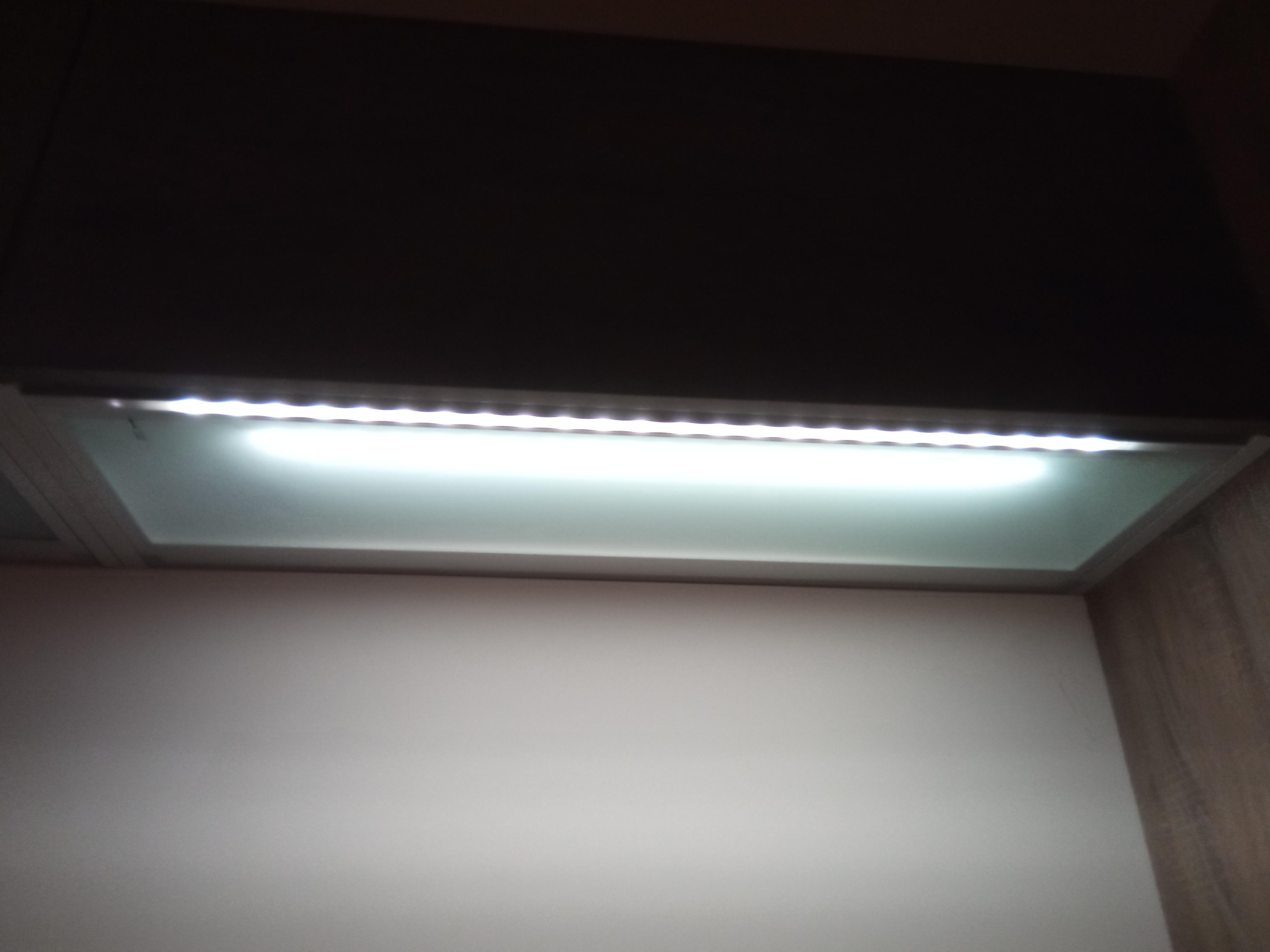

Ok so this is one we are hoping to sort ourselves. We had a spare cupboard left from our kitchen and it has LED Lights built in which you touch to turn on, pic below of cupboards in our kitchen.

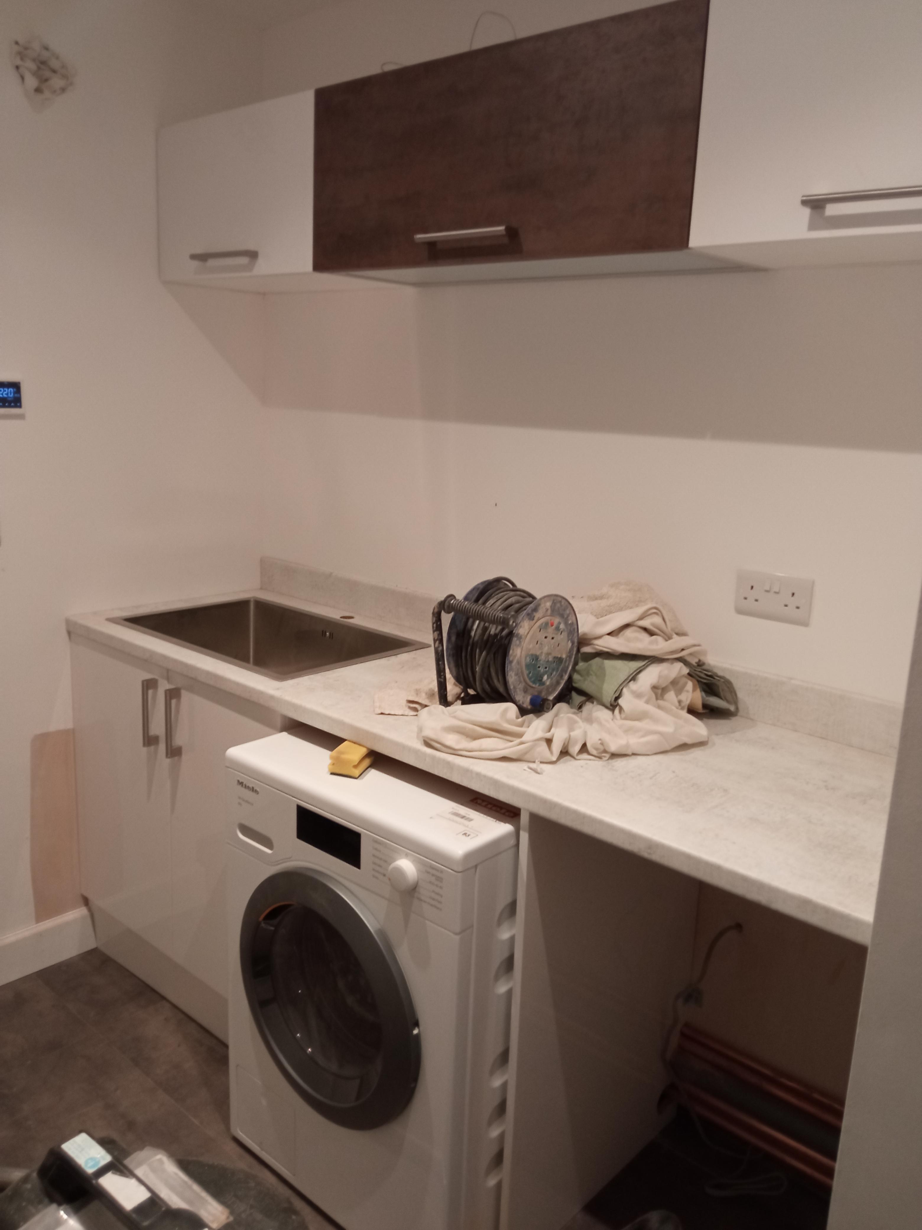

We weren't going to use the spare one but not wanting to waste anything we incorporated it into our utility, last minute decision. Pic below (work in progress but it's the middle one).
Whilst not necessarily essential we use the LED lights under the one middle cupboard it would be good if we could but obviously as we never planned to have lights there this is an afterthought. Would it be possible to wire up to a battery?

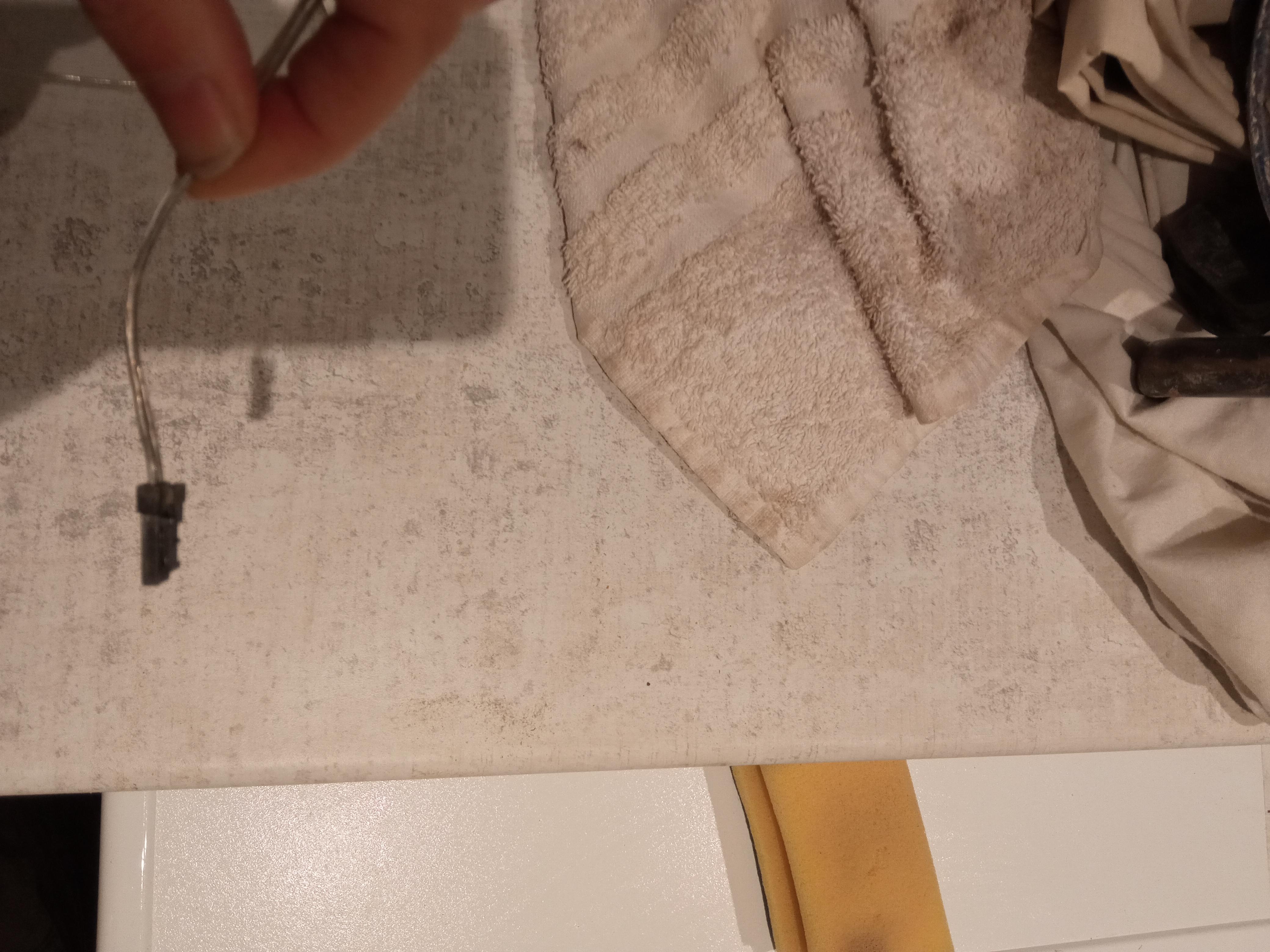

Here is the wiring attached to the cupboard.
Suggestions please.
Make and model of light fitting would give a better chance to understand voltages etc
Did anything come with the kitchen fir it to plug into?, transformer?
