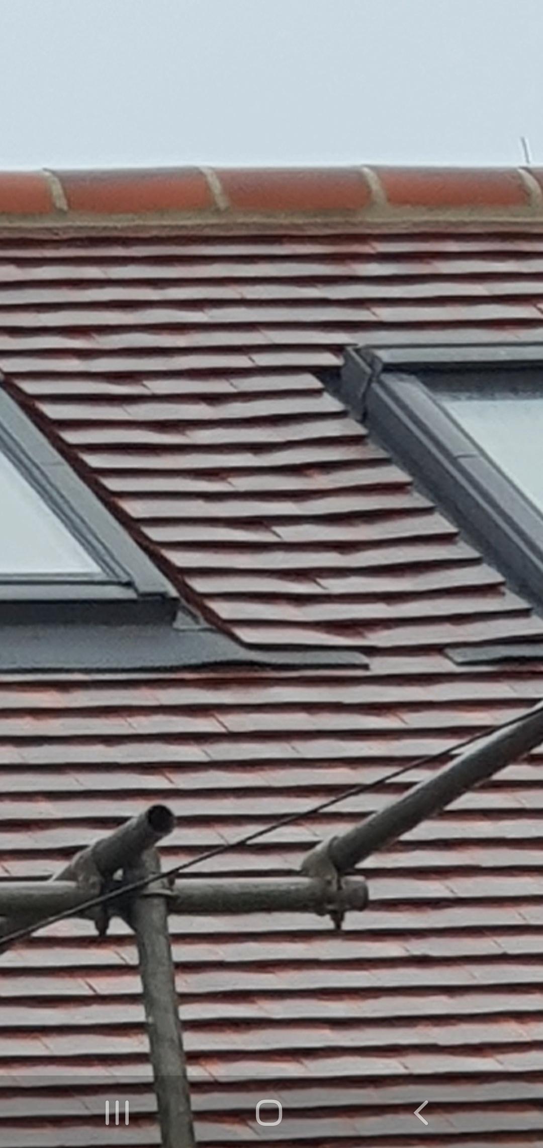

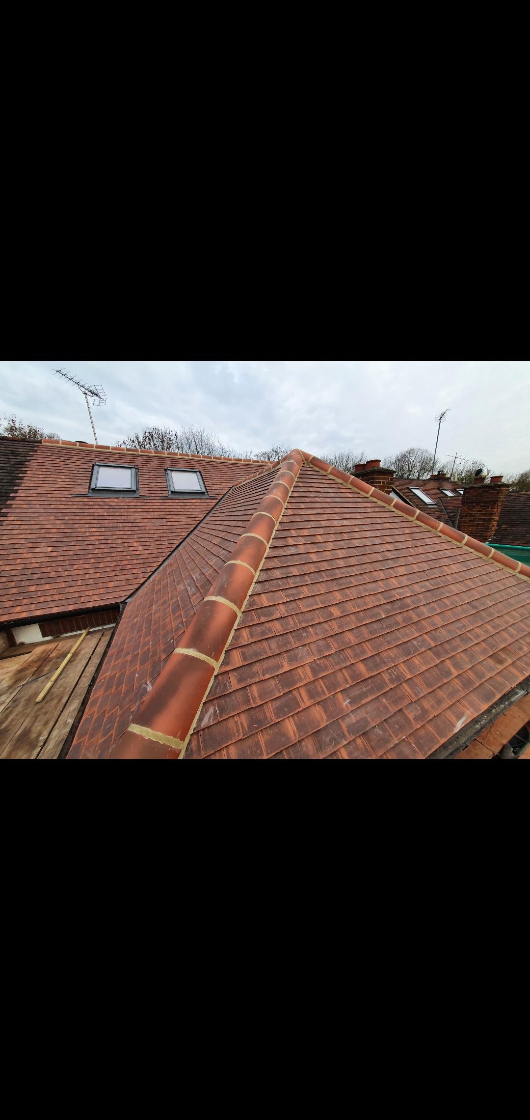

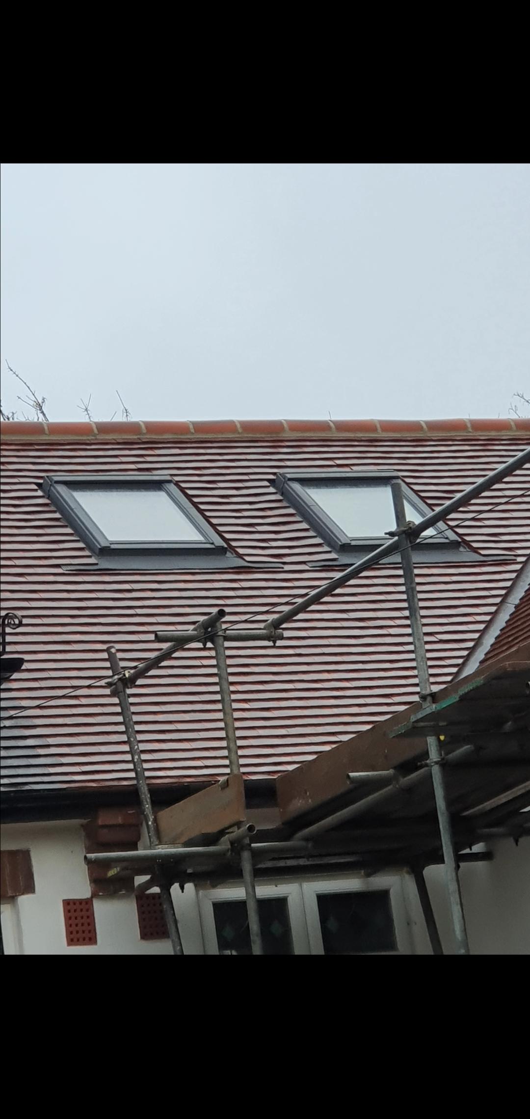

Rickstar007 Posted December 13, 2020 Posted December 13, 2020 Hello everybody, I have just had a new loft conversion and a new roof, new clay tiles (Burnt Flame), battons and felt. I am very pleased with how it all looks so far. Just one thing, on the front of the new new roof where we have had 2 new Velux windows put in, fairly close to one another... The tiles in between the windows and around the edges seem to have a bit of a kick and do not look completely straight... I would appreciate some advice please, is this OK and nothing to worry about or should it be put right? Pics attached Thanks in advanced.
nod Posted December 14, 2020 Posted December 14, 2020 It looks a nice job Its normal to get a kick on top of the flashings especially with tiles Slates are easier to keep flat
tonyshouse Posted December 14, 2020 Posted December 14, 2020 Not going to leak, may be they didn’t de-nib the tile next to the flashing . Tile should sit against first upstand and on second one
MikeGrahamT21 Posted December 14, 2020 Posted December 14, 2020 Perfectly normal, there is a strip of foam under the tiles there to stop them rattling during high winds 1
