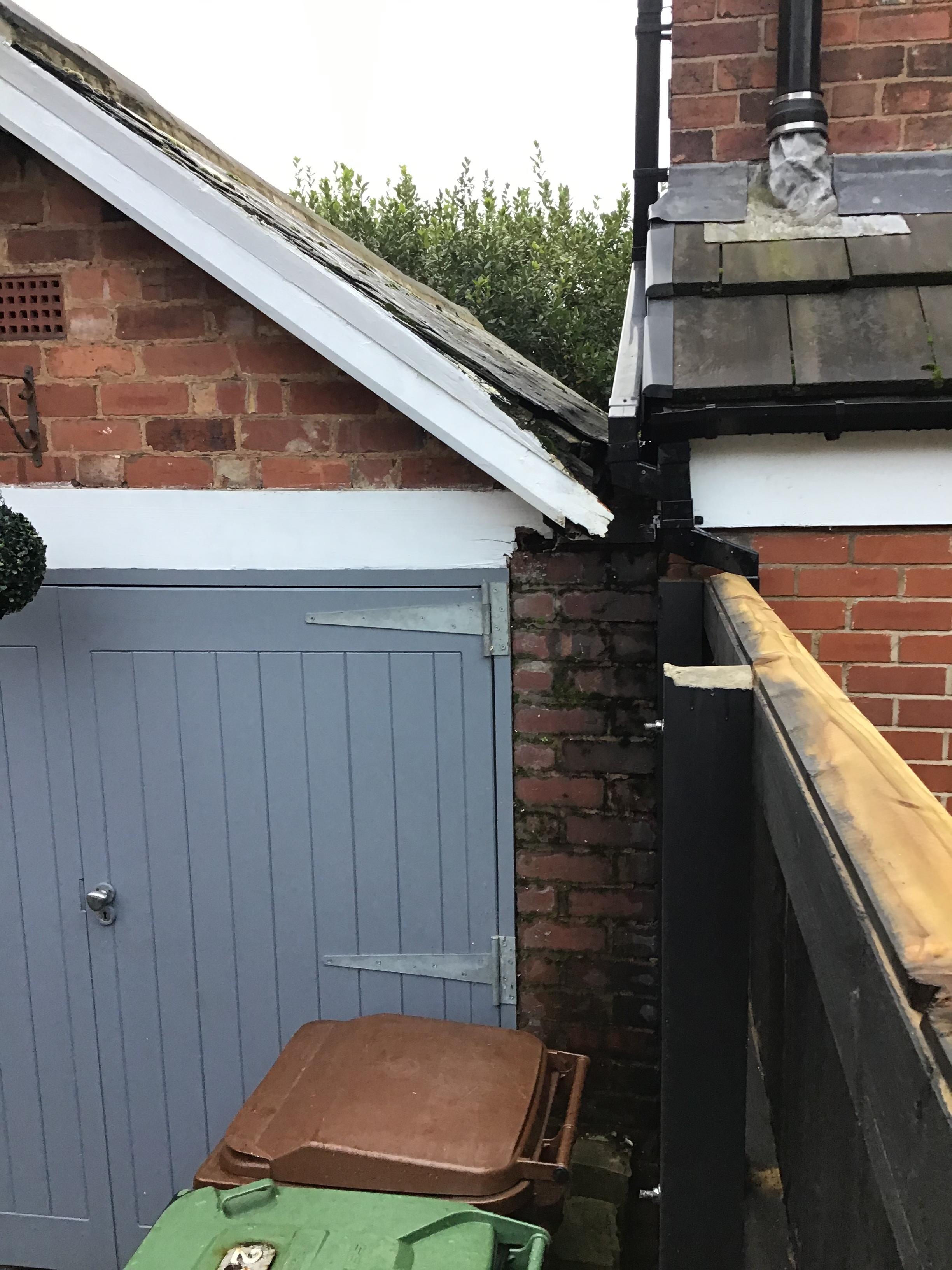

i have a damp issue on a party wall that looks like it is being caused by poor guttering from next doors garage which is attached to the party wall. The party wall is on my property and part of my Victorian house but some time later a garage has been attached to the wall and the roof from that and the guttering is poorly maintained and now causing damp. We have already had issues with neighbours over taking down a conifer hedge that was causing damage to drains so need to tread carefully. Any advice would be appreciated
Posted
Welcome, firstly I question if that is a party wall? They are usually between two houses and the middle of the wall is the boundary. To me that looks like your wall and they have built a garage up to it. Their roof definitely looks dodgy and I doubt very much whether permission was gained for your neighbour to use your wall (unless they have their own wall next to yours). Neighbour disputes are difficult but I think you have to insist they repair their roof as it is damaging your property.

That looks like a can of worms.  Have the slates on their garage roof been painted with something?

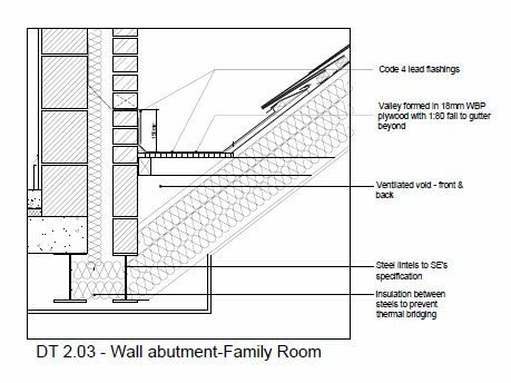

A new junction/gutter between the two buildings will need careful design and implementation so as not to make things worse. You don't really want some cowboy doing a bodge job. If you want to look up drawings yourself google "parapet gutter".
I reckon a common problem is making them undersized (not deep enough or wide enough) so they can't collect all the water running down the roof in a downpour, especially if partly blocked.
There must all so be an adequate fall along the length of the gutter.
You may/will need to allow them to install a flashing by cutting into your wall.

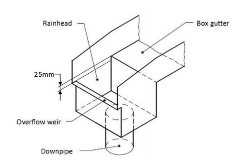

https://commons.wikimedia.org/wiki/File:Parapet-gutter.gif

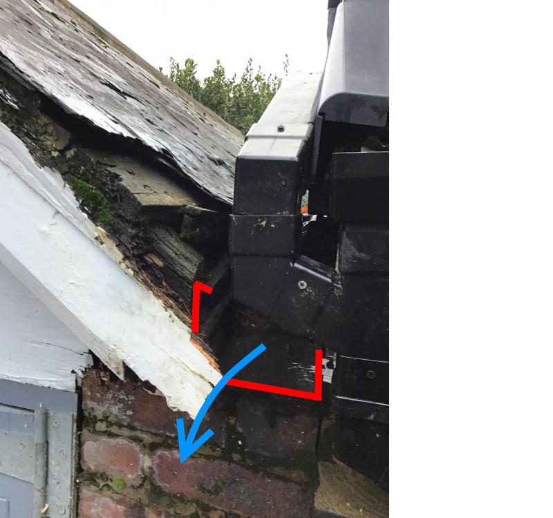

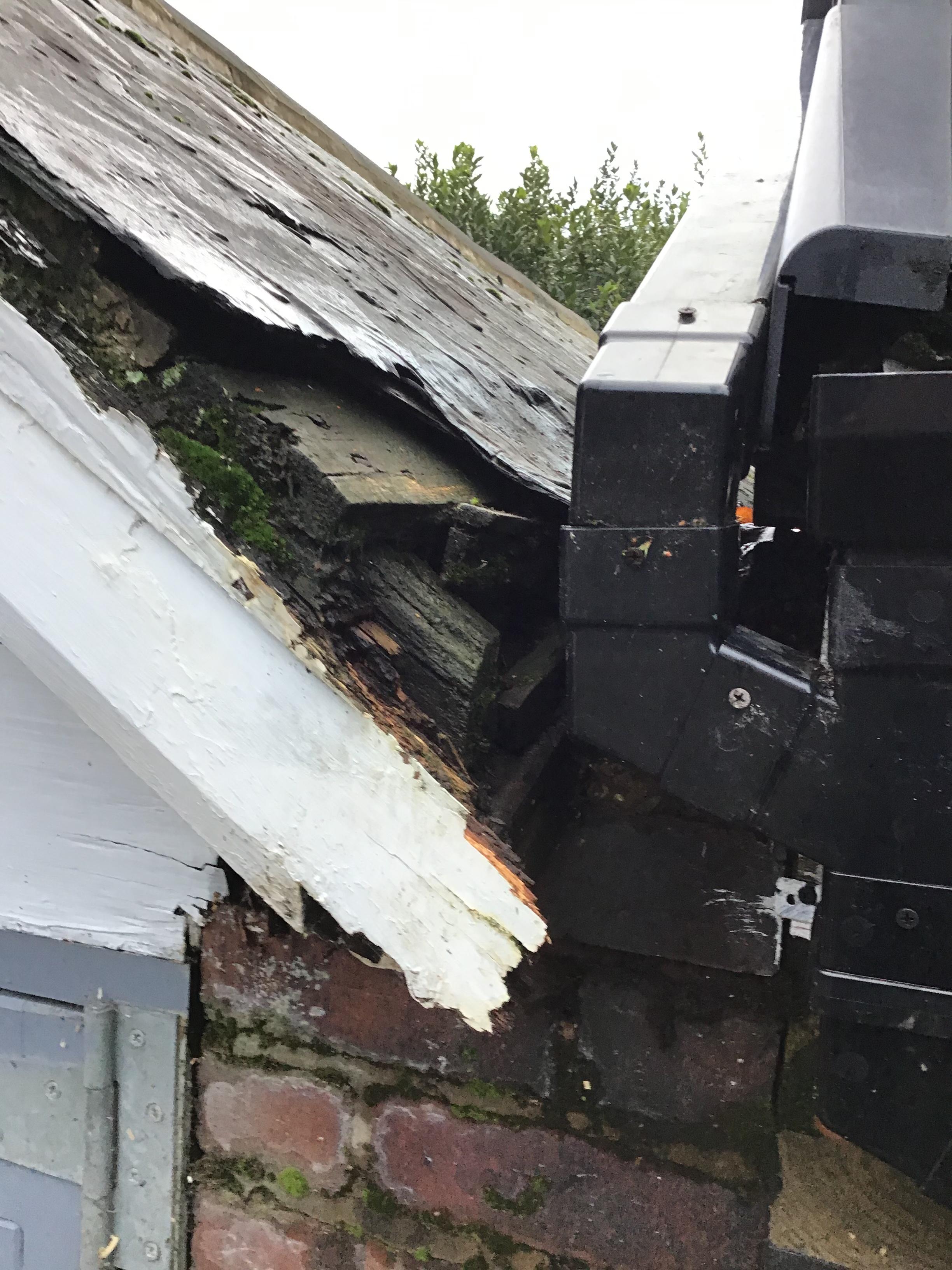

Once collected  the water can either exit via a bottom outlet into a downpipe or out one end into a hopper/downpipe. This drawing shows one with an overflow weir if the down pipe can't cope.
In this picture it looks like the gutter is just open at the near end or perhaps the end has fallen off.

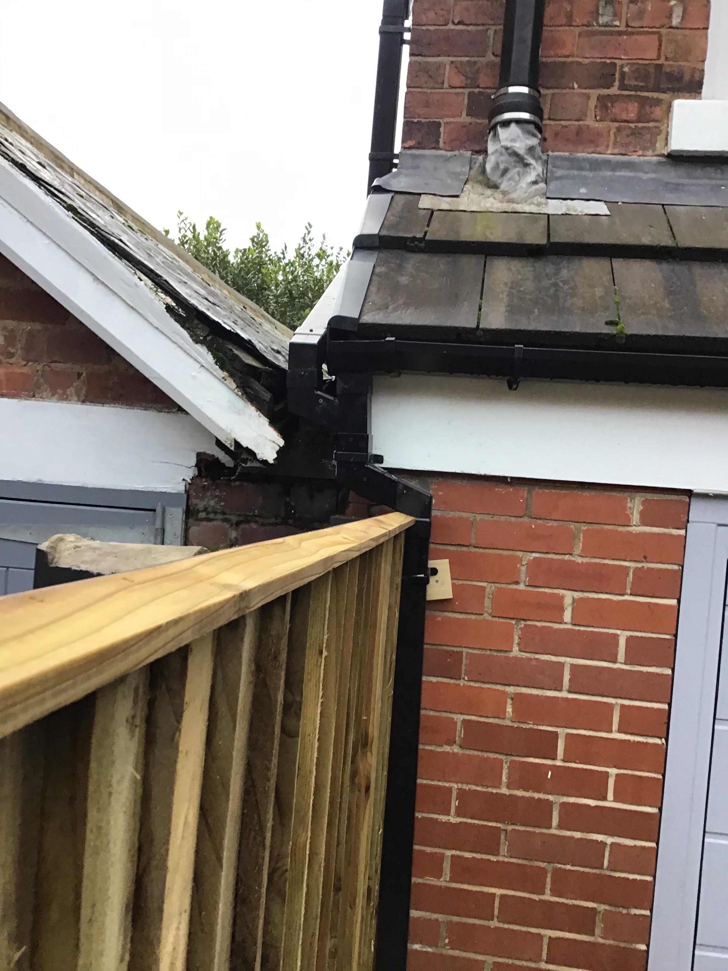

Two other things occur to me..
You have a down pipe that appears to be on their side of the boundary. Where is it collecting water from? Is the boundary the face of your wall or a few inches out from the wall? Frequently this is a grey area not clearly defined in the deeds or anywhere. Things like pipes are only meant to overhang the boundary with written permission of the other owner but builders of estates and old houses never bothered to document this sort of thing. It wasn't a big deal years ago. The land registry title drawings aren't usually definitive.  Just beware that it might come up in any discussion you have with the neighbour.
If there isn't a surface water drain on their side of the fence they might want to connect a new box gutter into your down pipes. You could allow that but a more expensive/better option might be to allow them to run a 110mm pipe below ground across the boundary so they can have a downpipe on their side into gulley at ground level. I think that would look better (more normal) to a future buyer of either property.

the drainage from the garage roof goes to the far end of the garage where it goes into a fall pipe on next doors property.
The Downpipe you can see is from a valley between roofs on our house, there is also a waste pipe that comes from our bathroom which comes out over the neighbours property down the side of the house and back into our property, none of this is in the deeds.
