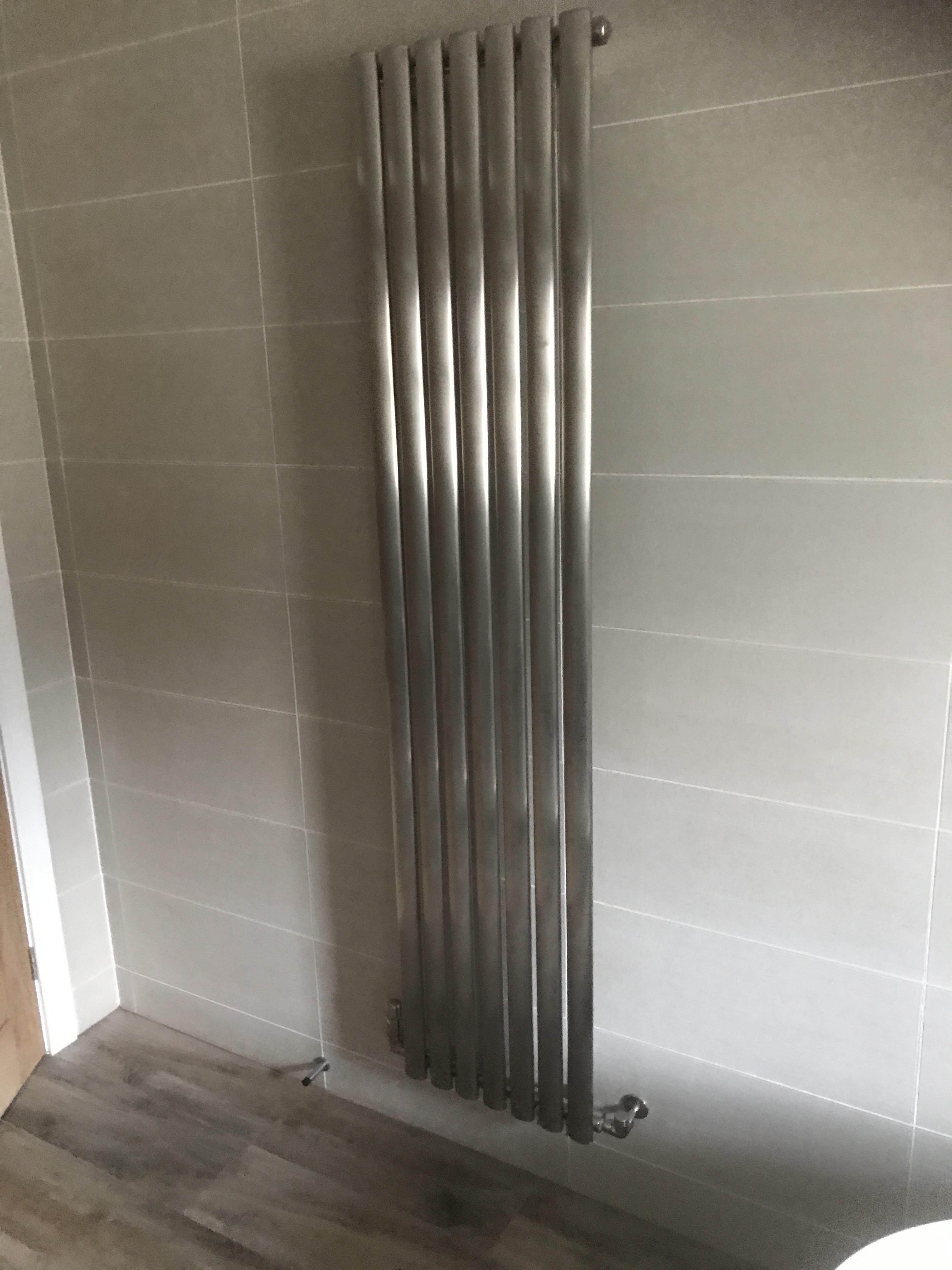

nod Posted December 6, 2020 Share Posted December 6, 2020 28 minutes ago, Red said: My build is at the point where I need to settle on the style, material ,size etc for the few radiators I will need, so a mix of vertical and horizontal radiators are required, aluminium is a option although I have no experience of brands to avoid etc ,mhs, K.RAD, Vogue UK, Apollo, Renia etc, guarantees vary from 5yrs to 15yrs along with varying costs, any thoughts experiences etc appreciated We bought three of these for the bathrooms SS So 25 year guarantee Link to comment Share on other sites More sharing options...

nod Posted December 6, 2020 Share Posted December 6, 2020 28 minutes ago, Red said: Visually I can get a almost identical option in mild steel but I am trying to look a products with a longer life span so potentially less maintenance in the future hence the use of aluminium, ,the property is relatively well insulated along with the complete ground floor having UFH, We had the same issues at previous homes Particularly in bathrooms Rust along the bottom At least with stainless we won’t have that Though we have addressed the condensation problems of previous homes Better ventilation Much better extraction Insulated plasterboard throughout the house Link to comment Share on other sites More sharing options...
