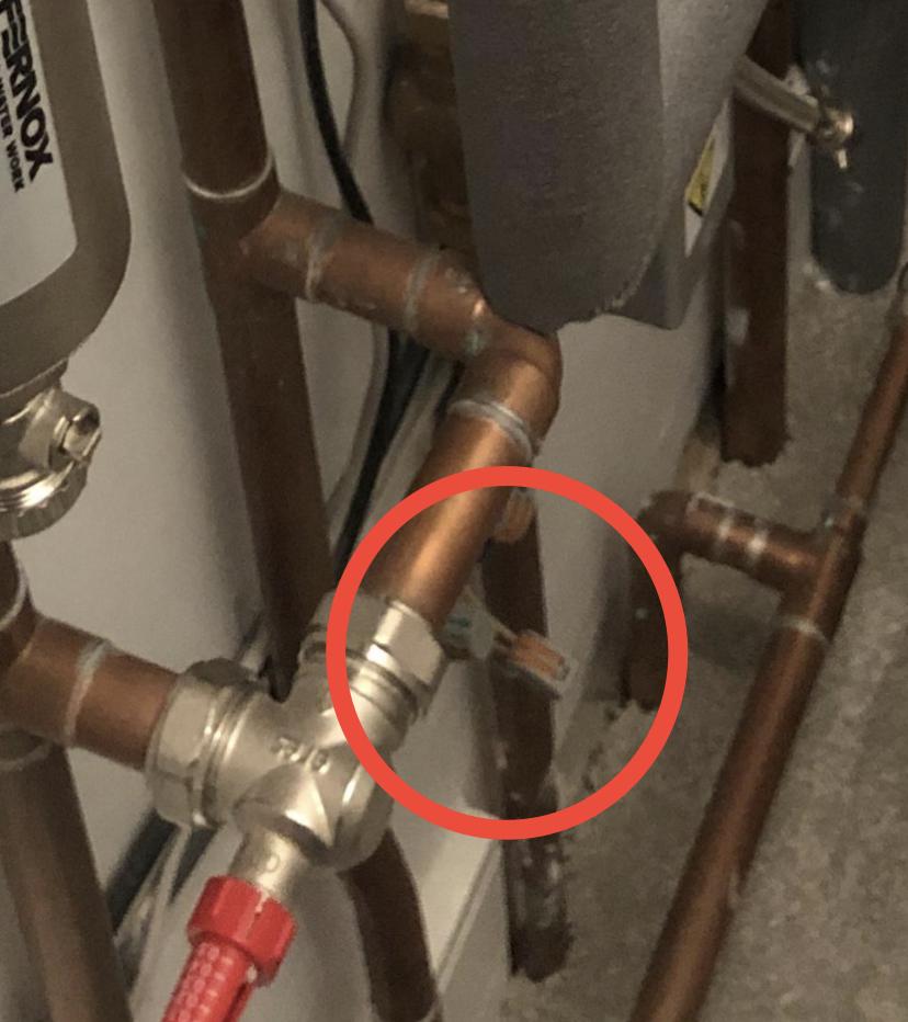

That is just shocking install ..!! They appear to be using T&E cable as flex between  the isolator and the controls, and 3 loops for the whole of the ground floor ..??
Can you take a photo of the valves near the hot water tank as I expect there is another set and it wouldn’t surprise me if the rads and UFH are fighting for the same heat and only when the rads are satisfied is the UFH getting the flow.
Thanks for your note. Here are a couple of photos of the hot water tank area upstairs

 Is this one of their hybrid heat pumps that works with a gas boiler ..?
And all that pipe should be insulated - Building Regs !! Is it brand new ..??
Is there an internal Vaillant unit or just the cylinder..?
And finally ... any more pumps ..??

Hi, no gas on the development just an air source heat pump in the garden. The house is 2 years old, I’ve recently moved in. There is the cylinder and then another vaillant unit which has a sticker on it which says SM 1 inhibitor. No more pumps from what I can see. Thank you
No model number or plate on the internal box ..??
If there are no more pumps then I expect that the issue is the heating system is expecting the rads and the UFH to work at the same time and that is asking for trouble. The rads will suck the heat from the system - I expect it has a circulation pump in the main unit that it is using here - and the UFH is being starved of heat. I would try the following :
- set the hot water to come on between 04:00 and 06:00, which means it will be satisfied before the heating is needed
- set the UFH flow valves to maximum, don’t turn them too much as they can come off in your hand ....
- set the UFH room stats to come on at 06:00 for heating, and the rads at 06:30
A rad flow temperature of 42°C may not feel that warm as your hand will be 38°C anyway. Unfortunately as they haven’t put a blending valve on the UFH, there is no way of turning this up as you will have issues with overheating the floor.
Out of interest, what are the floor coverings in each of the rooms heated with UFH..?
