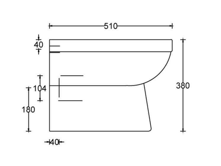

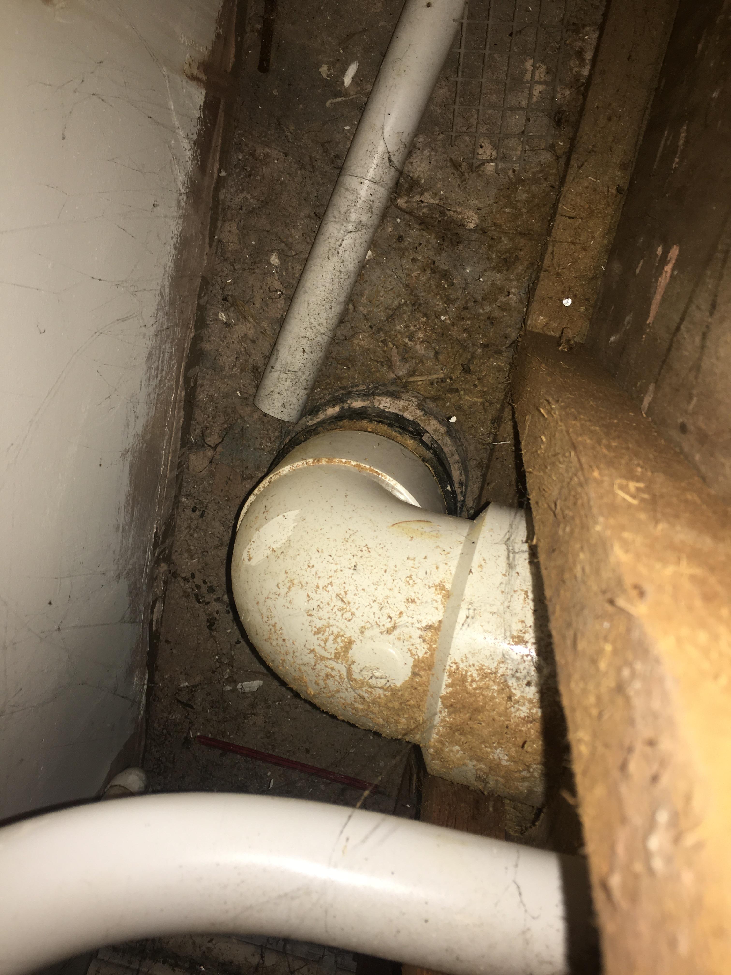

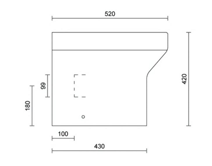

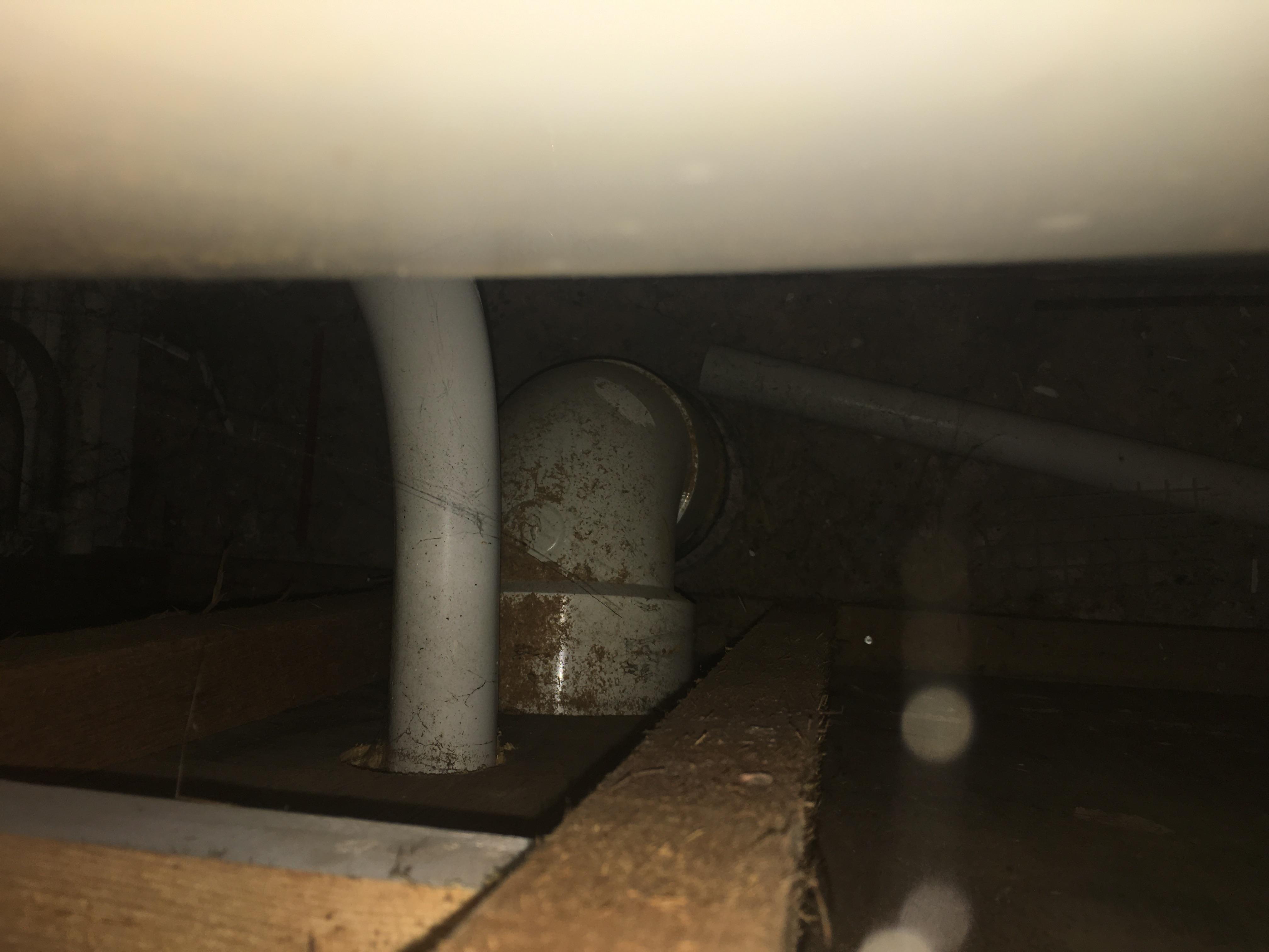

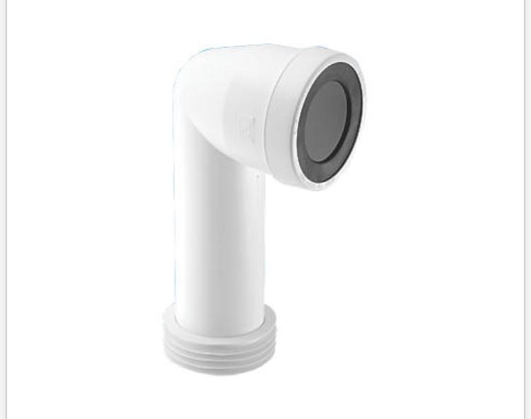

dangti6 Posted November 30, 2020 Share Posted November 30, 2020 I’m starting to gather parts ready to renew my downstairs loo. I have a back to wall toilet which is against a false wall to conceal the cistern etc. The pan connector is a 90 degree pipe down to the floor. Presumably I require a new connector like this whilst I’m renewing: My toilet is in a fixed position where it is, I’m wanting to utilise the original false wall arrangement so I now believe I need to consider the distance between the pan connector pipe and the ceramic connection inside the toilet, which I see differs from toilet to toilet going by some that I have been looking at (100mm vs 40mm for example) I can find pan connectors that have expandable sections in terms of height from the ground or if I was joining to a soil pipe horizontally but can’t put my finger one ones that adjust the position in toward the rear of the toilet. Am I going to have to get a new toilet with the same outlet depth as the original in order to keep the placement the same? if I had gone on and bought the one with the outlet 100mm inside, I imagine I’d have found this out the hard way and had the toilet set back at which point I’d have insufficient room for my cistern in behind - unless there is another method/pipe to use. Link to comment Share on other sites More sharing options...
MAB Posted December 1, 2020 Share Posted December 1, 2020 (edited) McAlpine in link below do a space saving 90 degree bend and also a straight telescopic extension which combined together might help:- https://mcalpineplumbing.com/wc-connectors/rigid-wc-connectors Straight telescopic extension:- https://mcalpineplumbing.com/wc-connectors/rigid-wc-connectors/wc-con-ext-straight-telescopic-wc-socket-extension 90° Bend Adjustable Length Rigid WC Connector:- https://mcalpineplumbing.com/wc-connectors/rigid-wc-connectors/wc-con8c-90deg-bend-adjustable-length-rigid-wc-connector 90° Space Saving Bend Adjustable Length Rigid WC Connector:- https://mcalpineplumbing.com/wc-connectors/rigid-wc-connectors/wc-conqc-4110mm-90deg-space-saving-bend-adjustable-length-rigid-wc-connector 90° Bend Adjustable Length Extended Inlet Rigid WC Connector:- https://mcalpineplumbing.com/wc-connectors/rigid-wc-connectors/wc-con8e-90deg-bend-adjustable-length-extended-inlet-rigid-wc-connector Edited December 1, 2020 by MAB 1 Link to comment Share on other sites More sharing options...
dangti6 Posted December 2, 2020 Author Share Posted December 2, 2020 Thanks MAB. I wasn't aware of such an extension piece to go in between a connector and the pan (another place for a leak to potentially occur is the only negative I guess) That very much sounds like the way forward then. Allow SWMBO to select toilet of choice and if the connection is deep inside i can use the extension. If it's near the back but not quite enough to bridge the gap then I can use one of those extensions and a space saving 90 bend to kick it back a bit. 1 Link to comment Share on other sites More sharing options...
