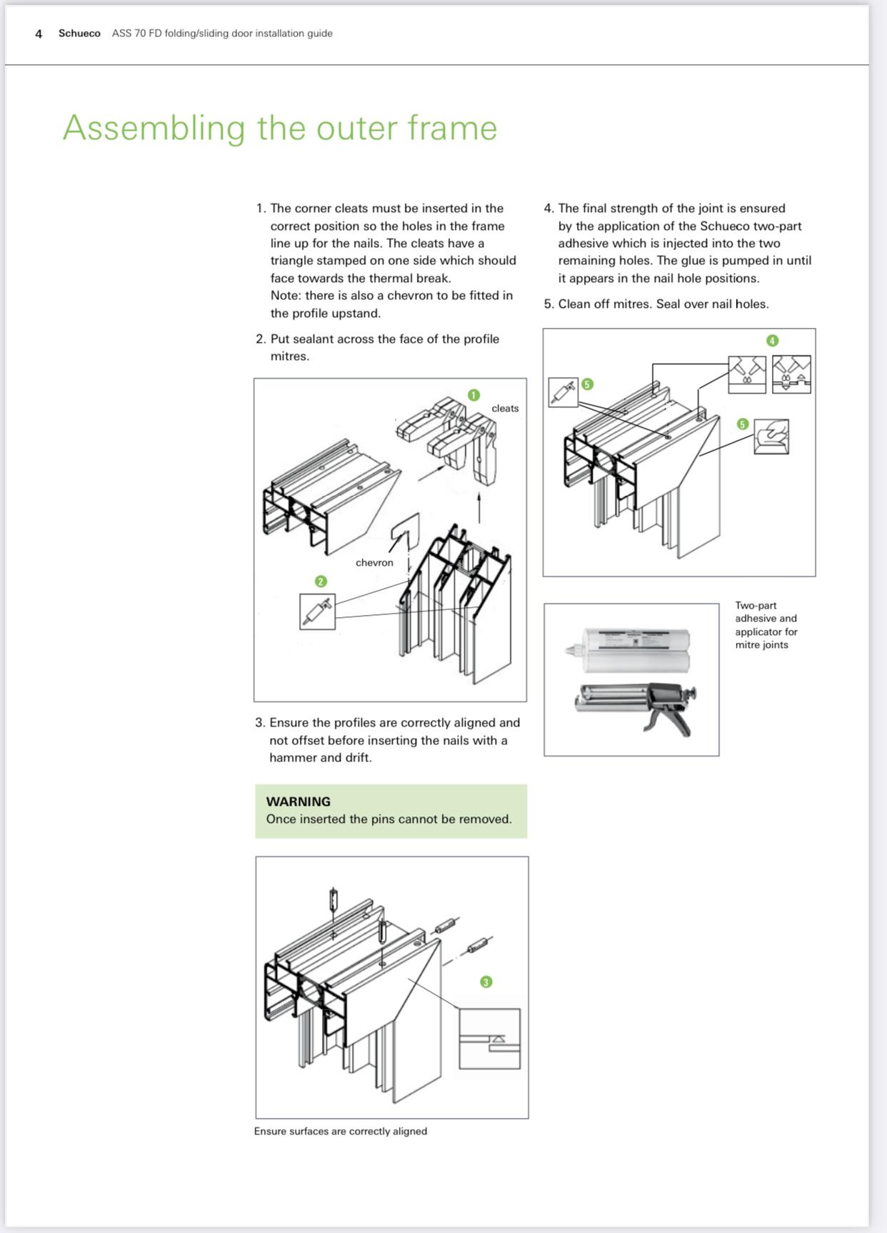

GrantMcscott Posted November 26, 2020 Share Posted November 26, 2020 Is there an alternative to the glue needed for SCHUCO BI-fold doors to put the frame together as the fell of my seat when they told me how much £150 2 part adhesive to fill the mitre joint £230 for the applicator gun £40 for the nozzles for the glue £70 for the 1 part mitre joining compound + delivery and VAT £500 to join the corners of the frame for a set of bi-folds Link to comment Share on other sites More sharing options...
craig Posted November 27, 2020 Share Posted November 27, 2020 (edited) I don’t see why another type of bonding agent wouldn’t work. You won’t have warranty as you haven’t followed the guidelines for assembly. Edited November 27, 2020 by craig 1 Link to comment Share on other sites More sharing options...
