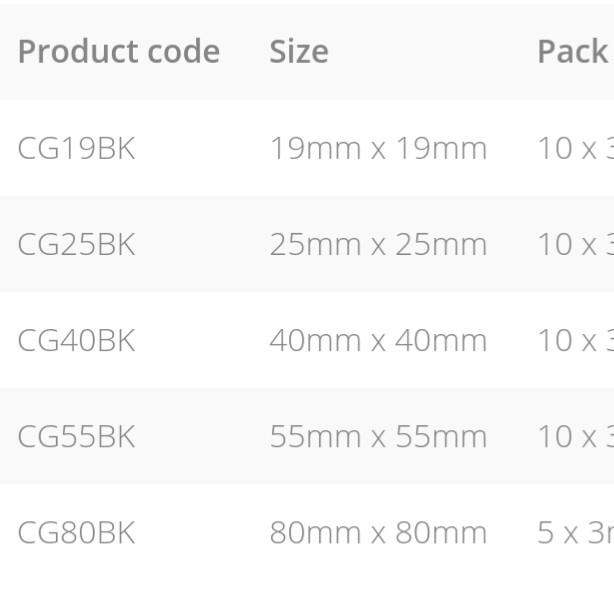

success1980 Posted November 17, 2020 Share Posted November 17, 2020 Hi all, I have run the cables for my lights and gate openers to the house now and have to go in through the external wall about 500mm above the finished drive. Was looking into 30mm black ducting but it doesn't look nice Is there an elegant solution to hide these as much as possible? Thanks Link to comment Share on other sites More sharing options...
Conor Posted November 17, 2020 Share Posted November 17, 2020 Personally, I'd track the cables in the wall in conduit and straight in to the ground. Link to comment Share on other sites More sharing options...
Onoff Posted November 17, 2020 Share Posted November 17, 2020 Cable guard? https://www.tlc-direct.co.uk/tcl/search?query=Cable+guard&Submit=Search Link to comment Share on other sites More sharing options...
success1980 Posted November 17, 2020 Author Share Posted November 17, 2020 7 minutes ago, Onoff said: Cable guard? https://www.tlc-direct.co.uk/tcl/search?query=Cable+guard&Submit=Search That might be the simplest solution as it is a retrofit and i can't go straight down anymore Link to comment Share on other sites More sharing options...
Onoff Posted November 17, 2020 Share Posted November 17, 2020 32 minutes ago, success1980 said: That might be the simplest solution as it is a retrofit and i can't go straight down anymore Rough them up and put some plastic primer on then paint to match the wall. Just make sure you get the size that'll cover your ducting: Link to comment Share on other sites More sharing options...
