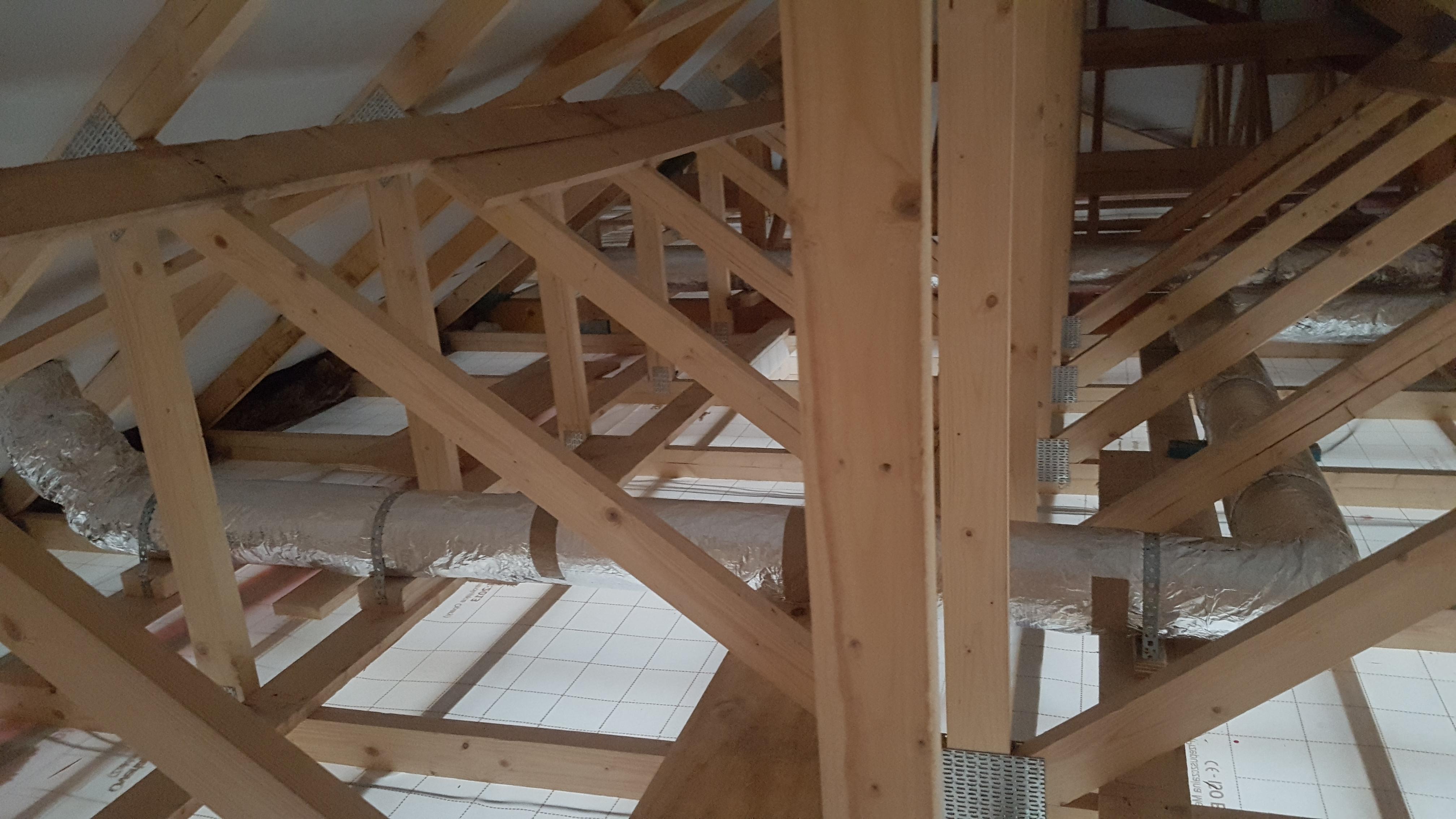

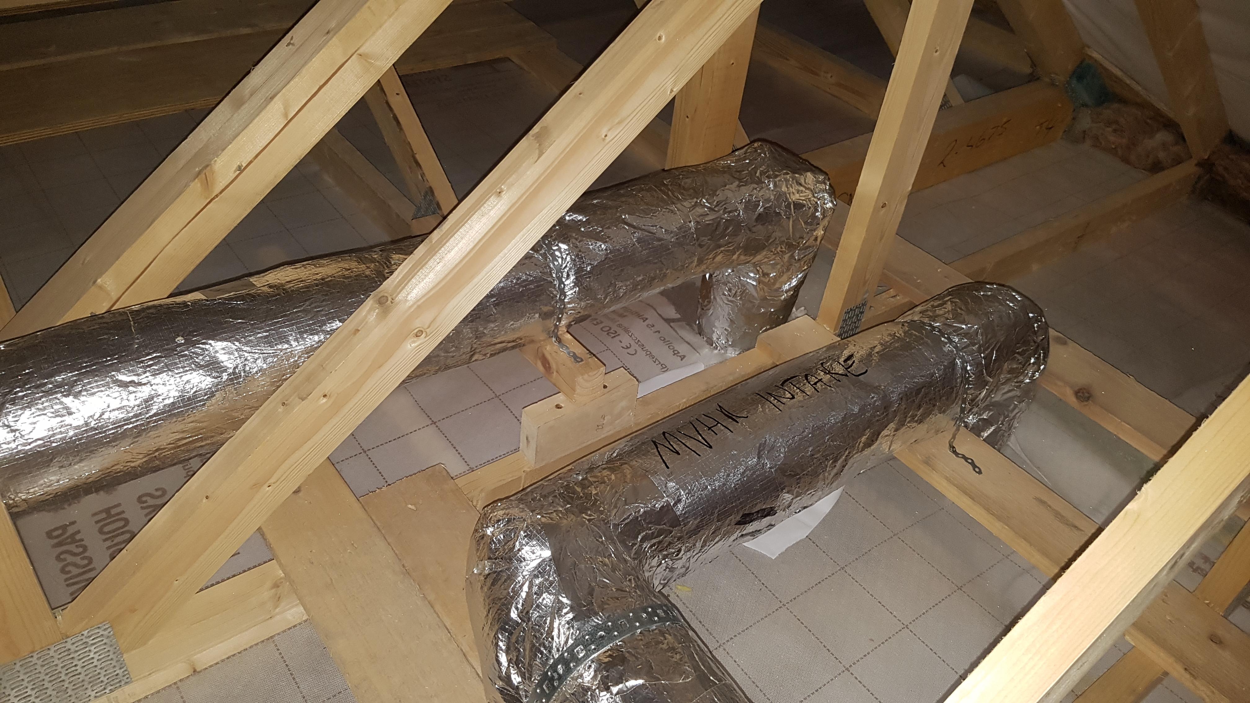

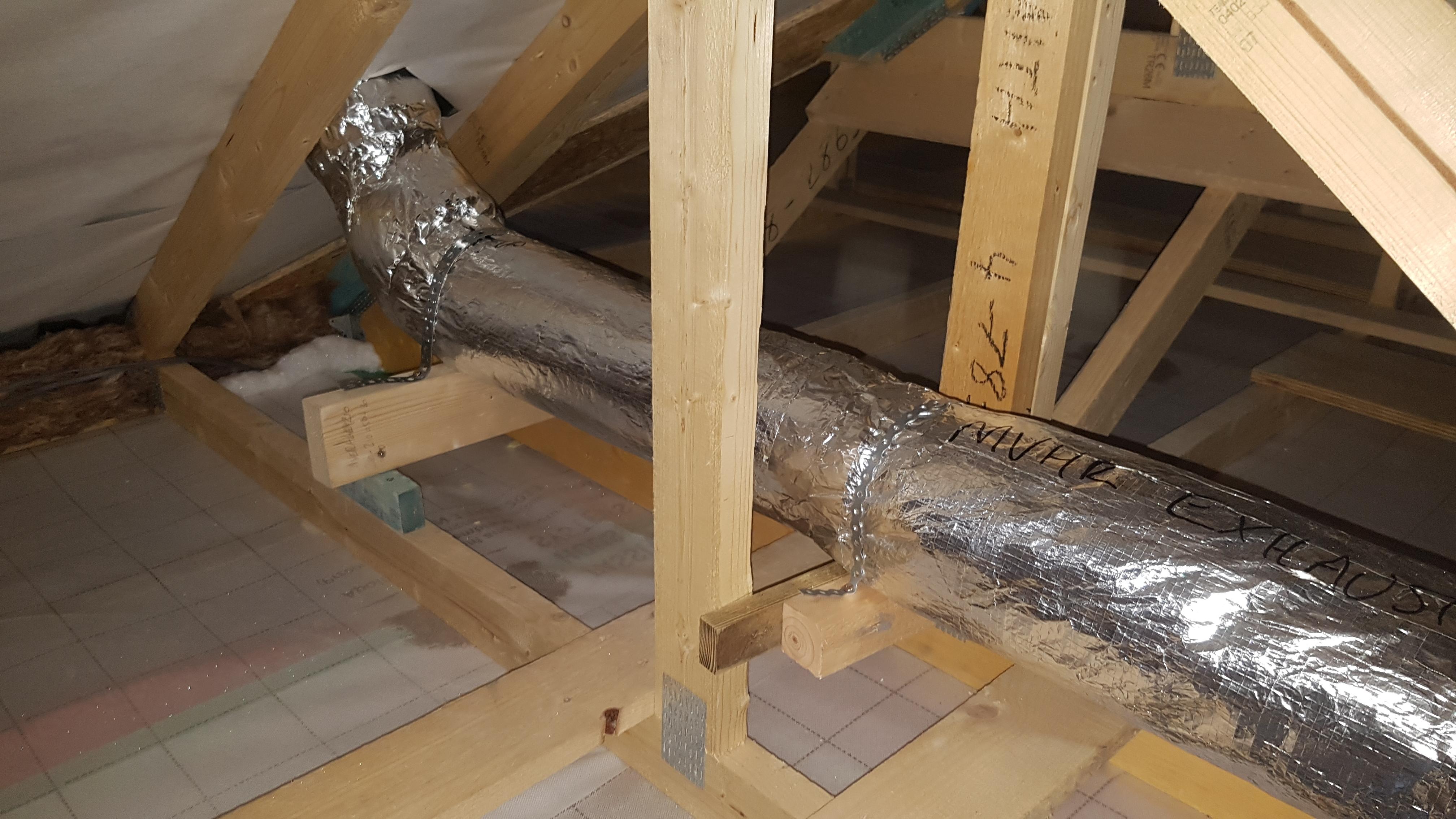

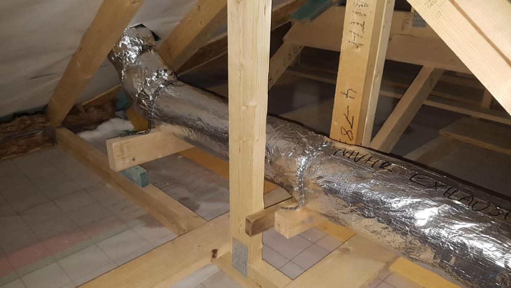

Oz07 Posted October 25, 2020 Posted October 25, 2020 I never got that advice with my bpc tile vent installation. I just got told continuous fall on duct back to unit. Surely if the unit has a condensate drain it will do the job there? My ducts are wrapped in the foil insulation, foil taped at joins of insulation and covered with loft insulation until they reach the tile vent.. @Declan52 how did the condensation make it's way into supply side ducting?
Oz07 Posted October 25, 2020 Posted October 25, 2020 This was mine. Intake was a bit long but needed 2m separation and wanted them on sane elevation.

Hastings Posted October 26, 2020 Author Posted October 26, 2020 Thanks @Declan52. and @Oz07 for pics. I think it's clear I don't need to worry about a drain for the main exhaust. Good advice about insulating, (ie. you can't really have too much).
