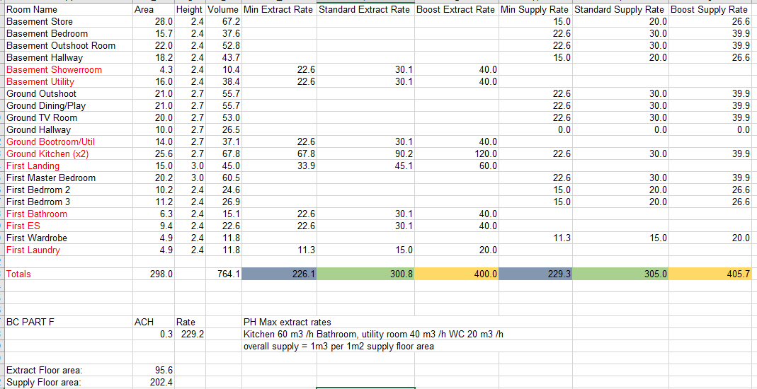

Conor Posted October 8, 2020 Share Posted October 8, 2020 (edited) Budget and practical issues now dictate I'll have to settle for a single large MVHR instead of two medium sized ones. The largest Passive House certified (bonus, not a must) is the Zenhder Q600 - capable of up to 600m3/hr at 200pa. https://www.zehnder.co.uk/ventilation-units/heat-recovery-centralised/units-smaller-800-m3h/zehnder-comfoair-q600-st First stupid question - is this 300m3 on inlet and 300m3 on outlet at the same time? Or can it be biased to extract? I can't seem to find that info on the unit. Second, I've calculated my required "normal" extract and supply rates based on the Passive House design guide that gives typical nominal rates for each type and size of room. They then say 33% increase from this figure for boost, and 33% reduction for minimum flow rates. I've also done a sense check against the building control requirement on 0.3ACH. Is there anything I've missed? I can't quite figure out what flow rate capability I need... Edit: I can greatly reduce the extraction requirements - I've planned two 60m3/hr extracts in the kitchen, this can be reduced to one, and a extract in the vaulted hallway as I think it'll gather a lot of warm air and any smells that escape the kitchen through the mezzanine. Edited October 8, 2020 by Conor Link to comment Share on other sites More sharing options...
Thorfun Posted October 8, 2020 Share Posted October 8, 2020 I'm sorry I can't help with your questions, but can only tell you what we're planning. we're having the Q600 and are building a basement and two above ground floors for a total of about 440m2. We're using Enhabit to do the design and calculations as I didn't want to make a mistake on it and their price was really quite good for the equipment and so I thought the design fee was acceptable seeing as the total price wasn't much more than I could've bought the equipment myself online! When I was getting quotes I had 2 companies recommend the Q600 and both of them suggested using the larger 90mm ducts to get the air flow required at lower rates and this is what is currently being designed for us by Enhabit. So, maybe you could consider that to assist with your flow rates? like I said, probably not much help but thought I'd comment just in case it does help. 1 Link to comment Share on other sites More sharing options...
