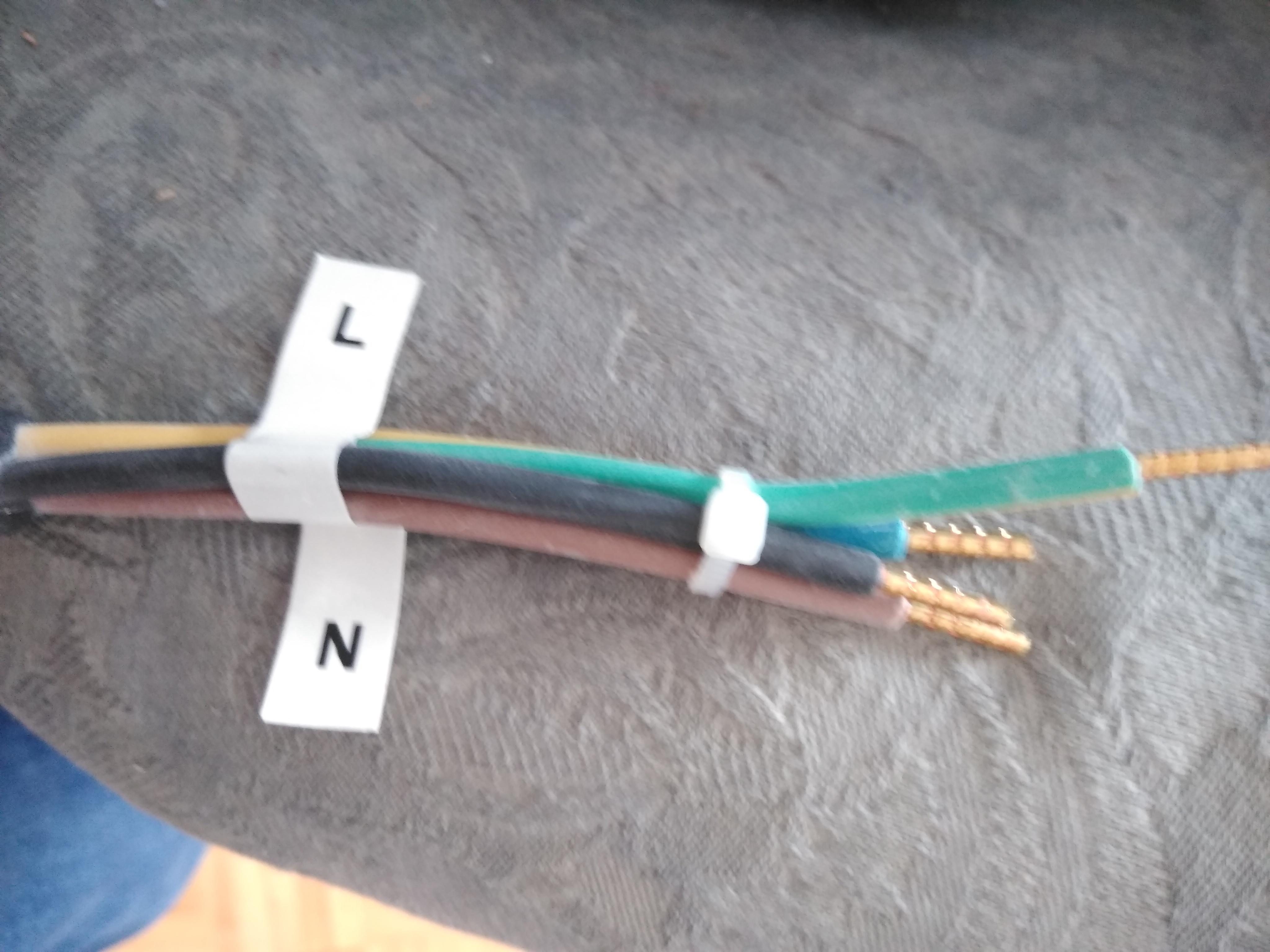

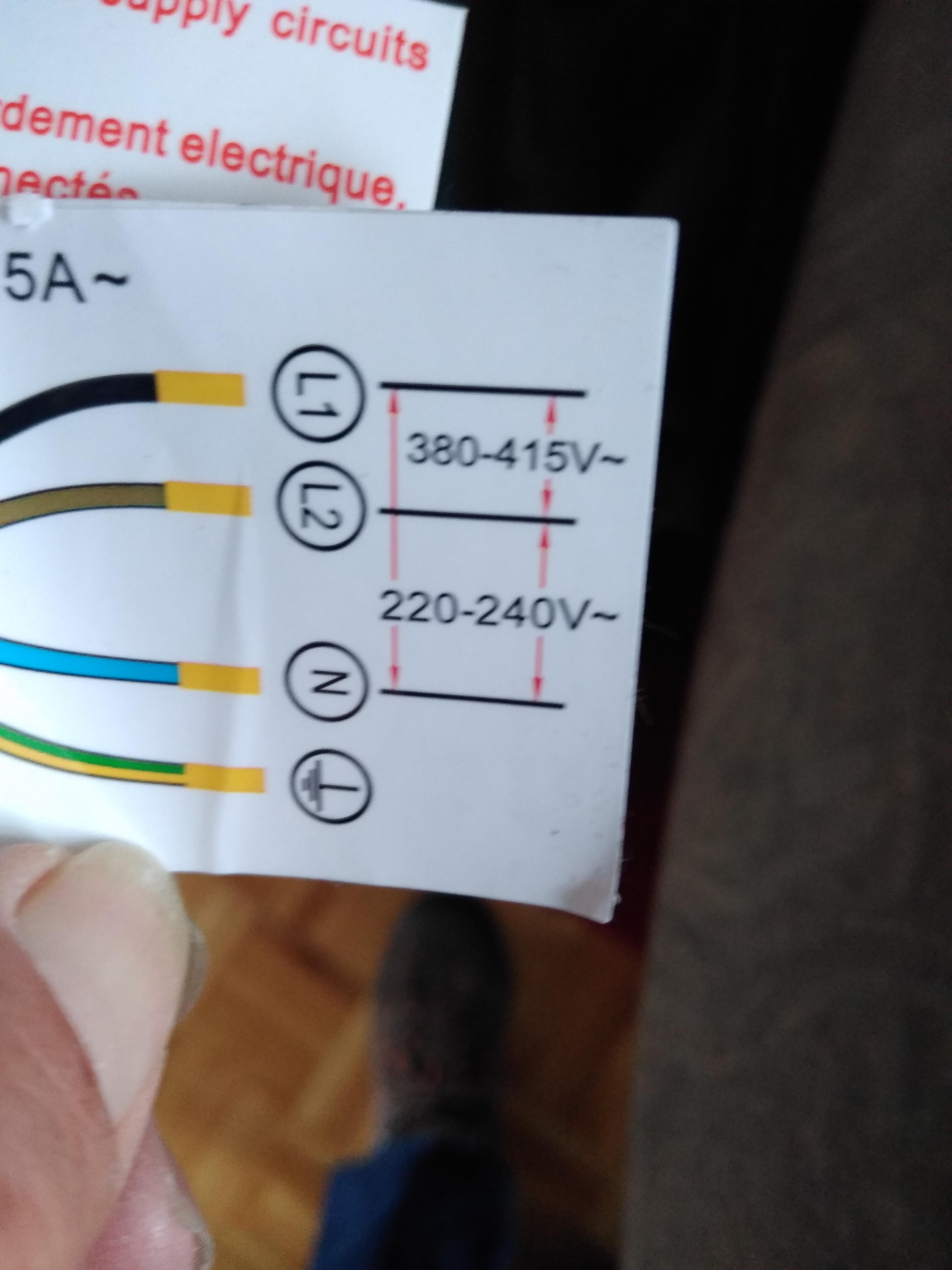

SteamyTea Posted September 28, 2020 Share Posted September 28, 2020 I can usually work these things out, but just to be on the safe side I want to double check before I pump 7kW into it. My new induction hob has 4 wires, blue for neutral, black and brown for live and an earth. The blue is labelled N, the black and brown are taped together and labelled L. But, in the wiring diagram it shows Black as L1 and Brown as L2. L1 is 380V to 415V, L2 is 220V to 240V. The instructions show only 3 wires on the diagram, with 220-240V between the L and N, but next to it it shows L1 and L2 connected together (and the neutrals). Now i think that L1 and L2 do need to be joined (so have ordered some Wago connectors). Does anyone think differently? Link to comment Share on other sites More sharing options...
ProDave Posted September 28, 2020 Share Posted September 28, 2020 What that is showing you is the brown and the black could be connected to two phases of a 3 phase supply, where there would indeed be 400V between L1 and L2 Assuming you only have single phase, then both Brown and Black go to L What matters is the voltage between L and N which would be 230 in any of those situations. I doubt you will need Wago's for this. Assuming you are terminating the cable into a cooker outlet plate, there is usually plenty of room to get both the brown and the black into the L terminal (except on some really rubbish CCU plates that have ridiculous terminals) Link to comment Share on other sites More sharing options...
