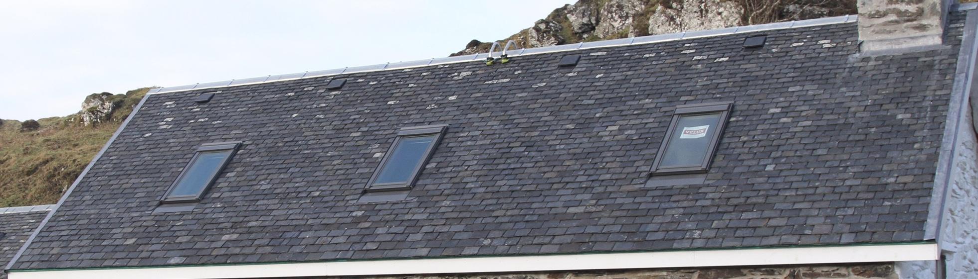

marsaday Posted September 18, 2020 Share Posted September 18, 2020 I am reroofing a pitch on a house i rent out. I am taking off the old tiles and will sell them. I am using spanish slate to replace. So i will fit 50mm insulation between the rafter and leave a 25mm air gap. Then fit tyvek supro breathing membrane, then lats, then tiles. Do i need to put some ventilation in ? If so do i do it across (from side to side), or from ridge to eaves. I am just not sure what to do. I will be reusing the current ridge tiles, but could buy 2 breathing ones, if this type of ventilation is needed. Link to comment Share on other sites More sharing options...
Russell griffiths Posted September 18, 2020 Share Posted September 18, 2020 Why are you fitting insulation between the rafters ? have you got a room in the roof. Link to comment Share on other sites More sharing options...
Cpd Posted September 18, 2020 Share Posted September 18, 2020 2 hours ago, Russell griffiths said: have you got a room in the roof. Is so 50mm between the rafters will be pitiful If that’s all there is going to be. When I did my roof I put 4 vents at the top where there was a big uninsulated area (Triangle ) below the ridge that all the rafters were open to (50mm air gap below the sarking and above the 190mm of insulation) and the vents worked well as I got lots of air movement up between the rafters in the gap. I also had soffit vents at the base of each rafter to help get air in. All in all it’s worked great and the roof is bone dry. Link to comment Share on other sites More sharing options...
marsaday Posted September 18, 2020 Author Share Posted September 18, 2020 Why ? Because there is a room in there. I have added 50mm 6 yrs ago on the underside of the old lath/plster ceiling. So now i'm doing the roof i want to add 50mm more. It would be more, but the rafter depth is 75mm, so i need to leave a 25mm air gap. Not ideal i know, but if i get some air vents in then it should be ok. Someone on facebook said to put 2 slate vents at the bottom and 2 at the top. Seems pretty straight forward to me. Link to comment Share on other sites More sharing options...
