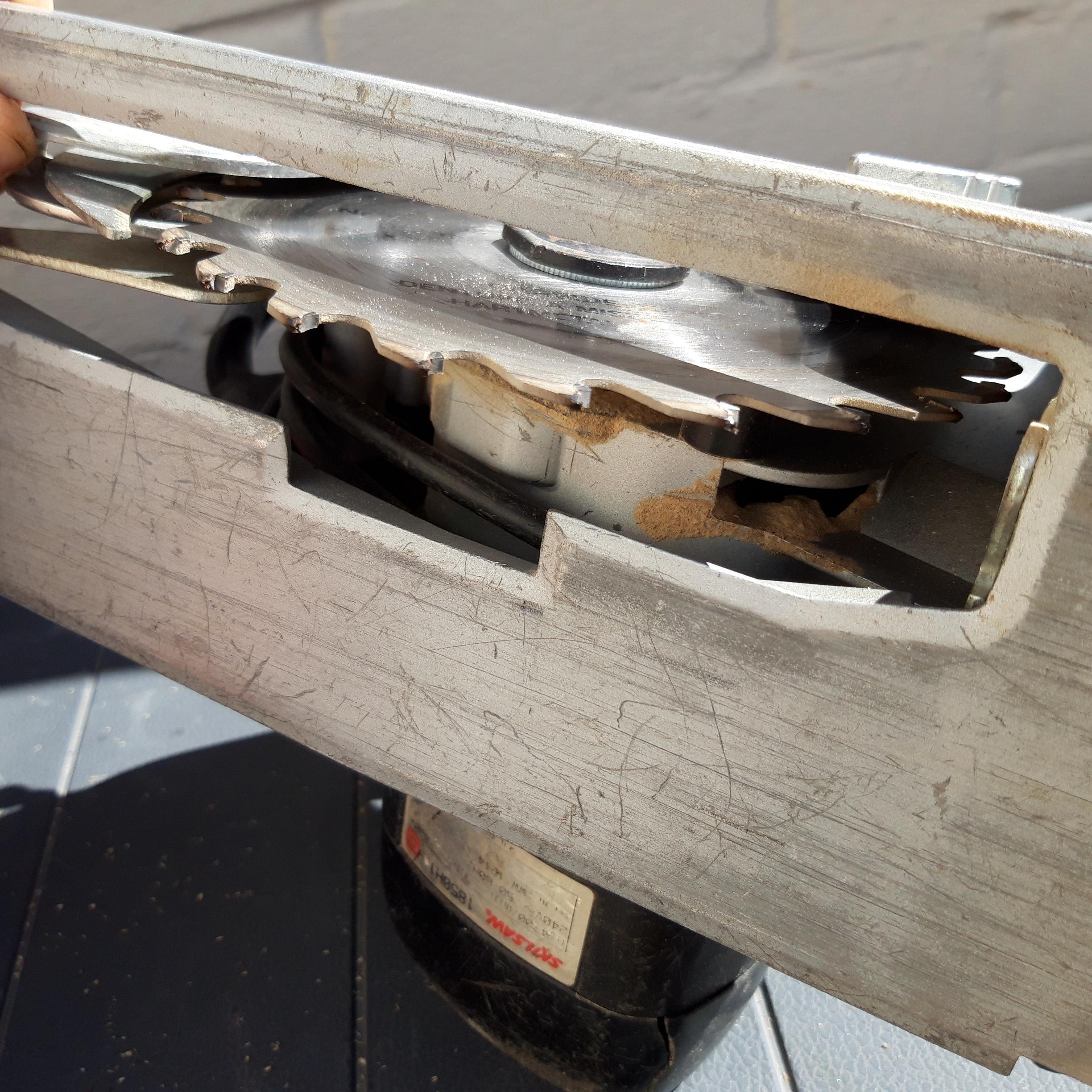

Onoff Posted September 6, 2020 Share Posted September 6, 2020 (edited) Just found that Skil (genuine) saw blades don't like decking screws! Mug that I am I'd brought the Evolution saw too. Can't decide on repair locally or replace... Edited September 6, 2020 by Onoff Link to comment Share on other sites More sharing options...
