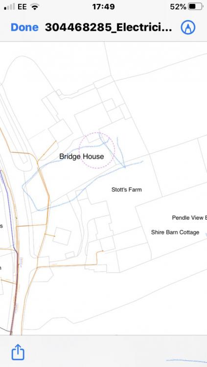

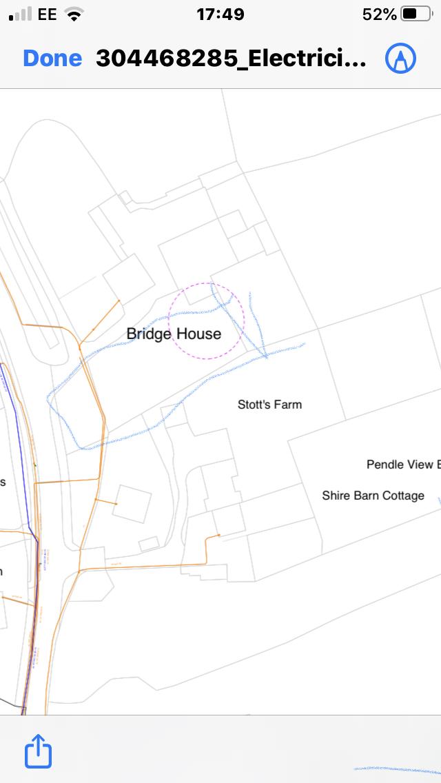

nod Posted September 3, 2020 Posted September 3, 2020 May be one for Peter W But feel free to chip in We have an electric supply running across the front garden of our prospective plot Quite away from the intended house But if we wanted to put a garage there What are our options The plot is outlined in blue next to Bridge House I will add the original
nod Posted September 3, 2020 Author Posted September 3, 2020 14 minutes ago, nod said: C 304468285_Electricity North West 2.pdf
PeterW Posted September 3, 2020 Posted September 3, 2020 Looks like a pair of LVs running across the front - build the garage first and put the meters in there would be my choice. 1
Onoff Posted September 3, 2020 Posted September 3, 2020 Get some nice pv on the garage roof if you align it South. 1
PeterW Posted September 3, 2020 Posted September 3, 2020 @nod looks like the gas main follows the pair of LVs too ? I would go for the garage first or at least put some sort of gates up and put the meter in the back of the wall.
nod Posted September 3, 2020 Author Posted September 3, 2020 21 minutes ago, Onoff said: Get some nice pv on the garage roof if you align it South. That’s my wife’s plan
nod Posted September 3, 2020 Author Posted September 3, 2020 26 minutes ago, PeterW said: Looks like a pair of LVs running across the front - build the garage first and put the meters in there would be my choice. Can the garage be built over the LVs Or will we have to work round them
PeterW Posted September 3, 2020 Posted September 3, 2020 No you will have to work round them - Western Power I think insist on 600mm clearance. I’d also get a cat scanner and double check where they are - probably find water is the opposite side of the road but the farm will have a decent 63mm main spur I expect so you may be able to tap that. 1
