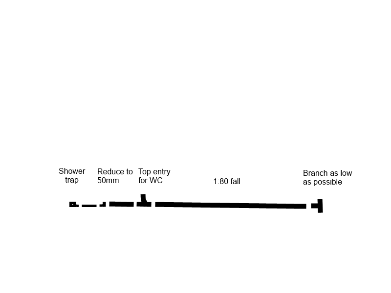

So here is a rough sketch layout of what I think you need. I would start by using this to work out the height that the shower ends up and that the WC connection is possible. If that doesn't work you will either need to dig a new drain or look at a macerator..
It should really be a Y-branch to promote flow towards the......
3 hours ago, calabash22 said:
(what is the technical term for this)
....."inspection chamber" aka manhole.
The difficulty may be getting a Y-branch in and the subsequent 135 degree single socket bend then required to rectify back to vertical to accept the WC connection.
