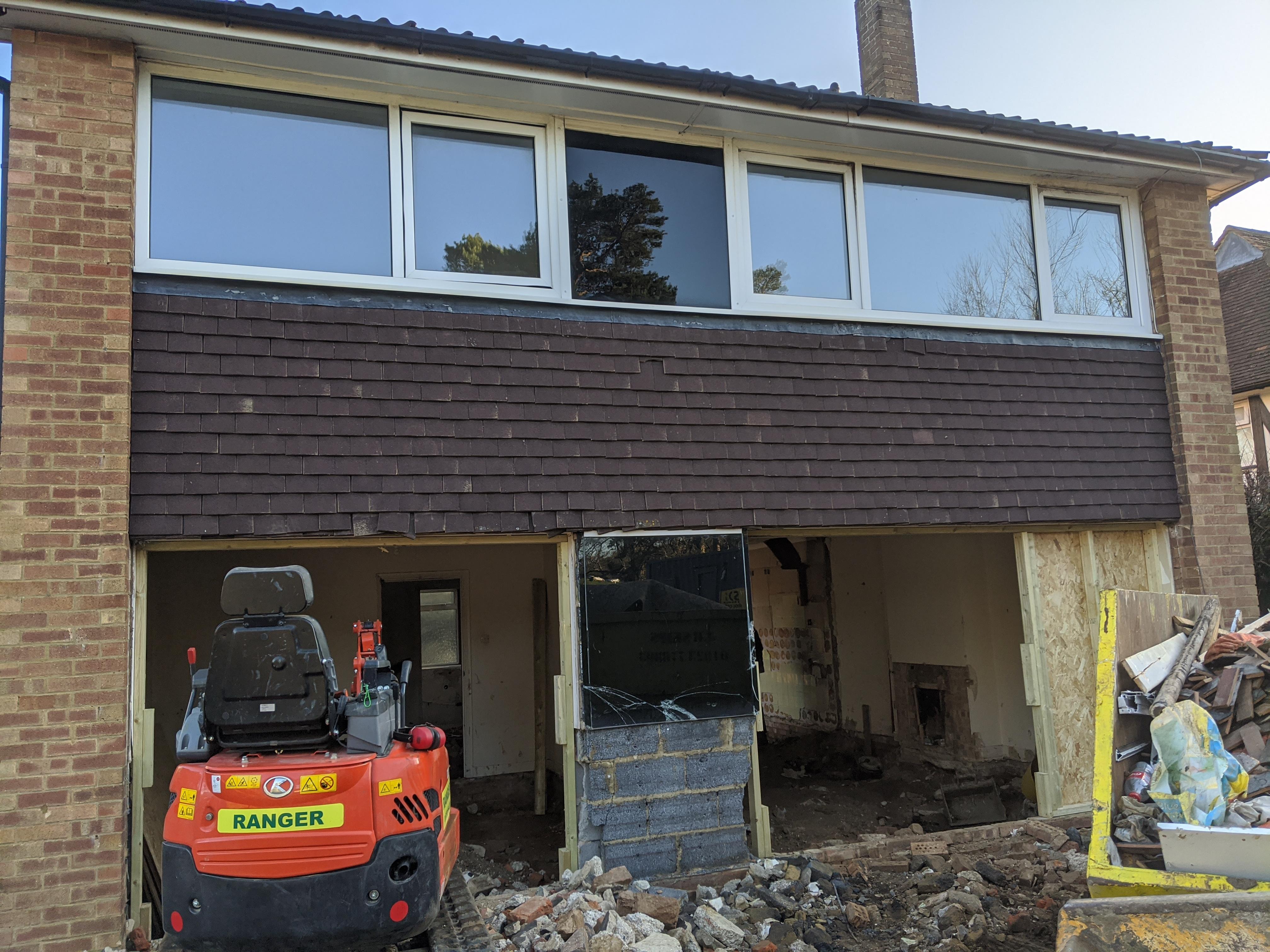

The old house is 60s cross wall construction and we've demolished and rebuilt both the curtain walls in timber, so it's only the supporting flank walls that remain as B&B. I really hope this won't make insurance a nightmare!!

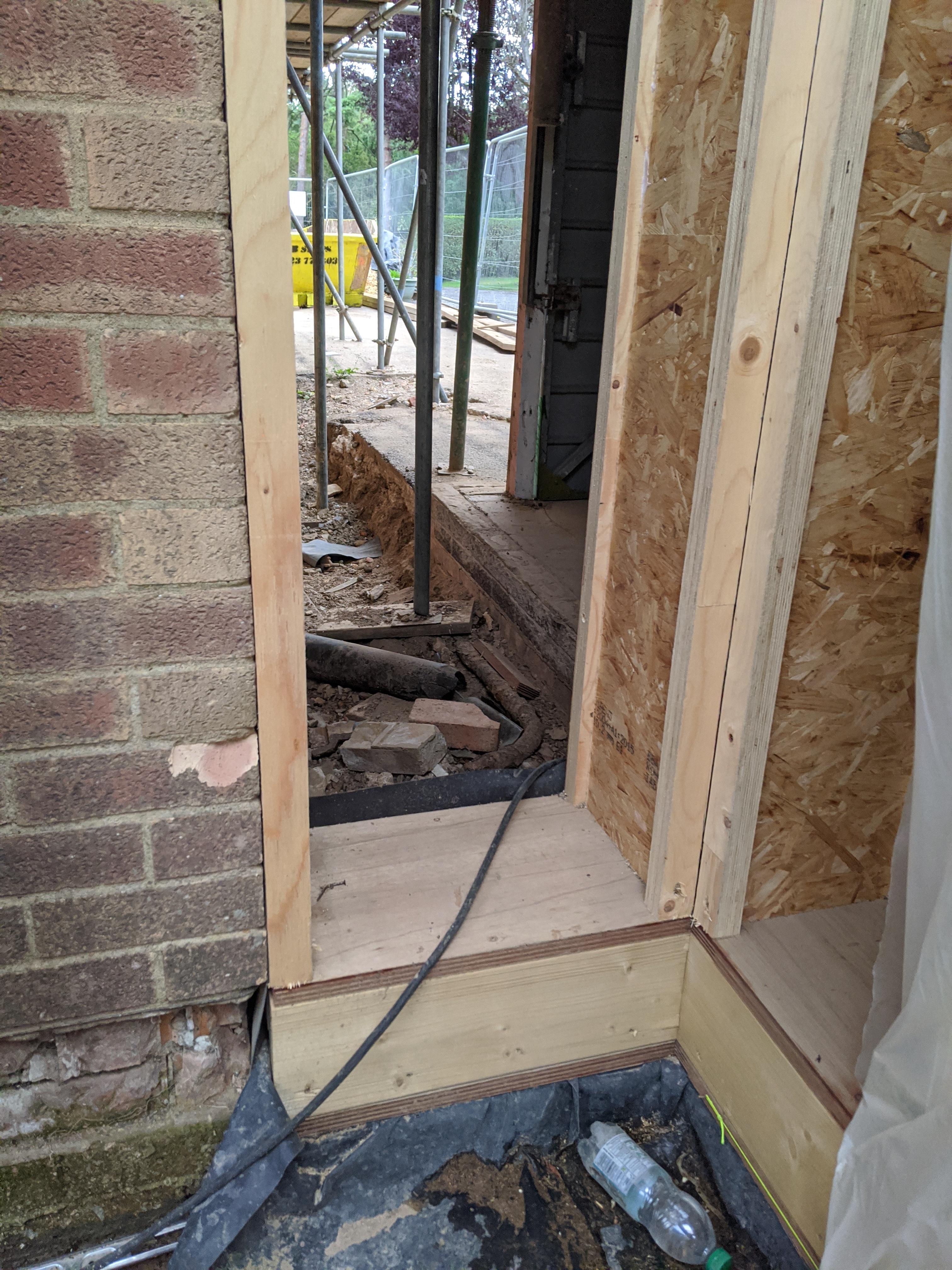

Can share some example photos of the junction details if you're interested

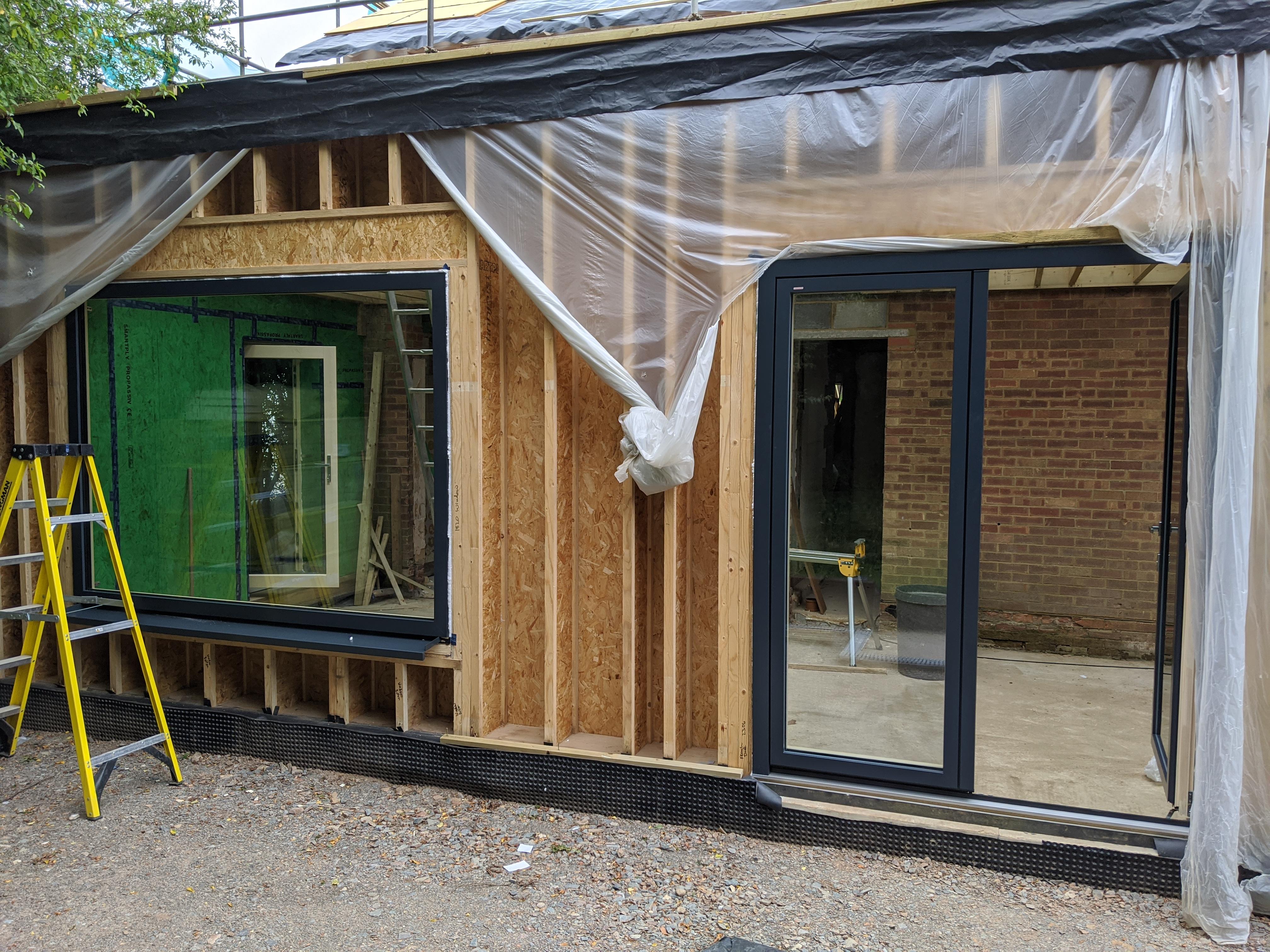

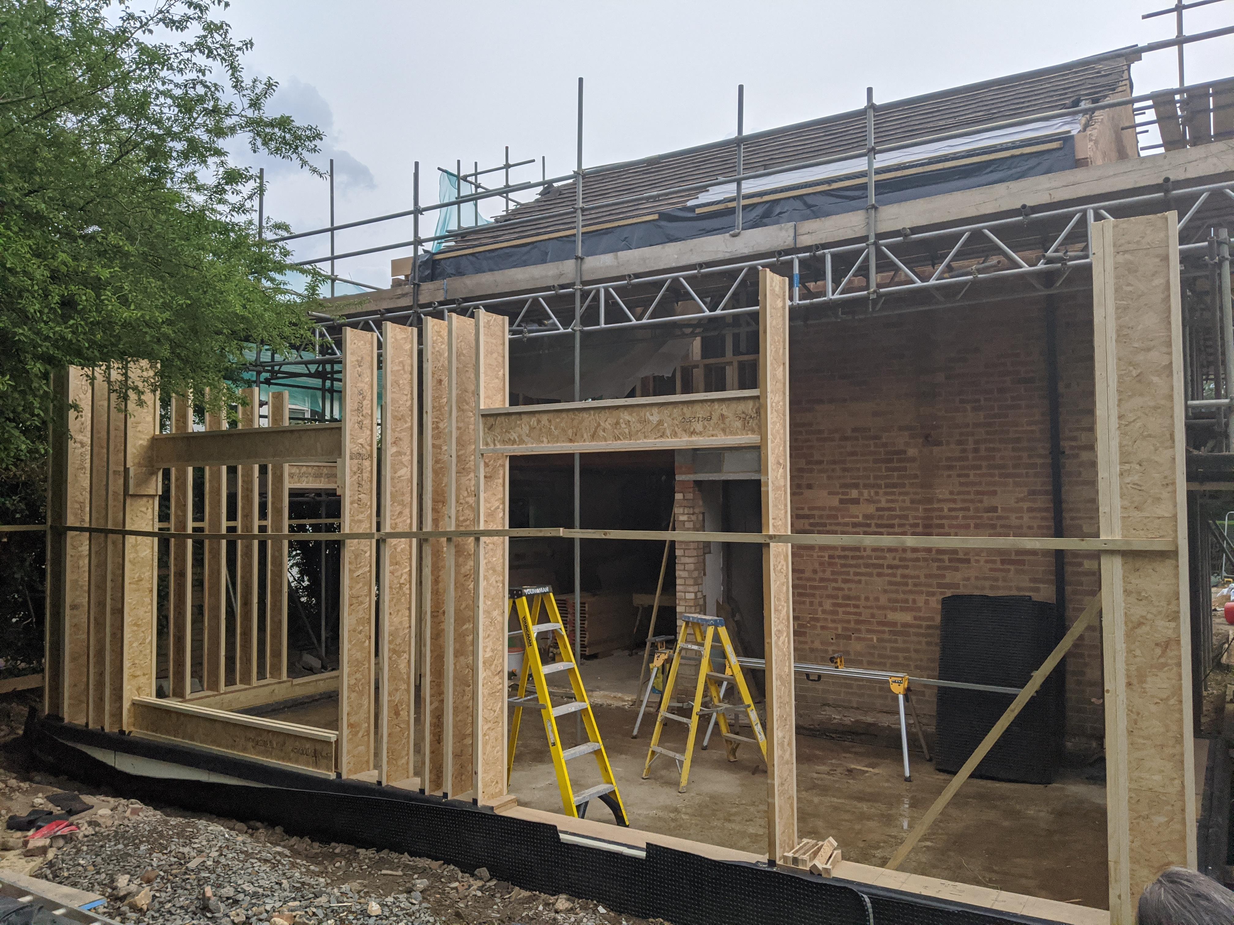

Here's the extension frame going up, and now with windows installed and getting close to ready for warmcell, plus a close up of where the new extension frame meets existing cavity wall.

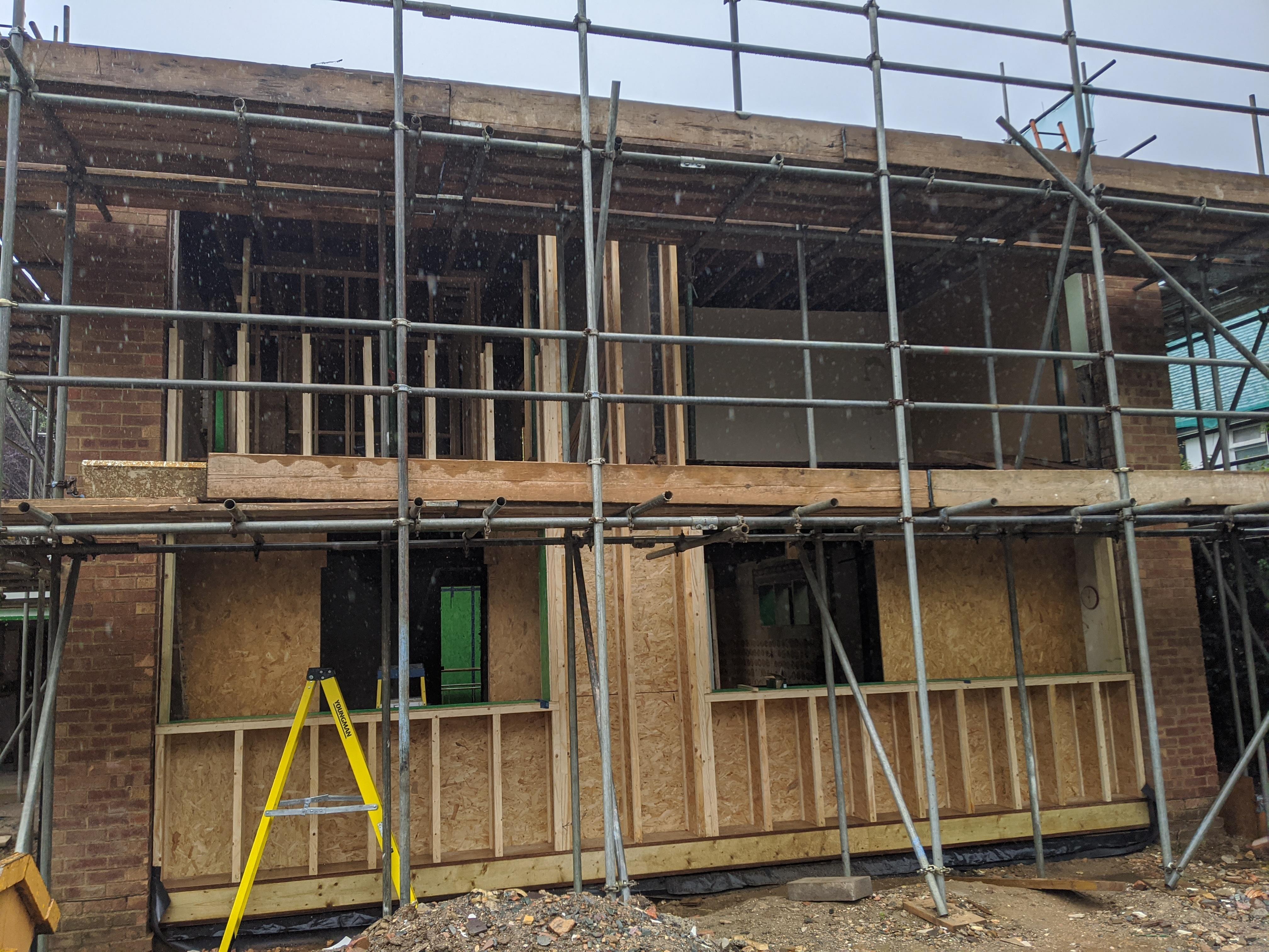

Here's the front curtain wall mid-demolition, and post demolition with bottom half rebuilt
As you see, the main structural component front and rear is 300mm I joists
