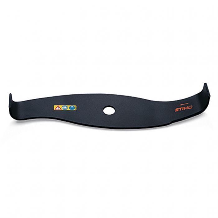

Onoff Posted June 3, 2020 Posted June 3, 2020 Morning, I'm debating this Einhell 36V brush cutter: https://www.amazon.de/Einhell-Schnittbreite-Front-Motor-Tippautomatik-3-Zahn-Messer/dp/B078GRBYSP/ref=mp_s_a_1_13? 1) I could do with one for occasional use. 2) I can use Makita batteries on it. 3) It's half the price of a Makita one. Cheaper too buying it from Germany. I saved a good few quid like this buying the 36V chainsaw from Amazon.de In the German to English translation it states: "Thread spool and 3-tooth knife, without battery and charger)" Then it lists a 255 bush blade for an extra €19.99. Are they much different in terms if what they can do as opposed to the "3 tooth knife" it comes with? I'm guessing it's pretty much like a circular saw blade for sawing rather than "weed whacking". That it's 25.4mm bore and 2.5mm thick, could a "standard" circular saw blade be substituted? Not had much experience of these "brush cutter" type things. Limited to cheapo mains strimmers in the past. Cheers
Miek Posted June 3, 2020 Posted June 3, 2020 What kind of vegetation are you hoping to cut? Brambles need a curved blade so you can push the tool down on them from above. Straight blades only work in the horizontal but are good for lower vegetation.
Miek Posted June 3, 2020 Posted June 3, 2020 That pic is a Stihl shredder blade and will cut most things, but I use it on a 45cc motor , I don't think it will be very useful on a cordless tool.
