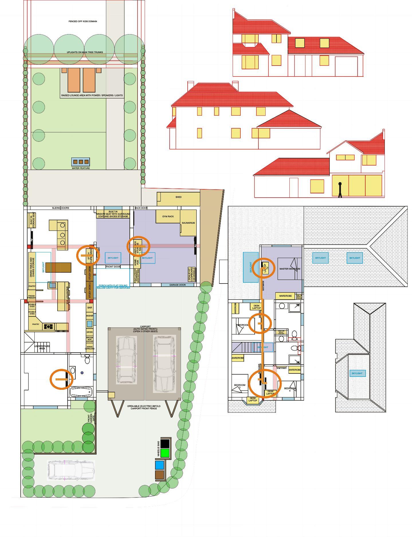

In another thread I got good feedback regarding the value of provisioning for active cooling in our full house refurb.
My hope is that we don't need it.  We plan 35m2 glazing for our total floor area 180m2, 2 story house, 1930 semi detached house, with 4 additional skylights (probably with built in low solar gain finish).  The back garden is approx North facing, so the main sliders shouldn't be problematic for solar gain.  Also likely to get EWI for our solid block walls.  Solar panels are hopefully in our future to generate and also reduce solar gain through the roof.  Still, I like the idea that we have a solution should the house overheat during warm spells, if the planned MVHR isn't able to do very much for cooling.
It seems like the ideal would mean provisioning for:
- all 4 bedrooms,
- the snug at the front of the house,
- the main seating at the rear, and
- the garage (will be a play area primarily, within the thermal envelope of the house).
That seems like at least 7 splits.  I have shown my attempt at these locations on the attached house plan, using the orange lines (and circles to help make more obvious).  I guess the pipe run would go centrally down the middle of the house, through the joists between the ground and 1st floor.  That seems like it would service the upstairs and snug really well, with a lateral runs needed to get to the garage.  Would anyone position the indoor units differently, to perhaps require fewer units, and/or be more effective?  FYI the house length (north to south) is approx 17m.
Then there is the outdoor unit(s).  Related to how many internal units are needed, will be how many external.  Multi splits typically go up to 5.  And where would I locate these 1 or 2 outdoor units?  We are a semi detached, and a corner plot, where a neighbour front garden is north of our garage.  It feels like the most convenient place for the run would be on the flat roof outside bedroom 2 so to limit the run lengths.  But that will be close to my adjoining neighbour bedroom (attached by our West wall).  Alternatives seem to be:
- the back of the house (i.e. the north of the property) at ground level, but given the vaulted garage and entrance ceilings, it means for long and not simple runs.
- the front of the house, where the bathroom steps back from the snugs principal elevation, but even if hidden by fencing, could draw attention from the street users.
I'm wary of the requirement for planning permission for cool-able units.  We don't live in a conservation area, but the threat of needing an expensive acoustic report and likely neighbour objections looms (especially for multiple outdoor units, if needed).  Still I feel I would sleep better through the build knowing the wiring and pipework (or just ducting) is in place to fit should the house suffer from hot weather overheating.
FYI purple rooms indicate vaulted ceilings in those rooms.
Semi transparent wide red lines indicate structural steels.
My sincerest thanks for any assistance

Can I ask this again to the forum, as I am undecided as to what would be the best arrangement for either a single 3-way or single 4-way multi split to service the whole house.
My current thoughts are to have a 4-way, with 3 units downstairs, one upstairs.
The one upstairs would probably be best placed above the shower room door as you emerge at the top of the stair well.  Presumably the indoor unit can oscillate the air left to right to find it's way into the 4 bedrooms from there?
Then downstairs, similar to where I marked previously, probably one in the snug at the front (south facing) room, one in the main living area near the kitchen, and for the third, rather than being in the gym / playroom / garage, maybe have in the porch / reception hallway, again hoping it can oscillate the air between the garage and open plan living area.
Would anyone think this is a sensible arrangement?  What would you do differently?  Would you provision for a second unit to better cover the home volume (200m2 / 500m3)?  I liked the idea of just one external unit which can provide heating (heat pump), so that I don't need planning permission.

Thanks @SteamyTea, I will attempt those calcs today.  I had hoped based on some anecdotal accounts from users here that any amount of cooling, especially in high places, had a profound impact on the house temperature, more so than expected.  Sounds like a calculations approach is needed.
Also, as of earlier this morning I restarted this post in the ASHP forum, I didn't know there was one for ASHP when I posted this originally.  Happy for either to be removed if causing unnecessary clutter.
Edited by tanneja
Sorry to ask, but could you lead my thoughts on the bits I am unsure of?  I presume temperature difference of 8 deg is the most one would want to realistically achieve (i.e. 33C outside, wanting 25C inside)?  Is there a sensible airloss and SG based on the information
Does the resulting W value then tell me the cooling requirement I need from the ASHP?
