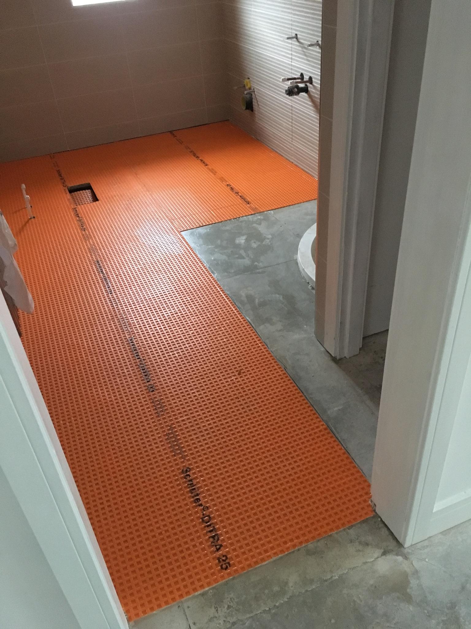

jamieled Posted June 1, 2020 Share Posted June 1, 2020 Despite extensive reading on here and elsewhere, I'm a bit unclear as to whether it is sensible to tile my bathroom floor directly onto the chipboard. Floor is 22mm caberdek glued and screwed to wide posi joists. No noticeable movement in the floor. If this is a bad idea, what do I need to do? Would like to avoid adding ply if possible. Link to comment Share on other sites More sharing options...
nod Posted June 1, 2020 Share Posted June 1, 2020 Short answer is No You can use Ply cement board I always use Ditra matting Stuck down with Ardex adhesive Tile same day 1 Link to comment Share on other sites More sharing options...

CC45 Posted June 1, 2020 Share Posted June 1, 2020 We did as per @nod - bomb proof. Glue (Ardex AF200 I think) is sticky as hell. You need a 3mm tiling trowed to put it down. Link to comment Share on other sites More sharing options...
