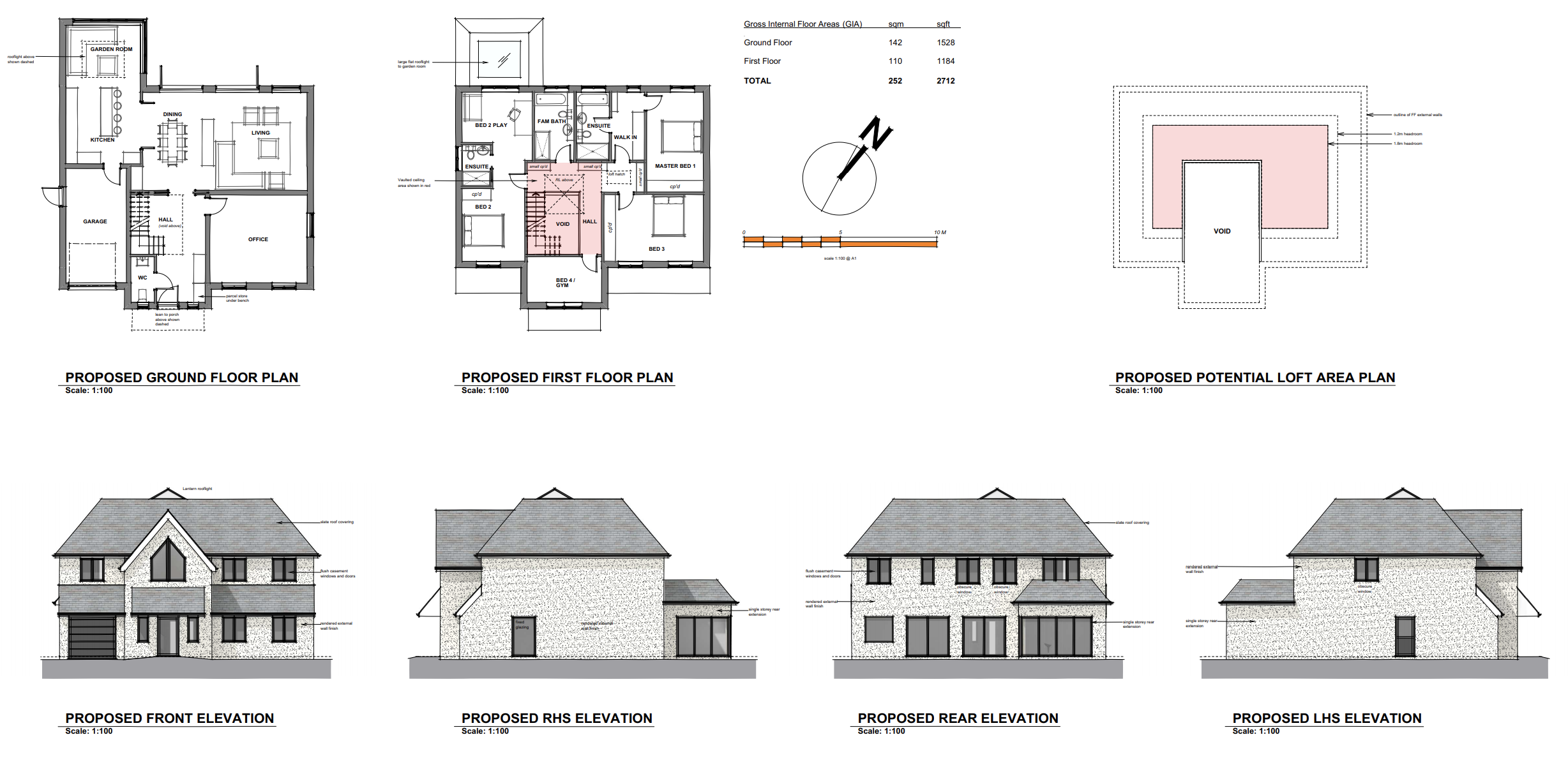

Your architect must have produced a workable section in order for the elevations to have been produced? The section would show the exact build up of all the various elements... their structure, insulation and internal finishes. This would really start putting a perspective on how much space you have, in particular at second floor/loft level.
I assume the cross sections you’ve provided are as you said just generic ones with the software you’re using as the floor to ceiling heights, first and second floor thicknesses along with roof build up do not appear to be relatable or feasible?
In terms of the roof structure, your two options would be cranked steels with cut timbers (First image) or attic trusses (Second image). Whichever option you/the architect/the engineer go with, the rafters would more than likely be 220-225mm deep, which excludes any insulation required to the underside.
Very useful info, thank you!
I'll take a look, see the picture below too - I suspect the idea is indeed the attic trusses.

The sections you have do not seem correct.
Yup, I think I've thoroughly confused the program with my random tinkering which therefore refuses to render a sensible roof. But an older version of the architect's doc:
1057770154_Screenshot2020-05-24at18_38_35.thumb.png.183bf0575be67a4e30ce4798c5f6b0a7.png
Seems to show one room's worth of space. Not 'ample' anyway.

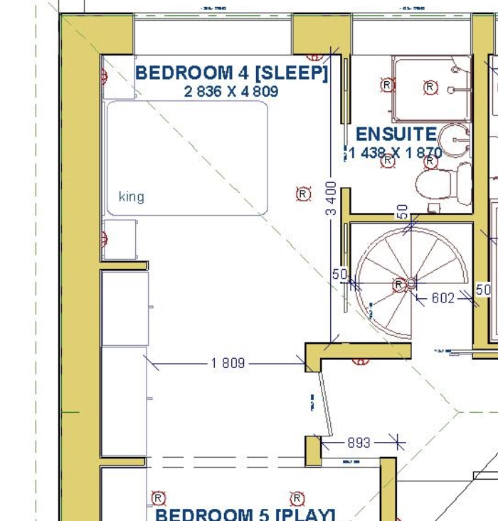

It doesn’t look like the door from the Landing to Bed 4 will work, unless you don’t mind the corner of the door being chamfered to suit the roof profile of the front gable?
I'm not sure what you mean. Looking at this picture:
I think the door you mean is the ... eh I keep on hesitating, so many doors, but the chamfering I can only imagine happening in the loft, not in bedroom 4?
I *think* you mean the door in the loft, which presumably will exit close to the roof? Doesn't that also depend on the total ceiling height and where the spiral exits (function of # of steps? ceiling height?) Or is it always a full turn regardless of how high?

Posted
I was referring to the front Bedroom (within the projecting part). The plan attached a couple of posts up noted this as Bedroom 4 but your latest extract shows Bedroom 4 in the top left. What’s the latest plan for the front part of the house, in particular the first floor?

Posted
