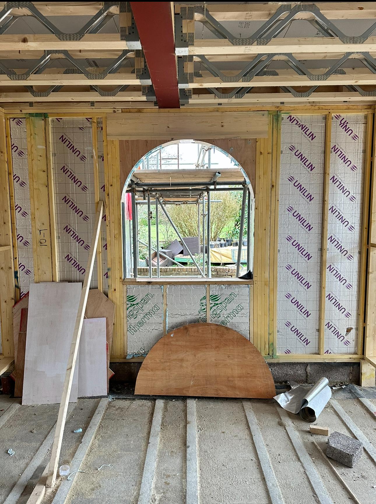

Just sorting through some bits and realised I have yet to work out how to close the cavity around an arched window that is due to be installed. The rest of the windows have 50mm timber battens, offset slightly so I can stick some insulation in.
Has anyone here installed an arched window in a TF? If so how did you close the cavity over the arched part and also how did you go about installing a cavity tray? I have a lintel on order but the rest I'm not to sure yet.

facetted approach might be easiest then arch former over the top after plasterboard, after insulation and mitigation of thermal bridging
Is this the inside or the outside?
For the inside presumably one could use the bendy plasterboard - ie with the slotted back, or an alternative.

Hi @LA3222, how did you conclude your arched window cavity issue?
I have the same problem to overcome!  BC are saying I need an arched cavity lintel which is proving hard to source!
@Mikey iirc i ordered all of my lintels from london lintels - will have to check. Catnic do bespoke lintels, I told londonlintels what I wanted and they ordered from catnic. Catnic did a drawing and sent it through for me to sign off on pre manufacture. I've attached what they did for me.
