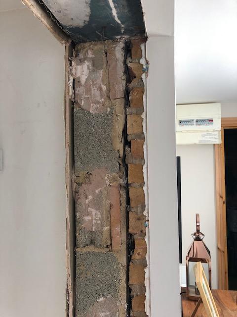

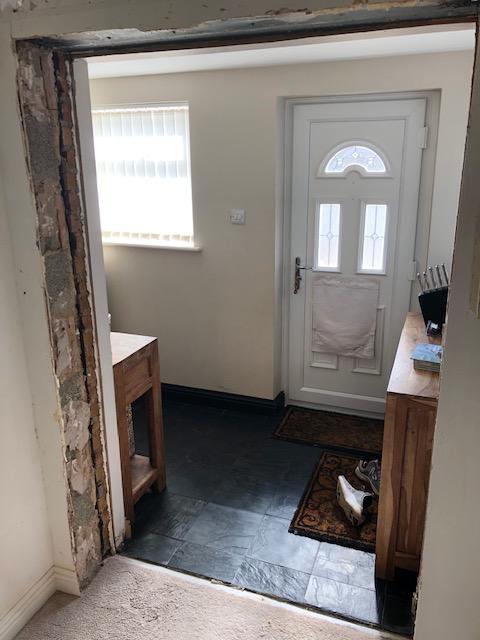

clickclick23 Posted May 11, 2020 Share Posted May 11, 2020 Hello. I've removed an internal UPVC door that separates the house from the porch (see photos). I understand that if I want to leave this open, then I need to insulate the single skinned porch, in accordance with building regs. My question...will fitting insulated plasterboard over the existing dot and dab satisfy the regulations, or will I have to remove the existing boards, batten and insulate, then re-board? Look forward to hearing from you. Best wishes, Chris Link to comment Share on other sites More sharing options...
Crofter Posted May 11, 2020 Share Posted May 11, 2020 Hard to tell from the photos, but does the current wall buildup have any sort of vapour barrier? Assuming it does, my concern would be that simply adding extra insulation on top of what's there would lead to condensation forming behind the dot and dab PB, and you can't add a vapour barrier on the inside of the new insulation because that would make a sandwich, trapping moisture. However if there is no vapour barrier in the existing walls, then possibly you could insulate on the inside of them. I presume you intend to dot and dab a second layer of insulated PB. There might be a limit as to how much weight/thickness you can hang off the previous dot and dab layer. Link to comment Share on other sites More sharing options...
bassanclan Posted May 11, 2020 Share Posted May 11, 2020 This will be classed as an extension to your habitable space, so you need a U value of 0.28 to meet minimum building regs. Or an R value of 3.6. Your single skin brick has an R value of around 0.44 so you will need an R value of around 3.16 for your insulated plasterboard. This means you need a minimum 70+12.5mm insulated celotex/kingspan plasterboard. Have you considered putting a second skin around it or external wall insulation? Link to comment Share on other sites More sharing options...
