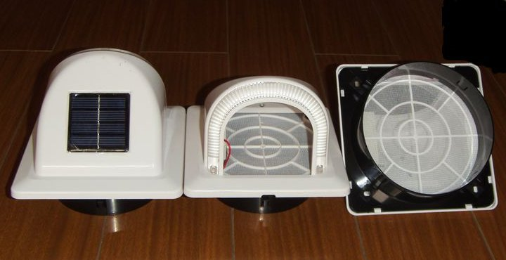

Jeremy Harris Posted April 26, 2020 Share Posted April 26, 2020 You're not looking at anything massive to run a ventilation fan, though: http://www.cpssolar.co.uk/Solar-Ventilation Could be stand-alone, with a built-in solar panel, if a 160mm fan will fit OK: 1 Link to comment Share on other sites More sharing options...

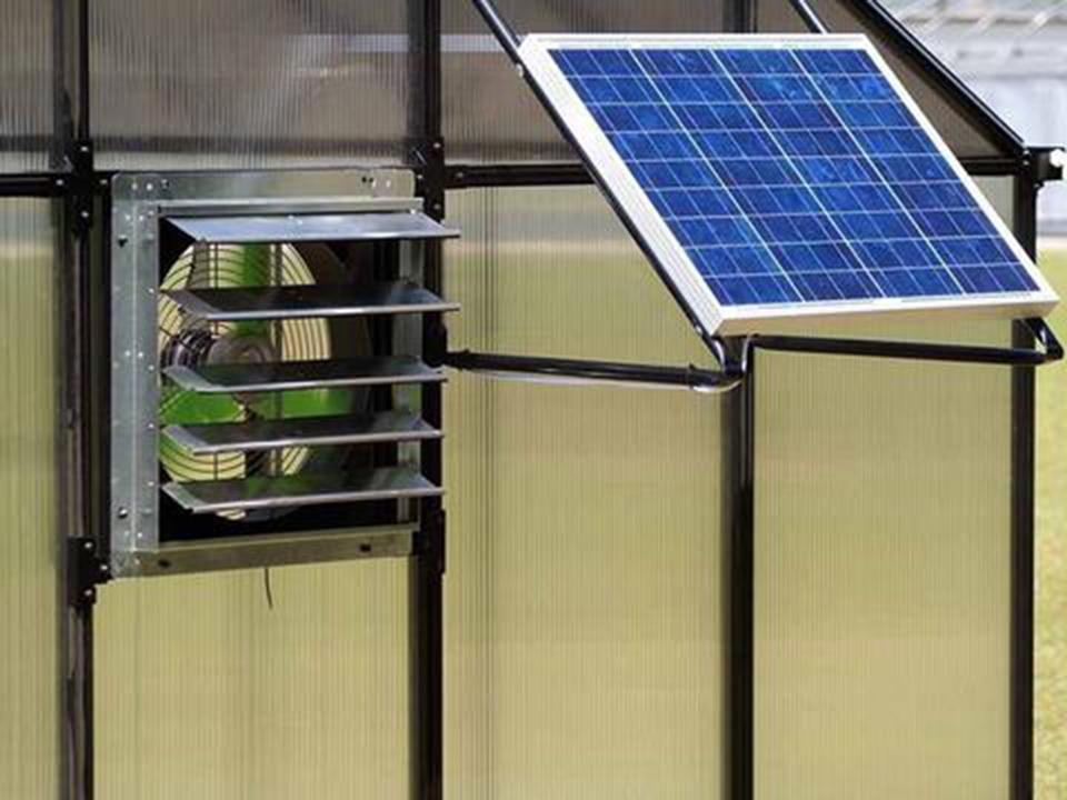

Jeremy Harris Posted April 26, 2020 Share Posted April 26, 2020 1 minute ago, vivienz said: Thanks, Jeremy, that looks good. Off to investigate. There are probably a lot more choices around, including some smart solar powered fans with controllers made specifically for greenhouses, like this one (probably expensive though): Link to comment Share on other sites More sharing options...
