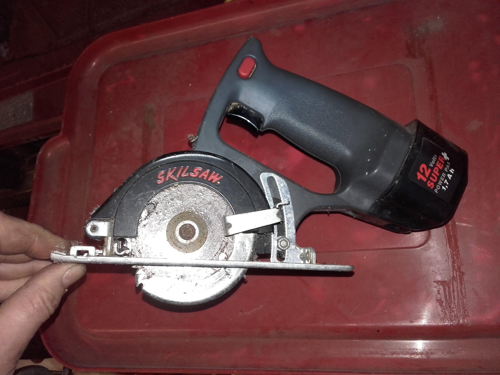

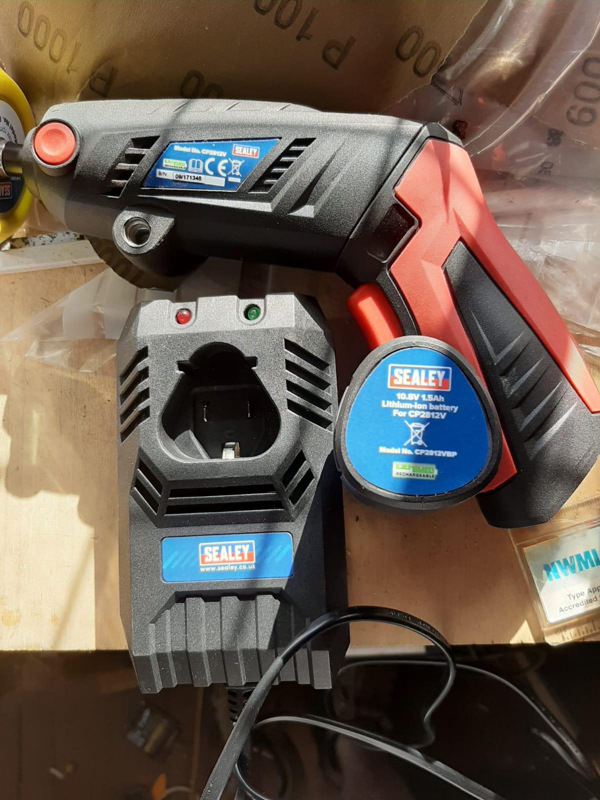

Onoff Posted April 26, 2020 Posted April 26, 2020 My brother has a Sealey 12V polisher but it comes with a 10.8V Li-ion battery? What's that all about then as in 10.8 / 12V? I'm thinking to 3D print an adapter so he can use the Sealey battery on this old 12V Skilsaw I got given with a dead battery and no charger.

Onoff Posted April 26, 2020 Author Posted April 26, 2020 16 minutes ago, AnonymousBosch said: Here's the Bosch version of the same issue. Thanks. So the 3 cell battery is 3x3.6V=10.8V but the peak voltage is 12V. Much in the same way the 5 cell ones are 5x3.6V=18V but some drills quote the peak like Parkside, Ferrex etc.

Jeremy Harris Posted April 26, 2020 Posted April 26, 2020 The reality is that the pack voltage is usually something rather different to the label voltage. Just poked a meter on a Makita "18 V" BL1830 pack that hasn't been charged for several months. It read 20.03 V.
SteamyTea Posted April 26, 2020 Posted April 26, 2020 (edited) Is there a difference in measuring, one voltage with no load, another voltage when fully loaded. Or just a rounding thing for marketing. I am 5' 5 1/12" When you get close to a half, you round up, so I am 6'. (also West Indian and very strong for special online marketing purposes) Edited April 26, 2020 by SteamyTea
Jeremy Harris Posted April 26, 2020 Posted April 26, 2020 8 minutes ago, SteamyTea said: Is there a difference in measuring, one voltage with no load, another voltage when fully loaded. Or just a rounding thing for marketing. I am 5' 5 1/12" When you get close to a half, you round up, so I am 6'. (also West Indian and very strong for special online marketing purposes) I think it just relates to the different way manufacturers label the nominal voltage of lithium ion cells. Most use either 3.6 V per cell or 3.7 V per cell, but a fully charged cell will usually be around 4.1 V to 4.2 V, and a discharged cell can be as low as about 3.2 V to 3.4 V. In practice, most lithium cells seems to sit at around 3.8 V to 4 V per cell when reasonably well charged, so pack voltages are often higher than the nominal voltage on the label.
