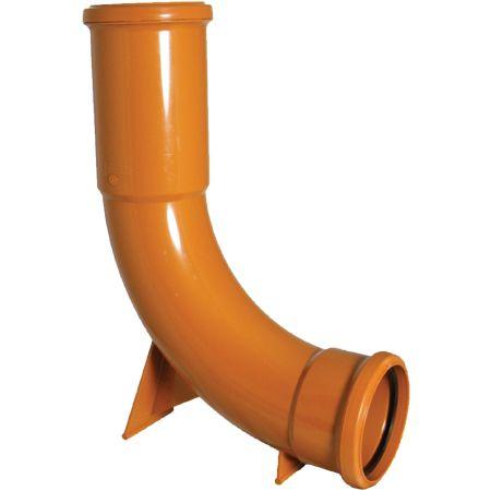

Extended Rest Bends: when to use .... ?

I'm wondering what the criteria for use is?
Is it simply to increase the reach of the bend, or might one be used when there's an increased likelihood of differential ground movement?
Our land profile near to the raft is MOT1 on top of topsoil, and that's on clay. The foul drain comes out of that 'mix' and  then descends steeply (it drops about 2 meters) through more topsoil and then into wetter clay. And straight into the digester.
All of the pipe is at least 1 meter (usually more) below the ground surface.
I'm overthinking it aren't I?
PS, MOT1 is the worst , the very worst stuff to dig through by hand innit? Gimme clay any day.
Think it's for where the vertical leg might move relative to the drain run in the ground, so a tall stack subject to thermal movement, or as you say ground likely to move settle.
However if the vertical pipe is not secure or it is bottomed out in the joint to start with then it could well be a wasted excercise
Thanks. There's little to be lost by fitting one at the bottom of the vertical run  is there? And it would be a right royal pain in the Botticelli to have to replace a normal rest bend for an extended one .

Local BCO doesn't even require *normal*  rest bends never mind extended. Bog-standard 90 at the base, round these parts...
