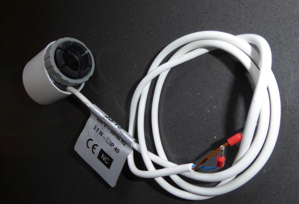

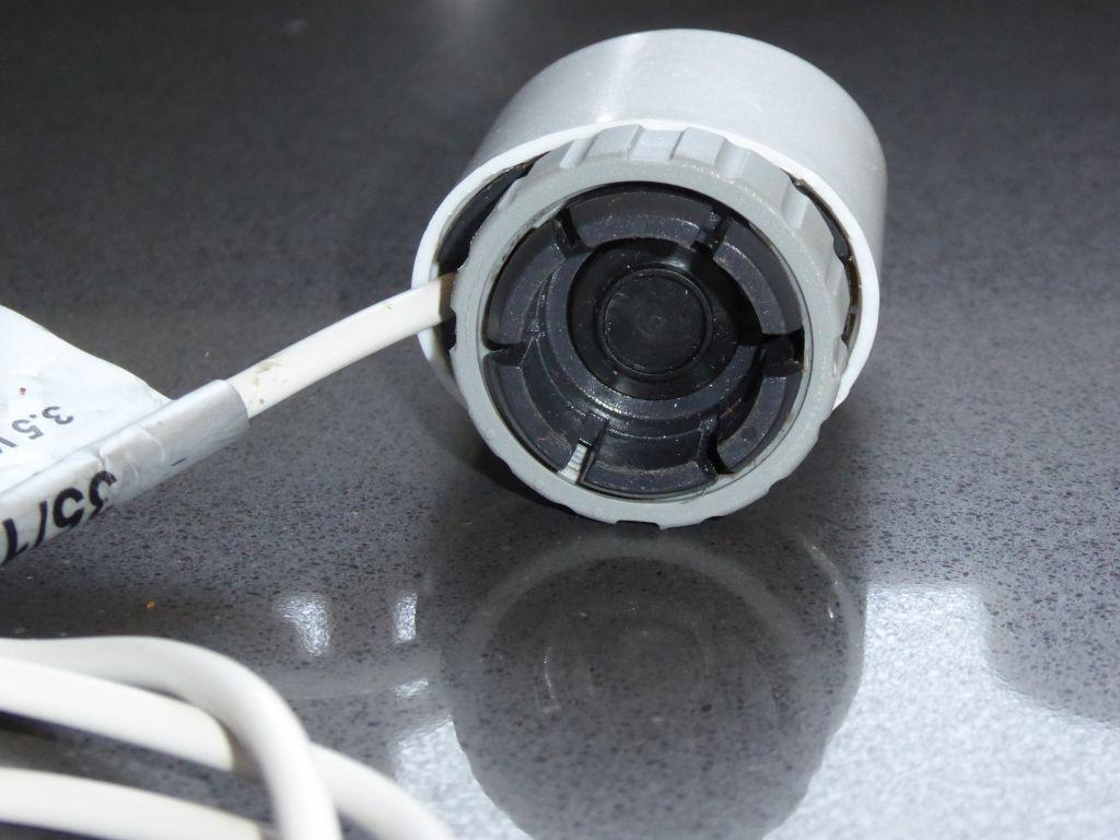

Jeremy Harris Posted April 9, 2020 Posted April 9, 2020 Here's a couple of photos of a typical UFH wax operated actuator. This one has a 3.5 W heating element that takes around 5 minutes to fully open the valve:
SteamyTea Posted April 9, 2020 Posted April 9, 2020 (edited) 9 minutes ago, Jeremy Harris said: Here's a couple of photos of a typical UFH wax operated actuator. This one has a 3.5 W heating element that takes around 5 minutes to fully open the valve: So 3.5 [W] x (5 [min] x 60 ) = 1050 Ws = 0.00029166666666667 kWh Don't seem to so bad when preceded with lots of zeros. Edited April 9, 2020 by SteamyTea
