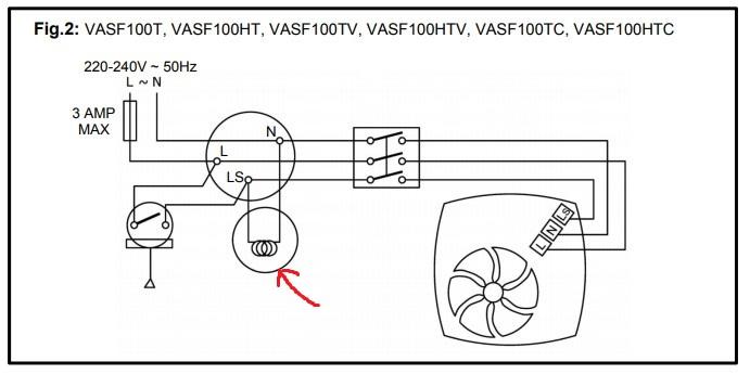

mike2016 Posted April 2, 2020 Posted April 2, 2020 Hi, I'm planning to replace a Bathroom fan that is tied into the light switch with a Vent Axia VASF100HTV. I want to break it away from the light switch as I use a different set of lights 99% of the time. The installation diagram shows something between the switched live and neutral. I'll get a separate pull cord and fan isolator for the project but what is the purpose of the arrowed item? Thanks!
ProDave Posted April 2, 2020 Posted April 2, 2020 That is the symbol for the bathroom light fitting, so when you turn on the switch the light comes on and the fan starts, That is showing a "loop at light" wiring configuration.
mike2016 Posted April 2, 2020 Author Posted April 2, 2020 Ahaa!! that makes sense now and very obvious once you called it out!!! Thanks!!
