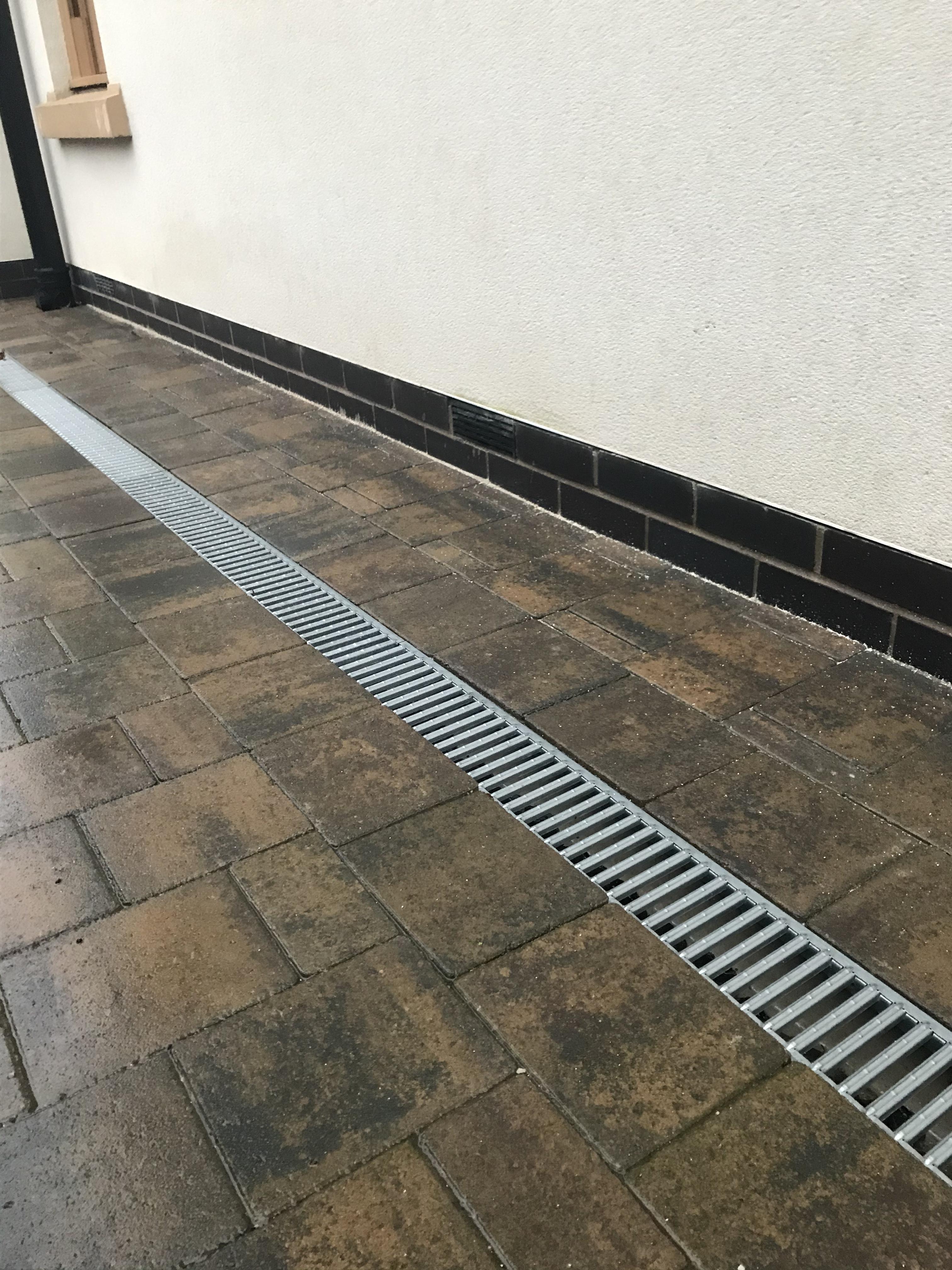

nod Posted March 17, 2020 Posted March 17, 2020 You could add a fully drain around the extension Very small cost involved 1
DarrenF1970 Posted March 17, 2020 Author Posted March 17, 2020 That drainage does look very neat, I like it. Are they likely to take that into consideration against the other more extreme proposals then? Thanks
