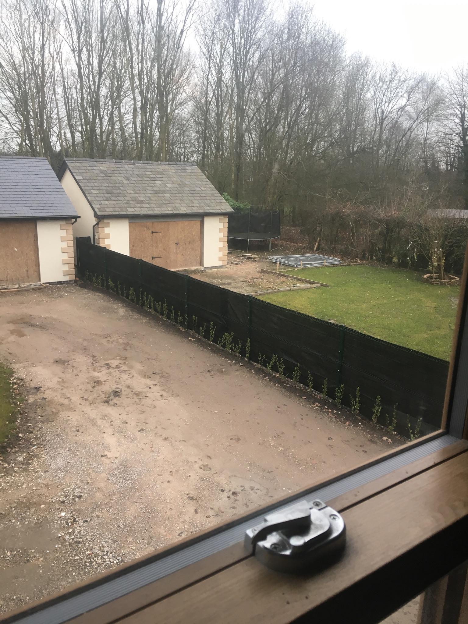

Carrerahill Posted March 16, 2020 Posted March 16, 2020 3 hours ago, deuce22 said: Hi. I understand how a cavity wall construction is built at floor level, but I'm unfamiliar with a single skin construction. My last garage (that was built by a bricklayer) was single skin and after a few years (after cracks appearing in the render) I started getting water come in where the DPC met the concrete floor. Is there a way to stop this on a single skin wall? Thanks. You need to run the covering be it cladding, render, wet dash, dry dash etc. down past the slab basically. Our garage is is about 1/2 done in dub coat (base coat) of a dry dash system, those walls are bone dry to about the bellcast, then the walls get damp in the rain, however, I will be using a smooth finish from the ground up to the bellcast and this will run over the bottom block and onto the slab (I intentionally sat my slab high so ground level would not touch the wall or even near the top of the slab). My hope is to have a fairly dry garage when the dry dash is complete (to be honest it is now except in heavy rain where rain literally leaks through the walls. On the 2 sides I need to bring the ground level up fairly close to slab height (door walls) I will ensure best practise to reduce damp transfer - the slab at the main door will butt up to a channel drain the full length, sealed to the slab and the pedestrian door wall will have a channel of gravel right along about 1 step high down from the slab height at the side door. Think of the whole combination of materials like a jacket and hood. There would be no point in having a separate hood and tucking it into the jacket, likewise in very wet weather there is no point in having a jacket over a pair of jeans, the water just runs down the jacket and soaks your jeans, but that is how many garages seem to be built, what you now need are the waterproof trousers, your feet may get wet but the rest of you will be OK and your feet will dry out.
