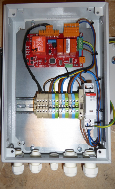

As you have two Sunamps, could it be that one is charging and the other isn't?
There are a couple of known problems that can cause a Sunamp UniQ to stop charging.  First is that on the early models the over-temperature cut-out could be prone to tripping.  This is located behind the terminal cover at the base of the main unit, on one side.  The cover has a couple of socket screws holding it in place, and the reset for the cut out is at the end, a push button that should click when pressed in if it has popped (make sure the power is isolated when checking this, as there are potentially live terminals behind this cover).

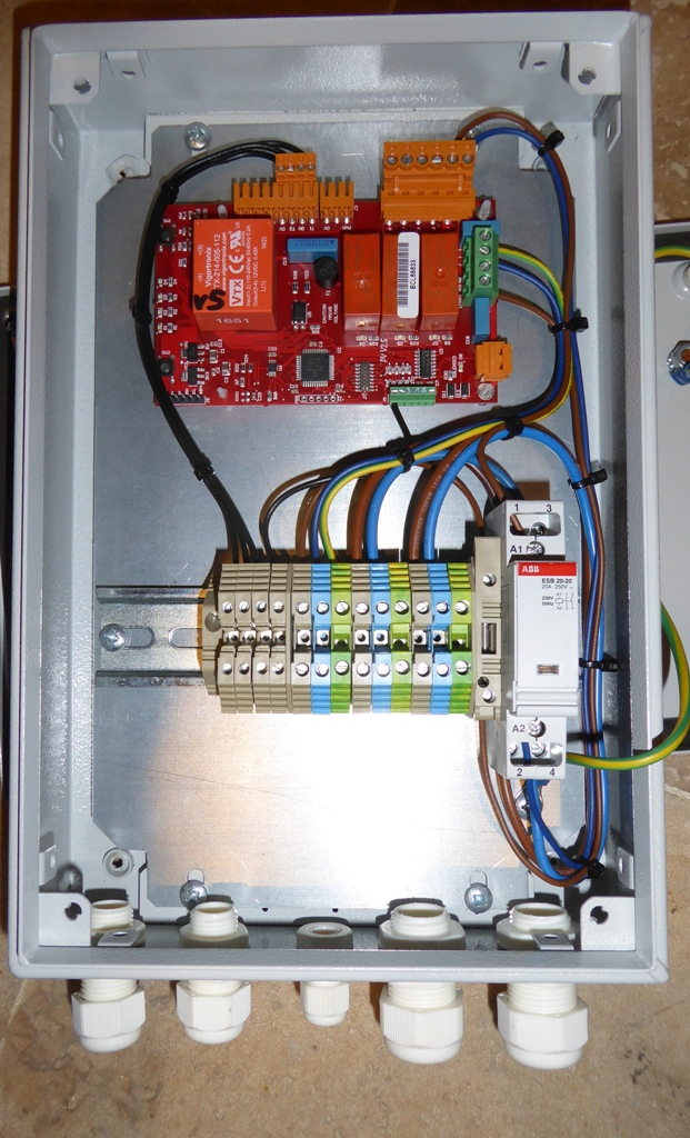

The other know problem is one that I had, which is that the contactor in the controller can fail.  The only way to check this is to remove the cover from the controller, and do the following (it's OK to remove the cover and power the unit on, as long as you take care not to touch anything inside).  First check to see if the controller is calling for heat.  There is an LED under a relay to the right that will be on if the unit is discharged and calling for heat (one of the status LEDs in the photo below, usually the middle one of the three):
If this LED is on, yet the Eddi is indicating that the Sunamp is charged, then that pretty much proves that power is not getting to the Sunamp heating element.  If the over-heat cut-out hasn't popped, then the next thing to check is to see if power is getting to the Sunamp controller heating circuit.  Set the Eddi to boost, and with a meter carefully check to see whether power is available at both the incoming and outgoing sides of the contactor.  The contactor will probably be a Finder one, and look a bit different to the ABB one in the photo below, but the connections should be the same (the Finder contactor in our controller failed, hence the ABB replacement):
Terminals 1 and 3 at the top of the contactor are the incoming mains power from the Eddi.  Terminals 2 and 4 at the bottom of the contactor are the power feed to the heating element in the Sunamp.  If the contactor is energised then there should also be mains voltage across terminals A1 and A2, as these are the contactor coil.
