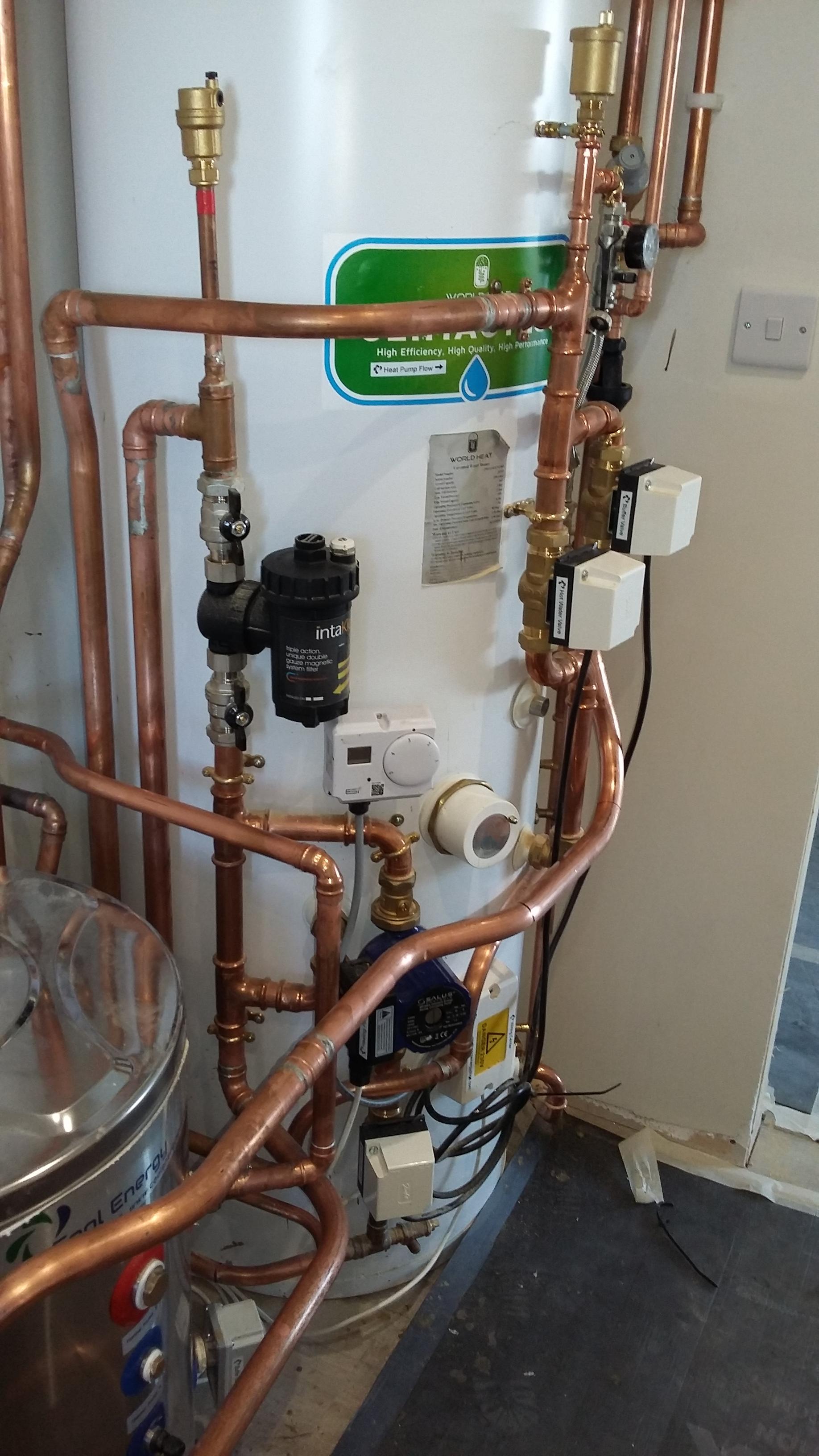

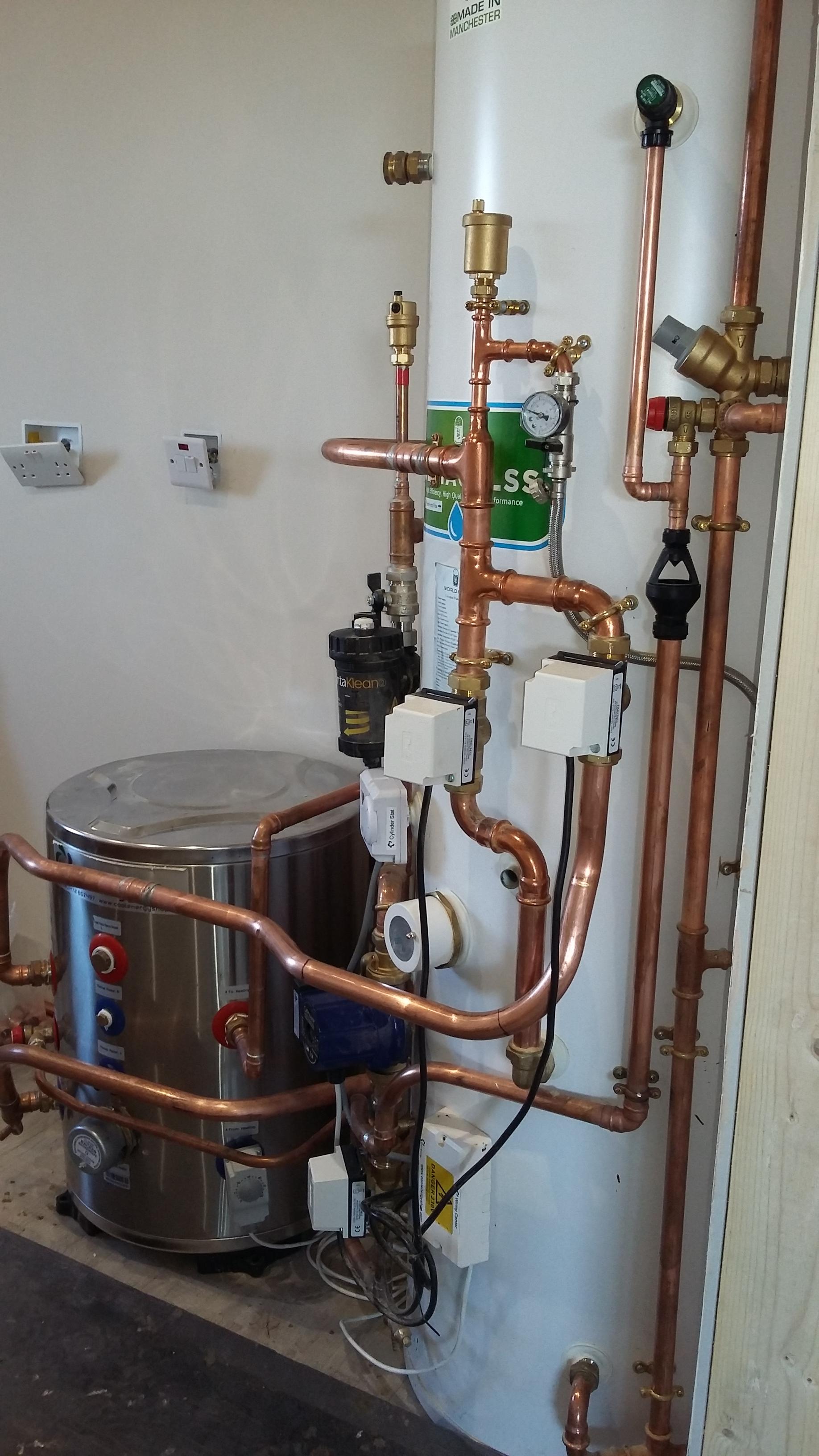

the pre plumbed tank and buffer tank

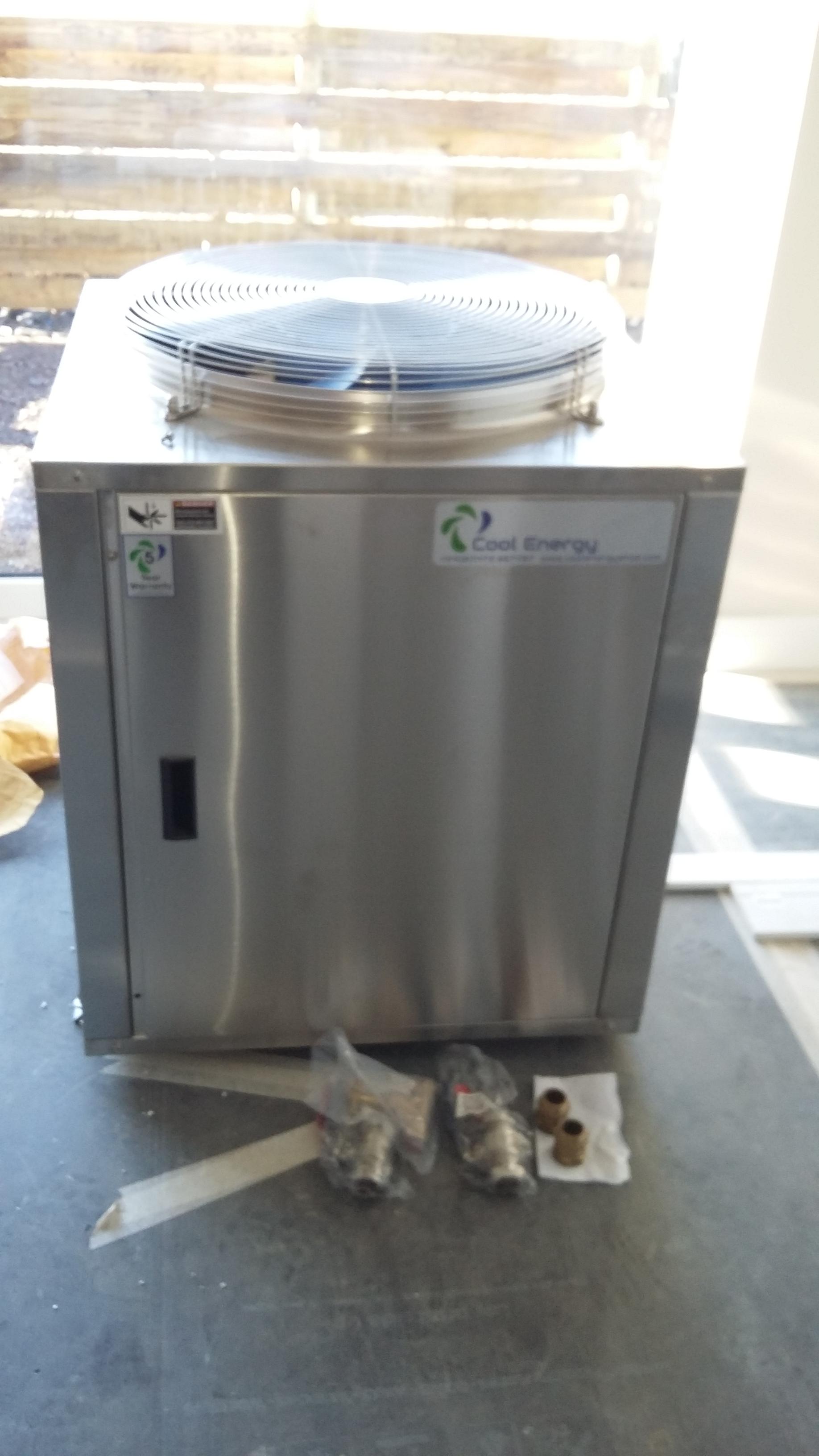

And the heat pump itself
I must admit, I was not expecting it to have the fan on the top.  That strikes me as a particularly odd design, as there is nothing to stop rain entering so it will be testing the IP rating of everything inside.

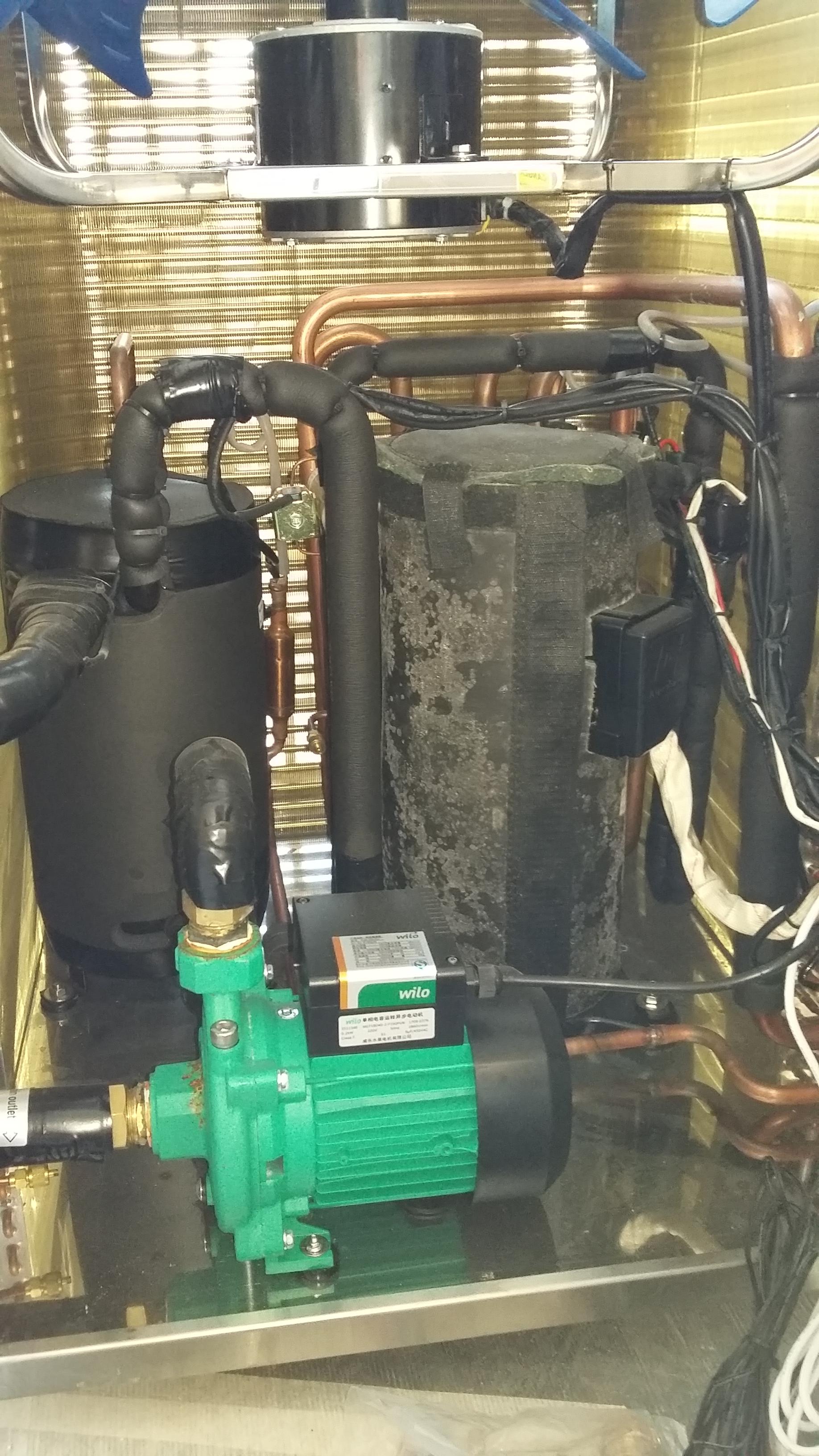

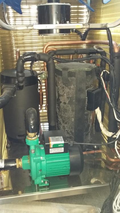

Here is what's inside
That's a particularly large circulating pump.  It will be interesting to see how noisy that is.  I do hope the plumbers will be using flexi hoses when they connect it.

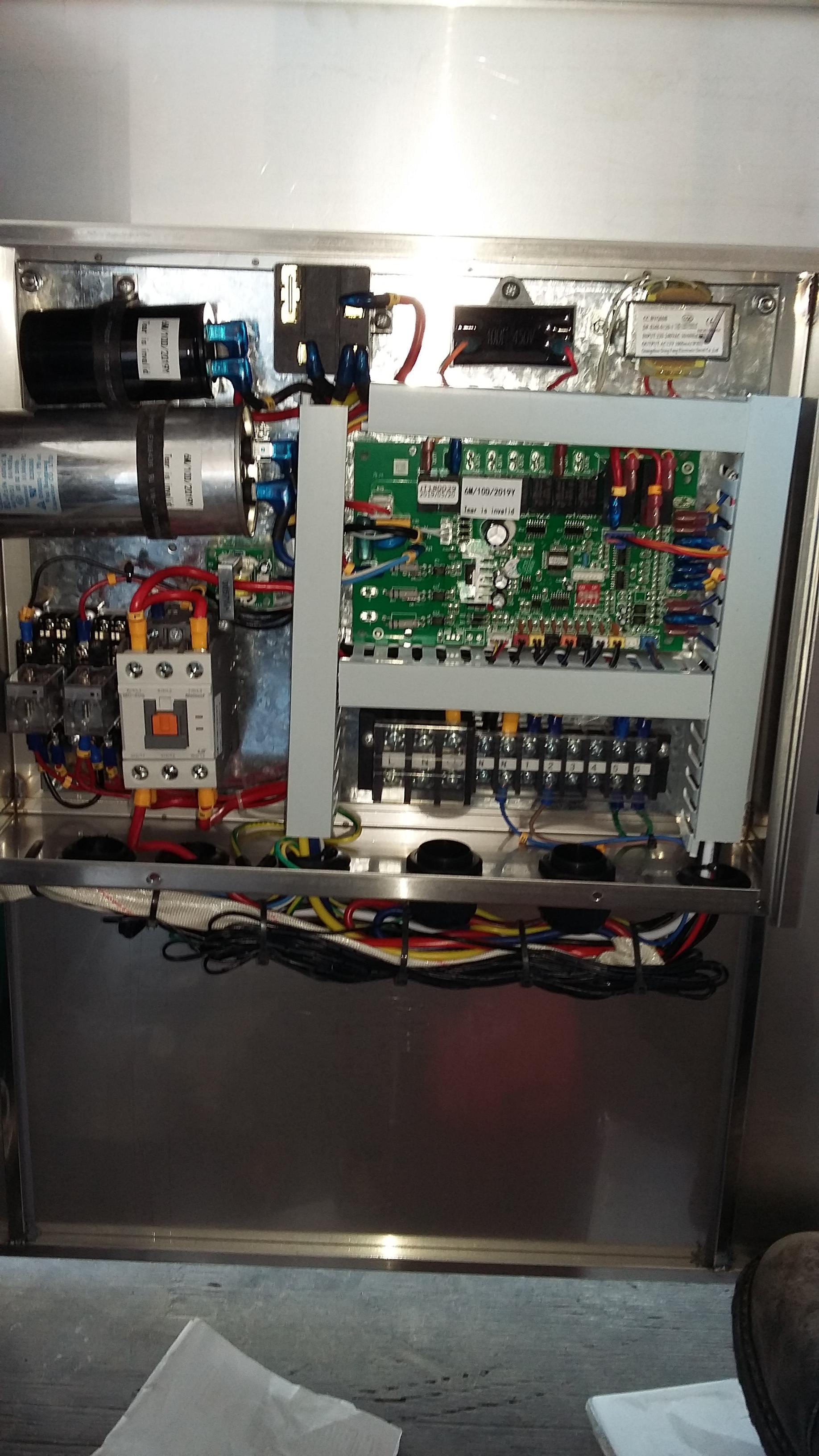

All the controls are inside a stainless steel box on the inside of the door
As we have discussed before, this version is not inverter driven.  It has a rated maximum current of 17A but they say to protect it with a C32 circuit breaker so they obviously expect a high start current.
The controls could not be simpler.  The HP just needs power and  a volt free call for heat demand already provisioned for in the pre wired wiring centre.  There are also pre made cables that have to be fed through, one for the programming unit, and one for a temperature probe that has to go in a pocket on the hot water tank.

Well I wired this today.  As expected no surprises.  The pre made cable to connect to the programmer is somewhat on the short side. By the time it has got to the house there was not much left to reach very far. The pre made cable for the temperature sensor had to be extended.
