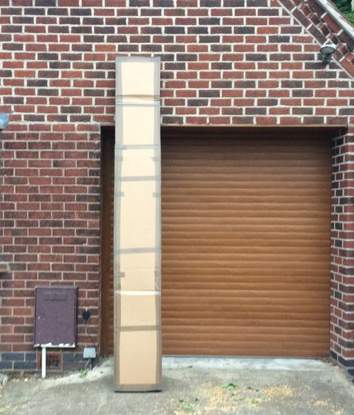

This is the box mine for cleaning solar panels arrived in (plugs into a hose), which is not the biggest. There are 3 sections this long. That is 8m plus 2m of me.
It is an interesting point that indeed also any PV might need an occasional good clean..
