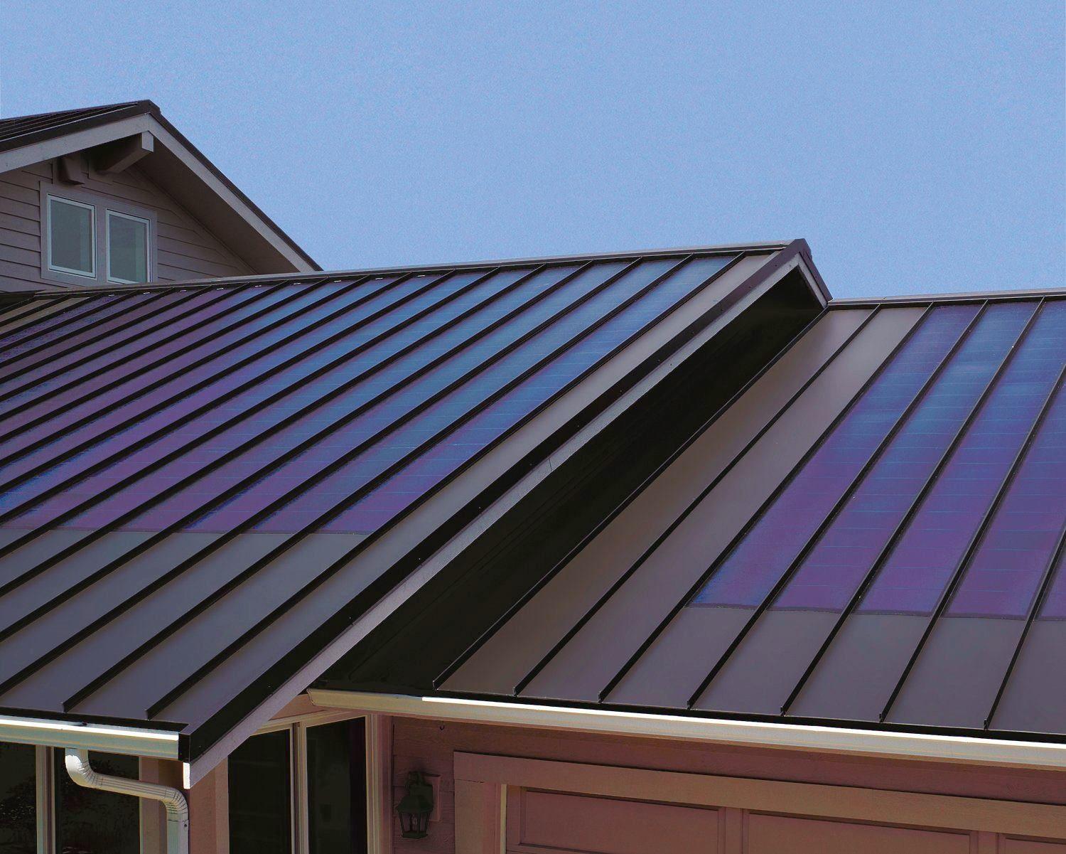

Jeremy Harris Posted February 19, 2020 Share Posted February 19, 2020 We were going to use them originally, and our planning consent included dark grey standing seam roofing with very similar flexible panels to those you've shown. A fair bit lower in efficiency, but they seemed a bit easier to install. The only tricky bit seemed to be getting the cables to run neatly. My plan was to run the cables from the top, along the ventilated ridge. We had to change our plans and get our planning consent amended, as the company that were selling the flexible panels disappeared, and we couldn't find an alternative at the time. Here's the photo that I included in our D&A Statement, showing the roof detail: Link to comment Share on other sites More sharing options...

Jeremy Harris Posted February 19, 2020 Share Posted February 19, 2020 10 minutes ago, gc100 said: Ah interesting. All I'm finding at the moment are panels like this: https://midsummerenergy.co.uk/pdfs/flex-03n-datasheet.pdf which seem very orientated towards caravans etc. Specifically the wiring connections. Did you find something a little more 'commercial'? Thanks as always The panels we were planning to use initially were made by a company called Unisolar: http://uni-solar.com/ Their UK distributor seemed to just disappear overnight, some time in 2013. I've had a quick look around and can't seem to find them for sale here though. Link to comment Share on other sites More sharing options...
