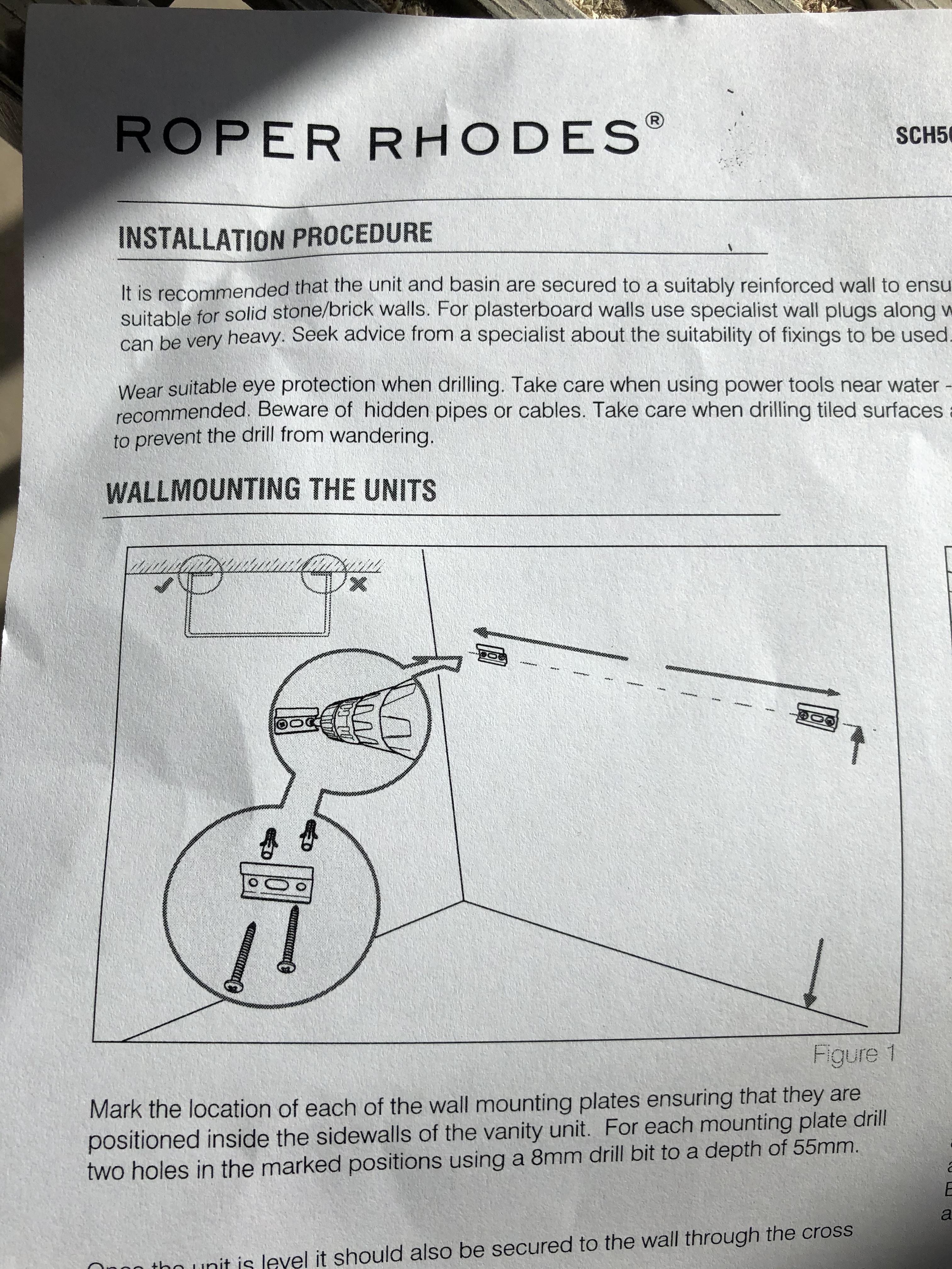

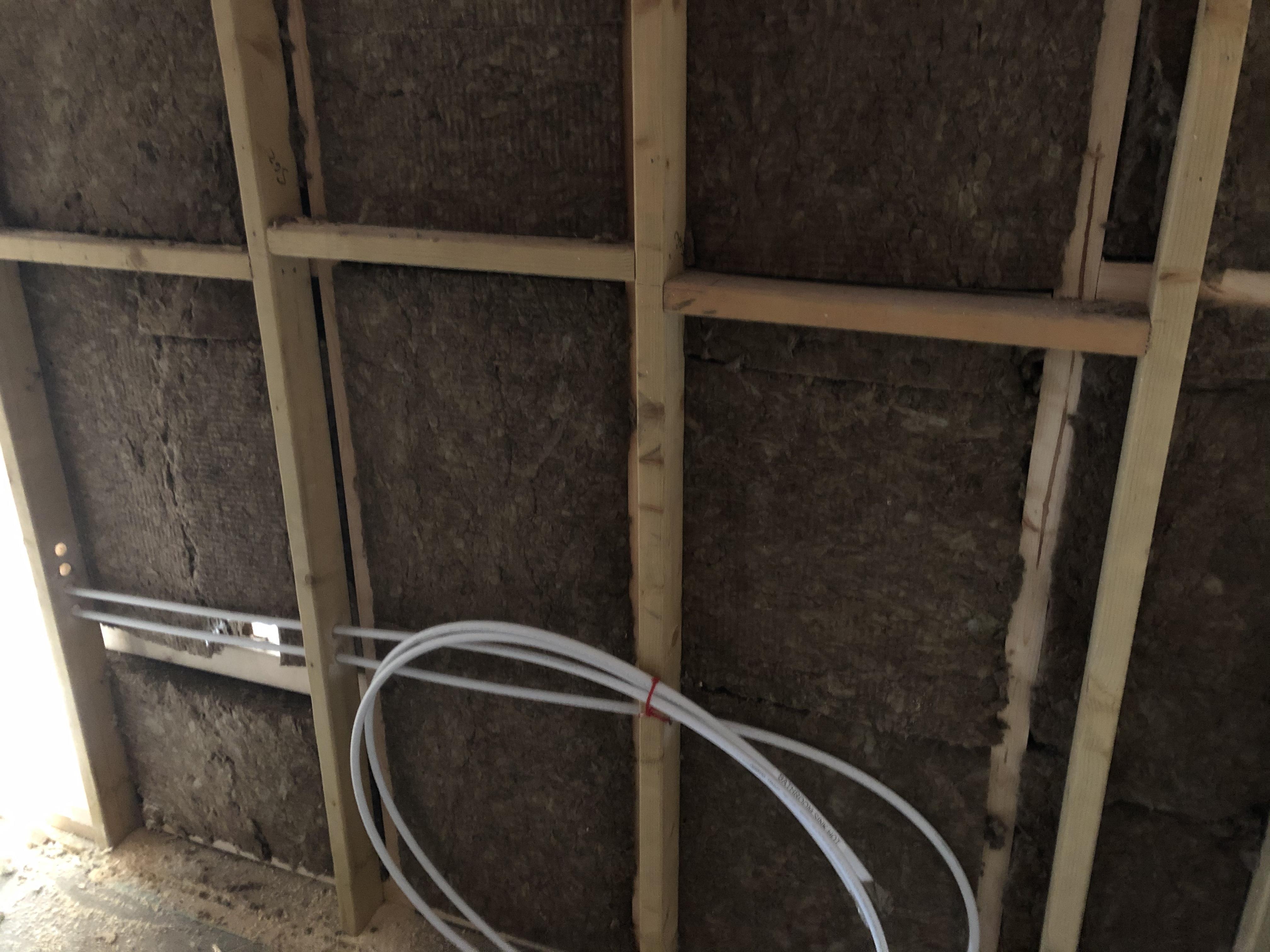

Pocster Posted February 17, 2020 Share Posted February 17, 2020 This is what I have. https://www.roperrhodes.co.uk/u/products/downloads/System-WM-500-600-800-1200-Instructions_V2_190503_110347.pdf Unit with sink will be heavy - surprisingly I.e worryingly it hangs on some simple brackets ( guess I was expecting some sort of metal floor fixed frame ) Apart from adding more stud and noggins - anything else I should do to make this a rock solid fixing ? Assume I still tile the wall fully before fitting . Walls were currently just due tile backer board Link to comment Share on other sites More sharing options...
Pocster Posted February 17, 2020 Author Share Posted February 17, 2020 Could marine ply the whole wall before tile backer board ...?? Link to comment Share on other sites More sharing options...
Onoff Posted February 17, 2020 Share Posted February 17, 2020 (edited) My sink screws to the bfo 6x2 screwed in horizontal: Then the sink fixings (bought seperate from S'fix) that have a bolt thread one end and a woodscrew the other end into that 6x2: If I hadn't have had a pedestal I'd have overboarded with 1/2" marine ply rather than 1/2" mrpb. Edited February 17, 2020 by Onoff 1 Link to comment Share on other sites More sharing options...
Pocster Posted February 17, 2020 Author Share Posted February 17, 2020 (edited) 11 minutes ago, Onoff said: My sink screws to the bfo 6x2 screwed in horizontal: https://flic.kr/p/L9znPF Then the sink fixings (bought seperate from S'fix) that have a bolt thread one end and a woodscrew the other end into that 6x2: https://flic.kr/p/2dYUr53 If I hadn't have had a pedestal I'd have overboarded with 1/2" marine ply rather than 1/2" mrpb. I like what you’ve done there - a chunky timber straight across . How did you decide height for the sink ? Might do similar as you and marine ply ontop aswell . You used mrpb on the walls not a water resistant tile backer board ? Edited February 17, 2020 by pocster Link to comment Share on other sites More sharing options...
Onoff Posted February 17, 2020 Share Posted February 17, 2020 5 minutes ago, pocster said: I like what you’ve done there - a chunky timber straight across . How did you decide height for the sink ? Driven by where it sat on the pedestal. Then sat it on a stool roughly the right height just to get a feel. Aim was to have the fixing bolts dead centre along the 6x2. It really is solider than a solid thing. There's a bit here about it too: 1 Link to comment Share on other sites More sharing options...
Onoff Posted February 17, 2020 Share Posted February 17, 2020 Tbh you could go 8 or 9x2 even. Try and avoid your sink fixing screws hitting the screws that fix the noggin. I went a bit ott and let the 6x2 into the studs. I did you'll note add a cheeky 2" onto the 6x2 (on the right hand side) which was a bit short! Everthing screwed and D4 glued. 1 Link to comment Share on other sites More sharing options...
Pocster Posted February 17, 2020 Author Share Posted February 17, 2020 4 minutes ago, Onoff said: Tbh you could go 8 or 9x2 even. Try and avoid your sink fixing screws hitting the screws that fix the noggin. I went a bit ott and let the 6x2 into the studs. I did you'll note add a cheeky 2" onto the 6x2 (on the right hand side) which was a bit short! Everthing screwed and D4 glued. D4 ?? Link to comment Share on other sites More sharing options...
Onoff Posted February 17, 2020 Share Posted February 17, 2020 2 minutes ago, pocster said: D4 ?? Just a strong, waterproof wood glue https://www.toolstation.com/d4-wood-glue/p61864? 1 Link to comment Share on other sites More sharing options...
Pocster Posted February 17, 2020 Author Share Posted February 17, 2020 5 minutes ago, Onoff said: Just a strong, waterproof wood glue https://www.toolstation.com/d4-wood-glue/p61864? Ok ! Think I’ll glue and screw your horizontal support and also the marine ply . Link to comment Share on other sites More sharing options...

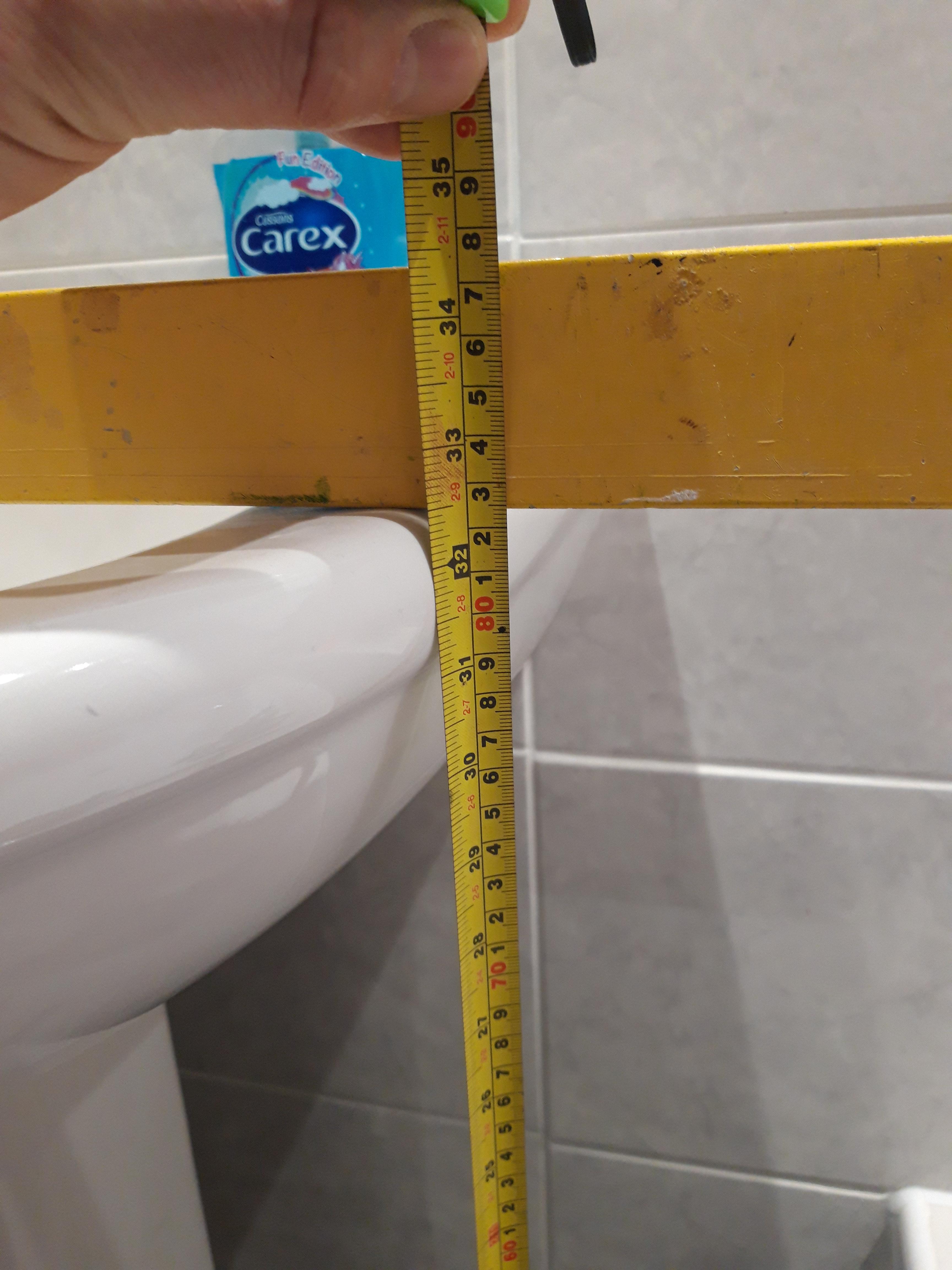

Onoff Posted February 17, 2020 Share Posted February 17, 2020 825mm here from finished floor to top of basin. Good for me and I'm 6'4" and a bit. 1 Link to comment Share on other sites More sharing options...
