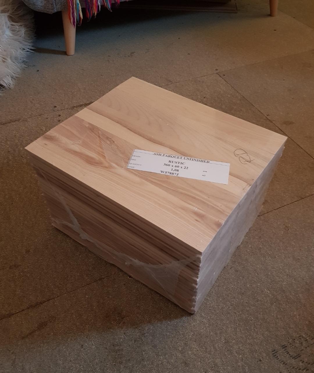

Robbie Posted January 4, 2020 Share Posted January 4, 2020 I'm getting ready to lay solid Ash parquet flooring which I've been keeping in an outbuilding up until now. Here is a link to the flooring we went for sized 22mm x 360mm x 60mm. I've been looking for advice on acclimatizing the wood online and have found several different methods suggested: Bring the boxes of flooring in to the room in which they will be laid. Leave for about two weeks in their packaging. Bring the flooring in to the room in which they will be laid. Remove from packaging and stack in small piles for two weeks. The flooring is currently plastic wrapped, with each package containing 50 lengths of parquet see image below. I had thought I'd remove them from the packaging and stack them maybe 20 high with gaps between each board. I think if left the flooring in the packs it wont be able to adjust moisture content due to the more or less airtight plastic wrapping. At the same time I'm a bit worried about the timbers cupping or bowing whilst acclimatizing if i remove them from the packaging and they acclimatize too fast. To make matters more interesting, I also have a wood burner as my only source of heating in the room which means the temperature will fluctuate a lot over the course of a day. If required I could add a small electric heater to keep the temperature more constant? Anyone have previous experience of this or any advice? Cheers, Robbie Link to comment Share on other sites More sharing options...
bassanclan Posted January 4, 2020 Share Posted January 4, 2020 Is there going to be central heating/ufh at some point? The last thing you want is to lay it and then turn the heating on and it shrinks. 1 Link to comment Share on other sites More sharing options...
Robbie Posted January 4, 2020 Author Share Posted January 4, 2020 We'll likely be adding a central heating system with wet radiators but that will be quite a long way off. No under floor heating. Link to comment Share on other sites More sharing options...
