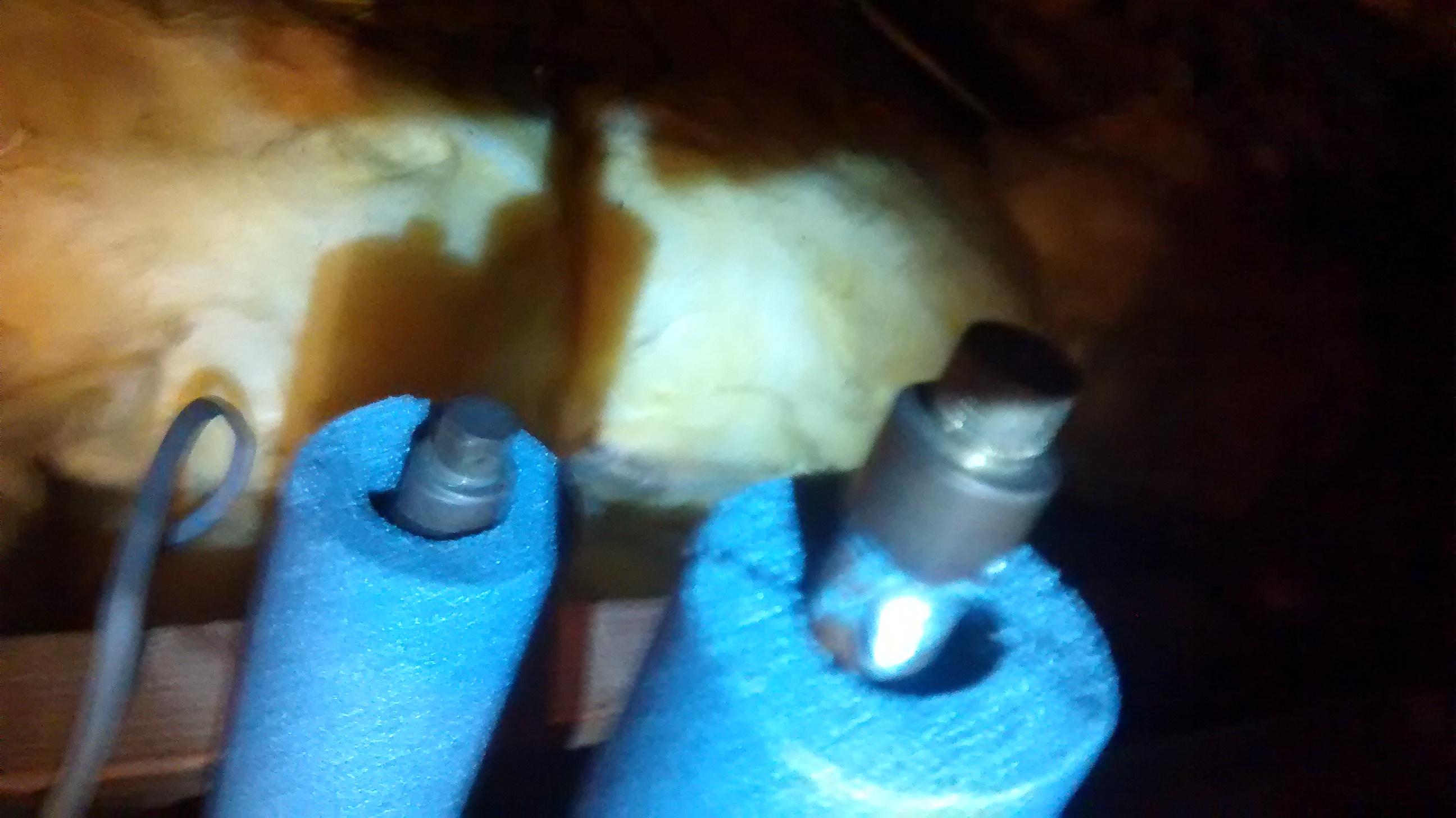

noddy Posted December 22, 2019 Share Posted December 22, 2019 Hi Chaps..are these central heating Bleed valves...I assume they unscrew? Link to comment Share on other sites More sharing options...
ProDave Posted December 22, 2019 Share Posted December 22, 2019 Yes just loosen the top part slightly. Link to comment Share on other sites More sharing options...
MikeSharp01 Posted December 22, 2019 Share Posted December 22, 2019 (edited) Yes but grip the lower section above the tube with mole grips so you don't twist the pipe / damage the joint if the screws are very tight. Edited December 22, 2019 by MikeSharp01 Link to comment Share on other sites More sharing options...
