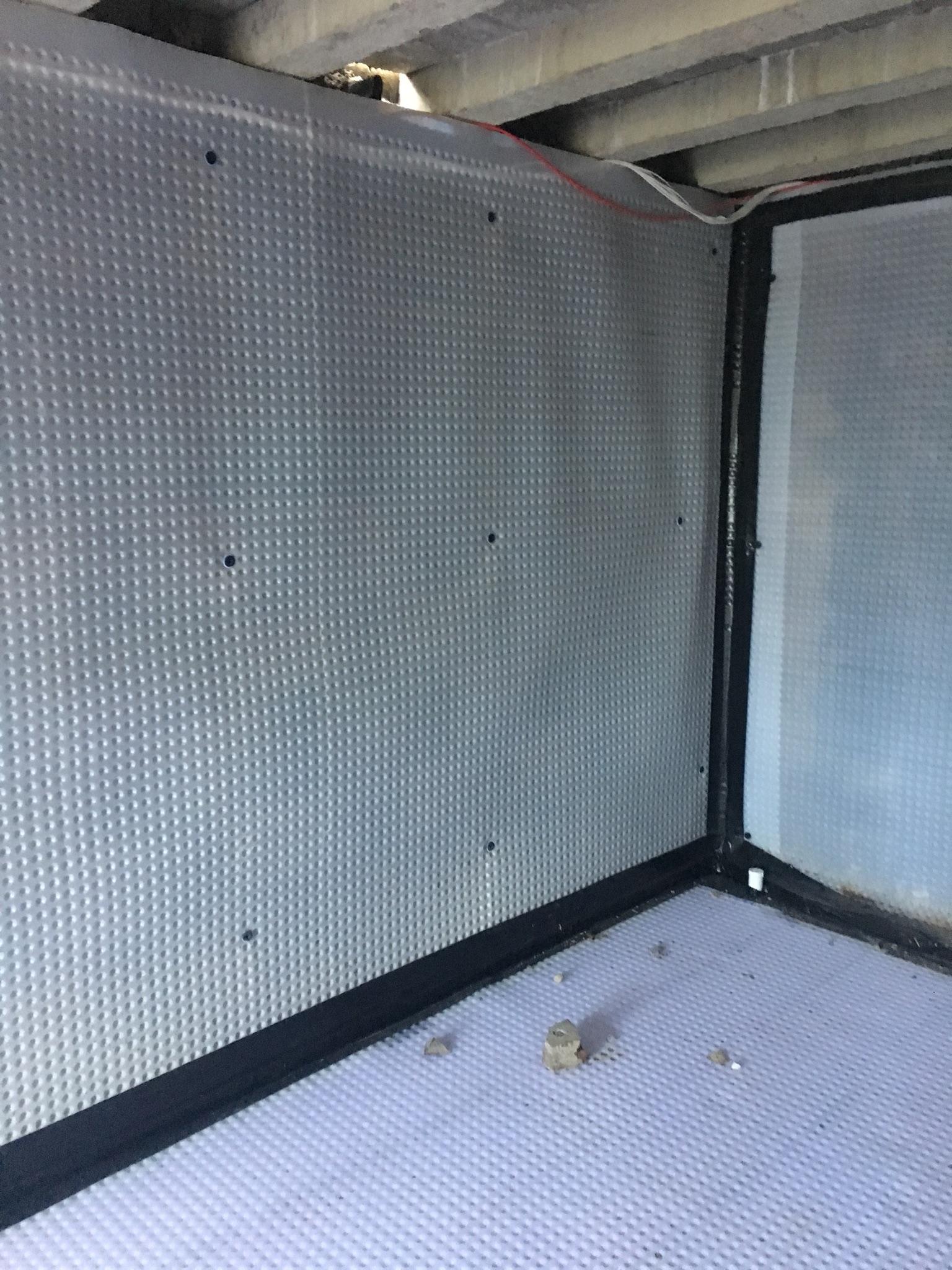

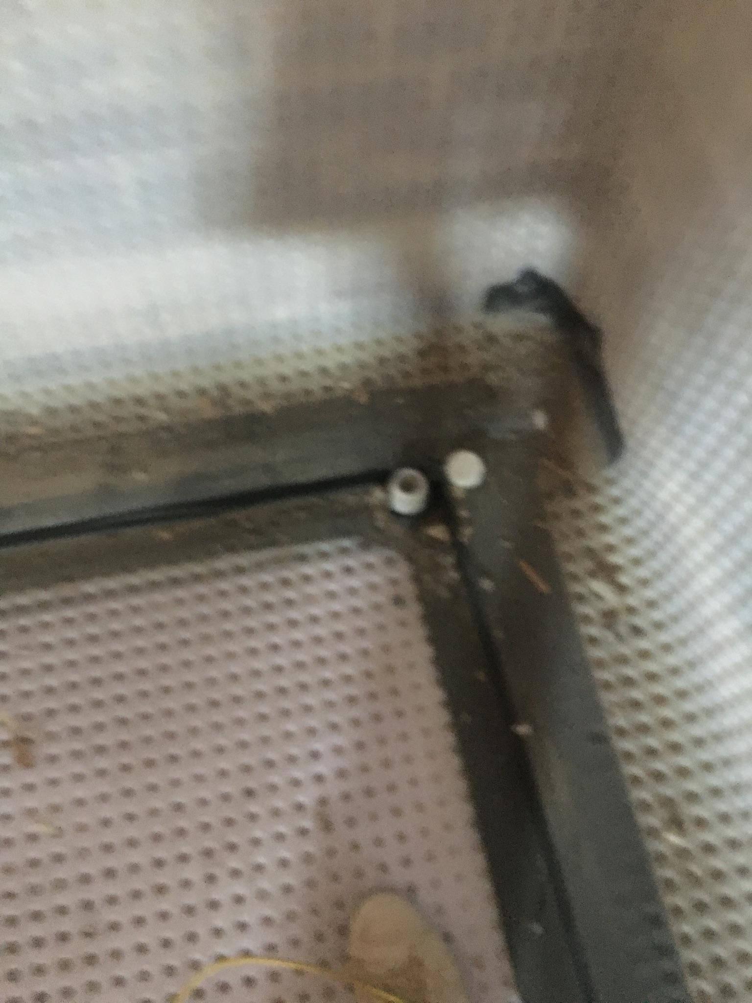

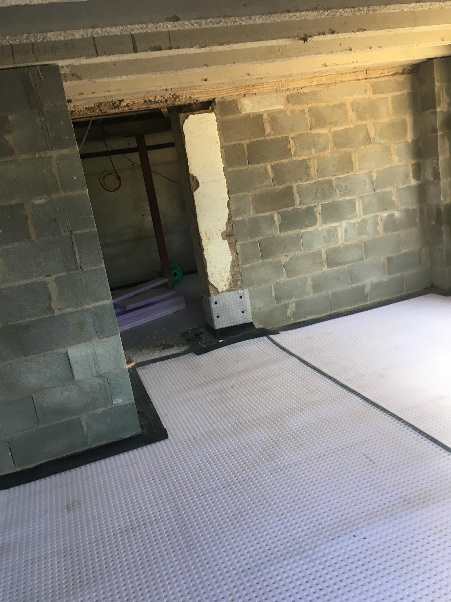

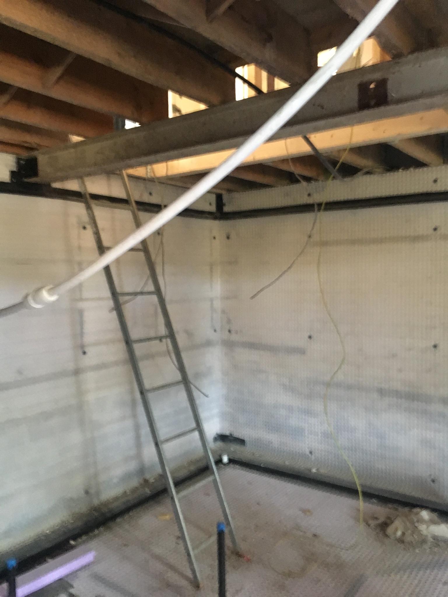

This is one o did at the beginning of summer I normally have a couple per year to do
Nowadays with YouTube to fall back on and massive improvement of materials Tanking a basement is not difficult Semiskilled at best
Though the companies that are doing it all the time would have you believe they are specialists
