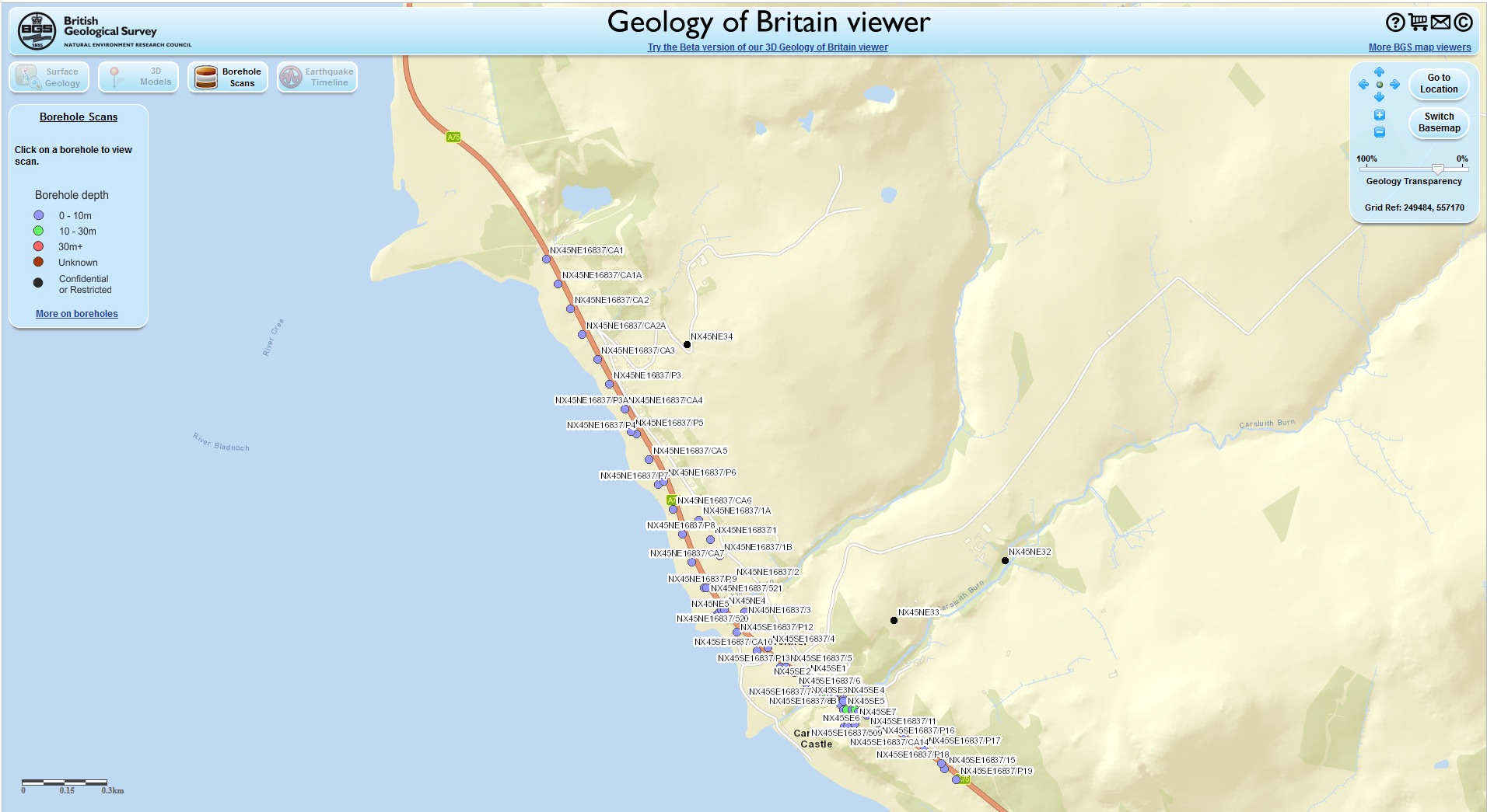

Jeremy Harris Posted March 27, 2020 Posted March 27, 2020 3 minutes ago, SteamyTea said: @Jeremy Harris Is the high number of shallow wells/boreholes (0 - 10m) what farmers use for irrigation, rather than for filling toughs? No, I'm pretty sure they will all be ground investigation holes from when they upgraded that section of the A75 some years ago. It's quite common to see rows of boreholes along main roads that have been improved over the past 30 to 40 years.
scottishjohn Posted March 27, 2020 Posted March 27, 2020 6 hours ago, Jeremy Harris said: The BGS website is the most reliable way to find wells/boreholes: http://mapapps.bgs.ac.uk/geologyofbritain/home.html Select the "Borehole Scans" option in the top left and then zoom right in on the map and any that are recorded will show as dots. Clicking on them will give whatever data the BGS holds. all the ones shown above were done when a75 was realigned and none of the actual water bore holes I know are there are not shown .other than one which I know is a wter bore hole
Jeremy Harris Posted March 27, 2020 Posted March 27, 2020 4 minutes ago, scottishjohn said: all the ones shown above were done when a75 was realigned and none of the actual water bore holes I know are there are not shown .other than one which I know is a wter bore hole Not all of them are associated with the A75. There are water boreholes at the smokehouse, and a couple near Carsluith, plus a handful up in Creetown.

SteamyTea Posted March 27, 2020 Posted March 27, 2020 4 minutes ago, Jeremy Harris said: , I'm pretty sure they will all be ground investigation holes Right. Shall relook at my area and see how they line up with the roads.

Jeremy Harris Posted March 27, 2020 Posted March 27, 2020 1 minute ago, scottishjohn said: yes I know the smoke house one its 35m --talked to the man who owns it The geology looks similar, so I'd guess there's a good chance that you'd hit water at about the same depth. No problem with any springs draining the aquifer in all probability, as it's almost certainly far deeper than the point where the springs flow from. Doesn't cost a lot for a hydrogeological survey, I think we paid ~£300. Might be well worth it if it comes up with a viable alternative.
scottishjohn Posted March 27, 2020 Posted March 27, 2020 Just now, Jeremy Harris said: The geology looks similar, so I'd guess there's a good chance that you'd hit water at about the same depth. No problem with any springs draining the aquifer in all probability, as it's almost certainly far deeper than the point where the springs flow from. Doesn't cost a lot for a hydrogeological survey, I think we paid ~£300. Might be well worth it if it comes up with a viable alternative. thought of that -- but no one will warranty results as it relies on you hitting a crack in the rocks --cos we know its solid granite and whinstone right to sea level no gravel or shale layers here smoke house hole is along way from the quarry --i,m not much over 10yards from the quarry wall where it is issuing from --admittedly at floor of quarry some 300ft+ below me
