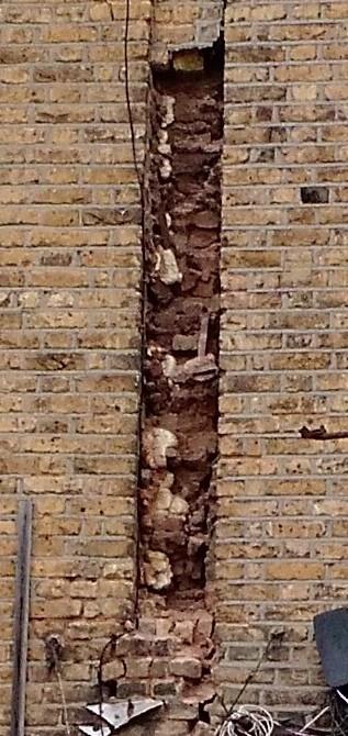

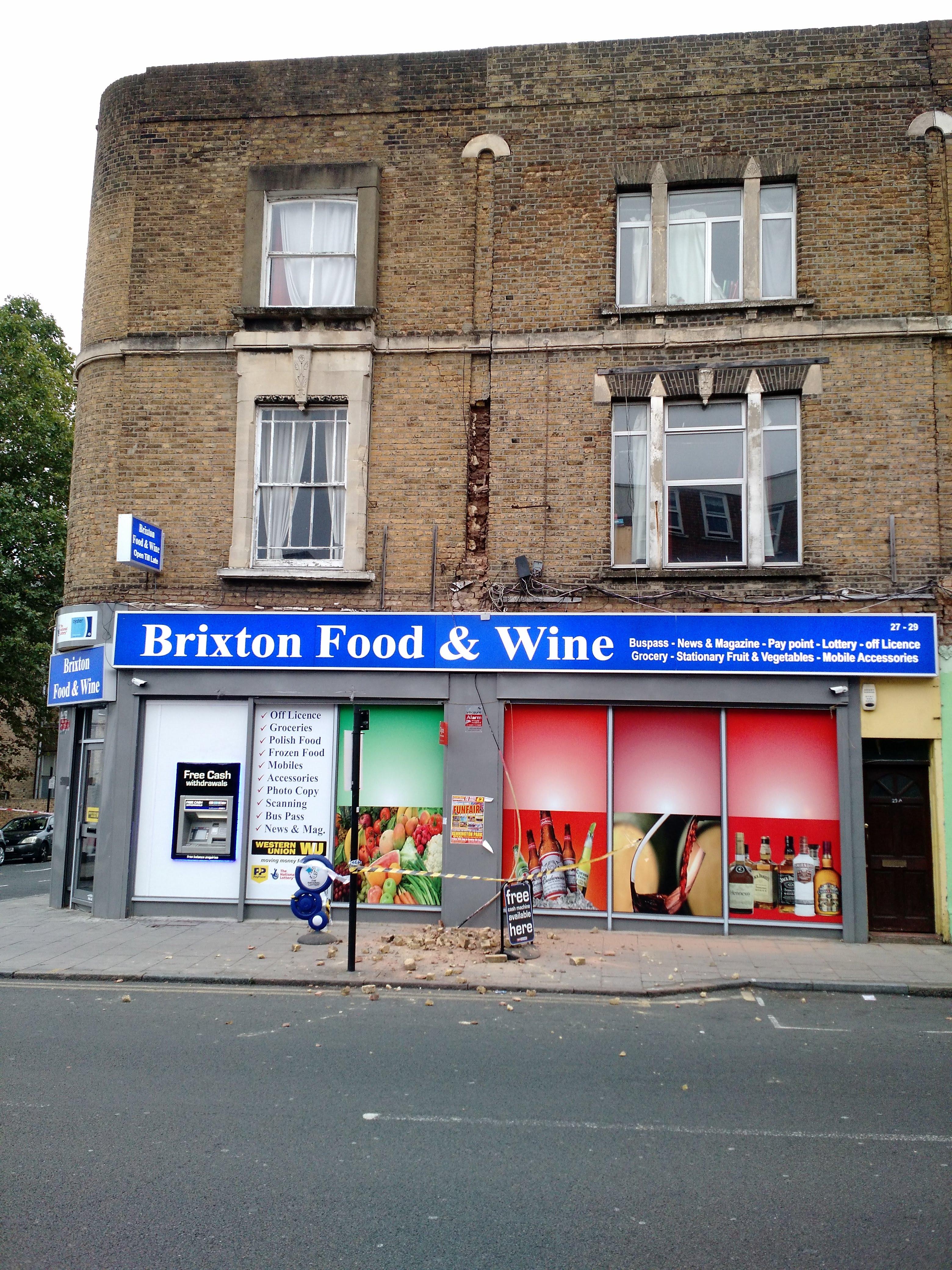

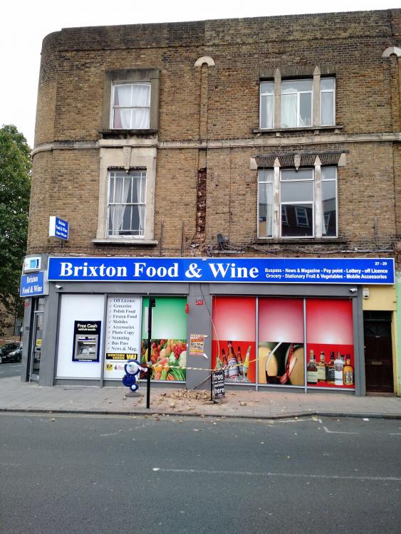

kxi Posted December 6, 2019 Share Posted December 6, 2019 (edited) I once saw 'mini' spray foam blowing out a brick wall into the street below. Given this is on a major bus route I suspect the mortar on these Victorian buildings was pretty much dust. Edited December 6, 2019 by kxi Zoomed image 1 Link to comment Share on other sites More sharing options...
